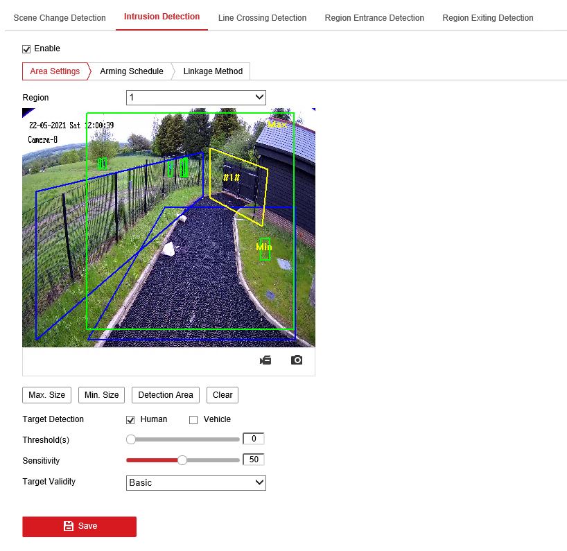

What I really want to get working is Intrusion Detection.
As far as I can this should be a matter of setting up the dectection zones, min and max target sizes, enabling it, ensuring scheduling is set and linking it to send emails.
I turned on "Rules" so I can see what it is doing in the live view and it appears to detect targets - boxes going red etc.

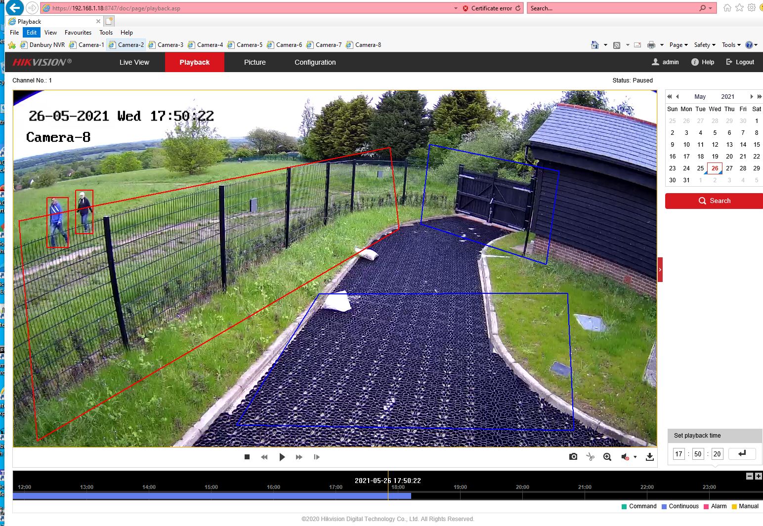

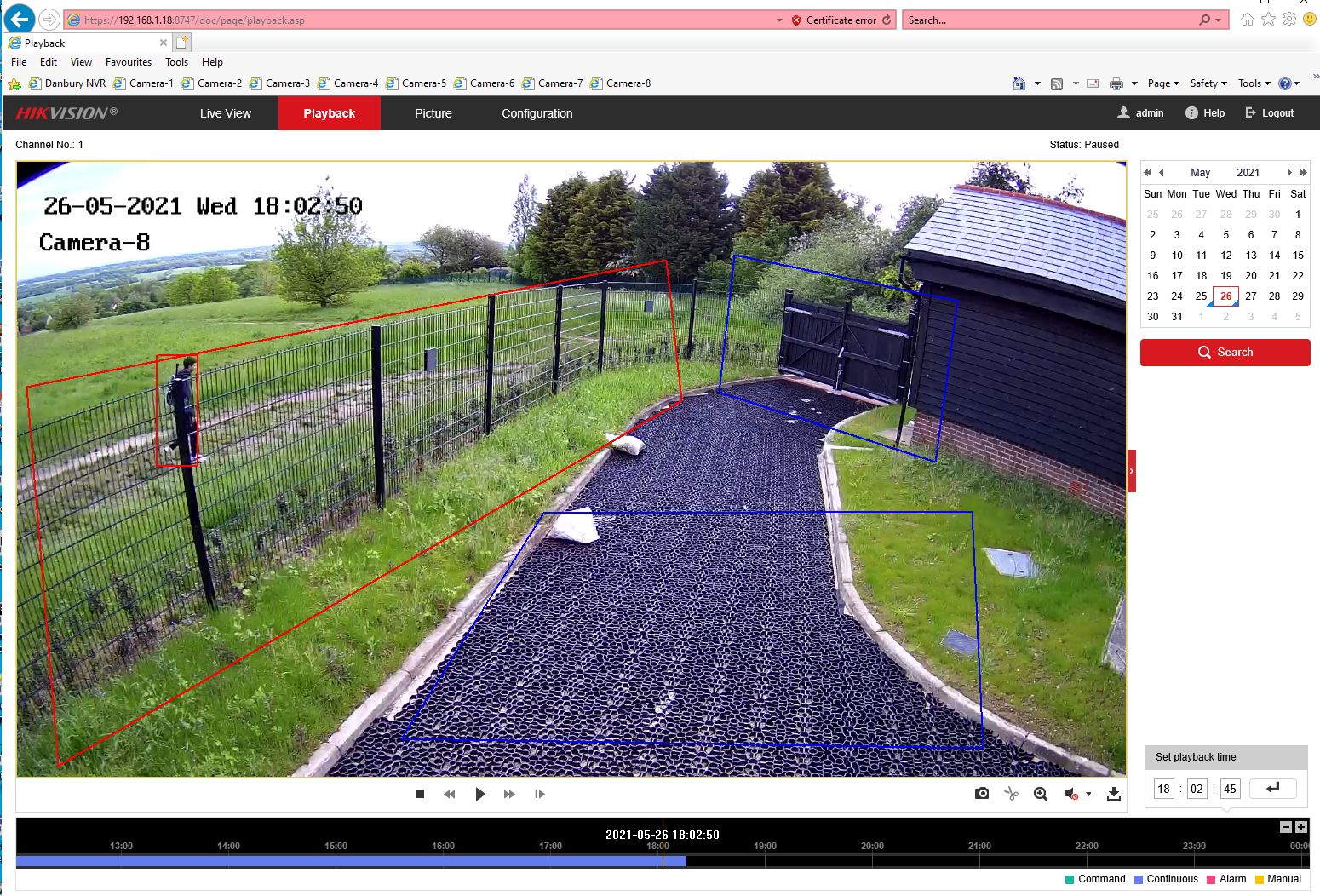

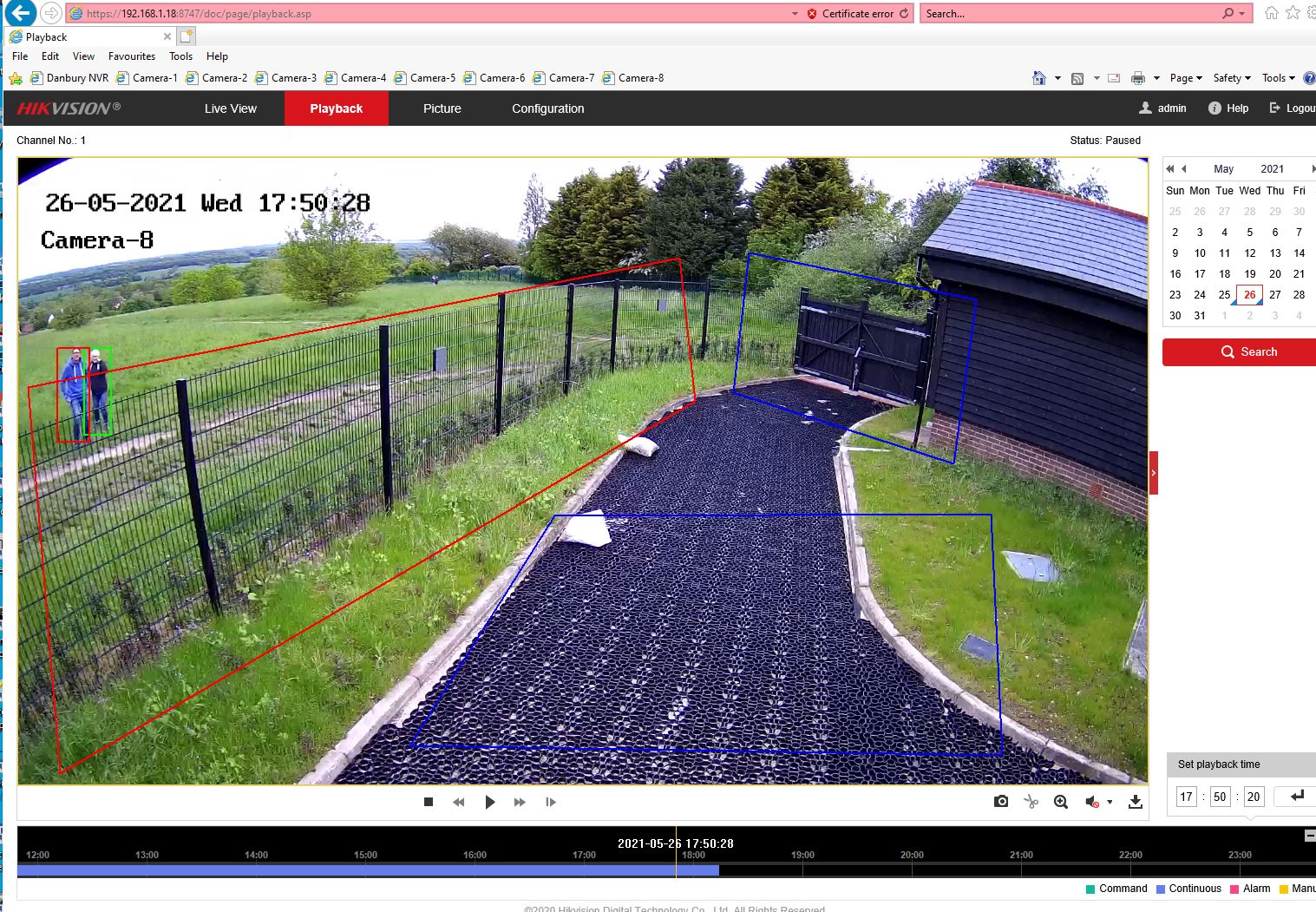

After doing some "walk-testing" and leaving it runnig for a while with "excessive" intrusion detection zones set up - after I actualy WANT it to trigger a lot just to make it do something - I eagerly kept an eye on one of two email accounts used to receive notification emails from the main Foscam system. This makes it a lot easier to seperate CCTV emails from others.
Time passed and.... Nothing. No Emails.

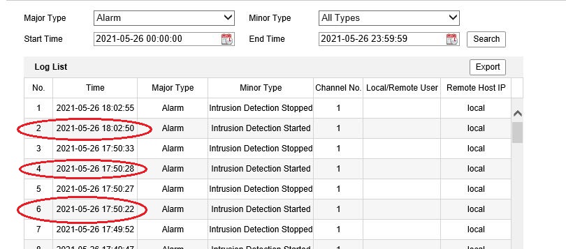

First thing that was obvious when I logged back in was plenty of log entries! YEAH!
Now this is where the decision to turn on 24/7 scheduled recording to the microSD card paid dividends. I could now correlate everu Alarm event log entry with the recorded video using the log entry time. Even better, because I turned "Rules" on, all detection stuff was also on the images:
And the video which triggerd them:
So that categorically proved Intrusion Detection was working, and working very nicely. So there must be something else causing the abscense of notification emails...

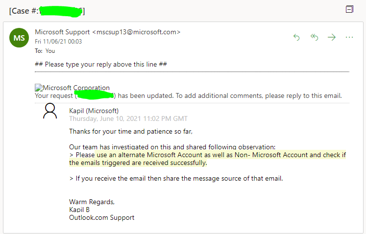

A fair amount of back-and fort with Oulook.com support. Supplying them with various screen snips of the camera's SMTP email settings, camera event logs (precise indicators for when emails should have been sent), test emails sent from the camera, and the "source" of the received emails (the View Source option Outlook.com webmail - shows all the internet headers) copied to Word documents and forwarded
This has been done for the Outlook.com mailbox I'm trying to send from, where only the test emails get sent and event notifications disappear into the black hole and out of existence. Oddly the ones from the 7 Foscam camera have always been ok being sent through the same mailbox.
Also did the same tests using a Gmail account I setup as a test. Unlike the Outlook.com one, Gmail (afer enabling "Allow less secure apps") had no issus at all sending test and even notification emails from the Hikvision. I think my "test" Gmail account is going to be used for some while LOL.
Anyway, the idea was Oulook.com frontline support would escalate this up the chain so that someone with the necessary back-end server access could check the server logs and find out what is happening to the event notifications, where these emails are going as they not being sent. They've had those for a few days now (since Wednesday) and I had reply late Thursday:
Hmmm... Try an "alternate Microsoft Account"? Did they mean setup another Outlook.com account, or any mailbox as long as it is a Microsoft one?
As I was pretty certain that using a different Outlook.com account isn't going to show much - although it might - I thought I'd throw them a curve ball! ;)

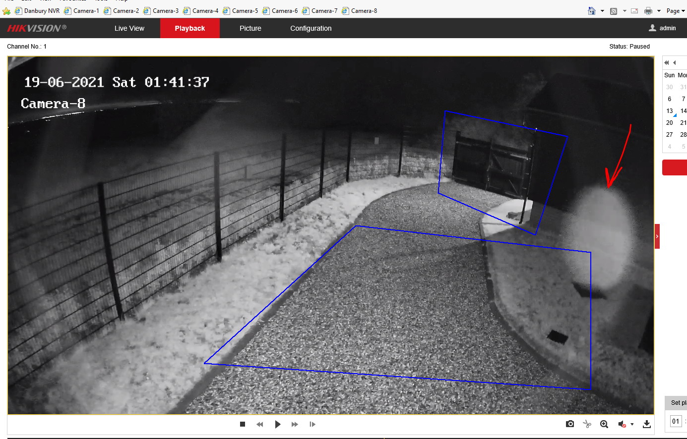

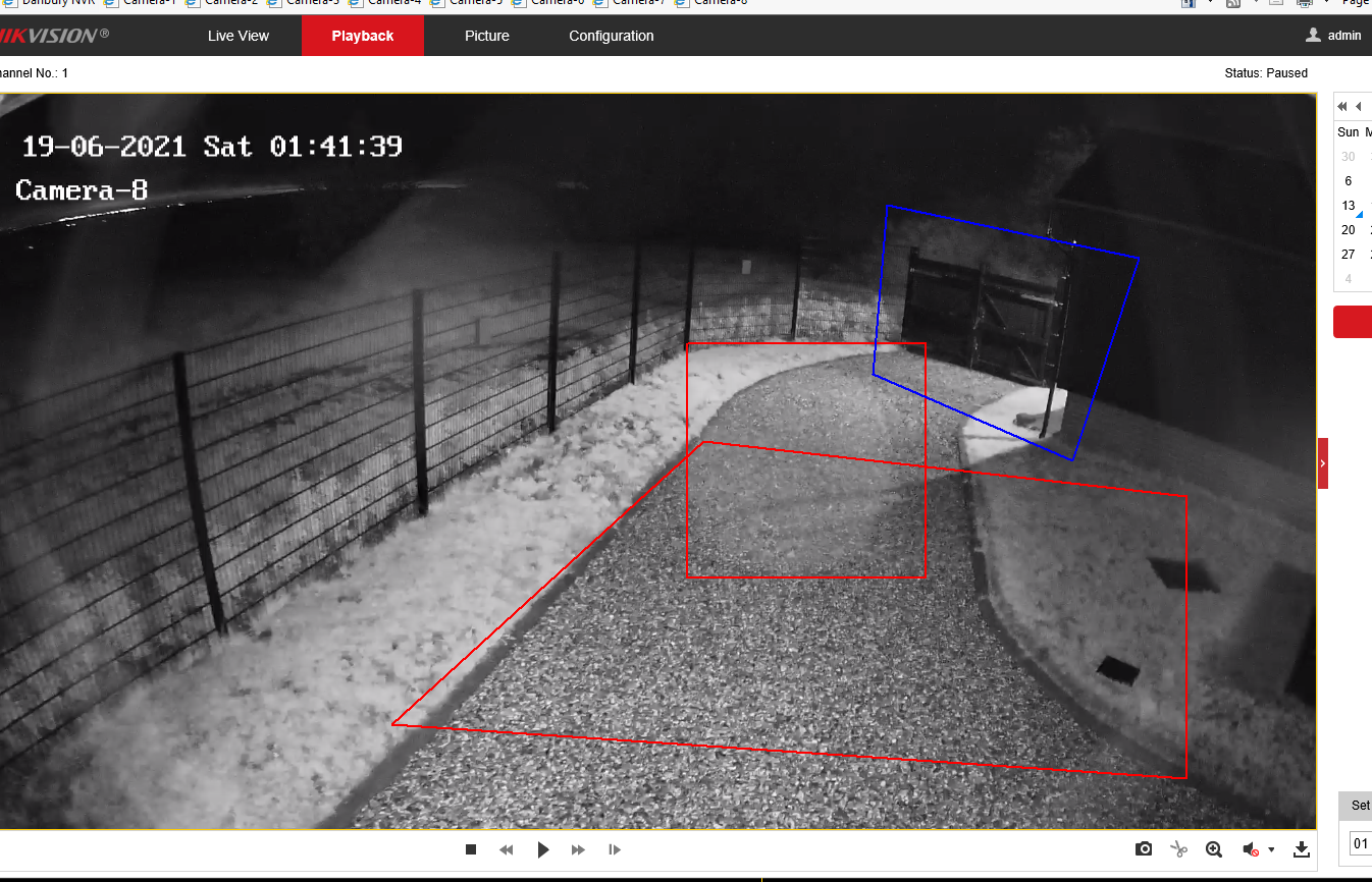

As a final snippet, how is this for "spooky"?
Any alternative suggestions as to what this may be, would be much appreciated:

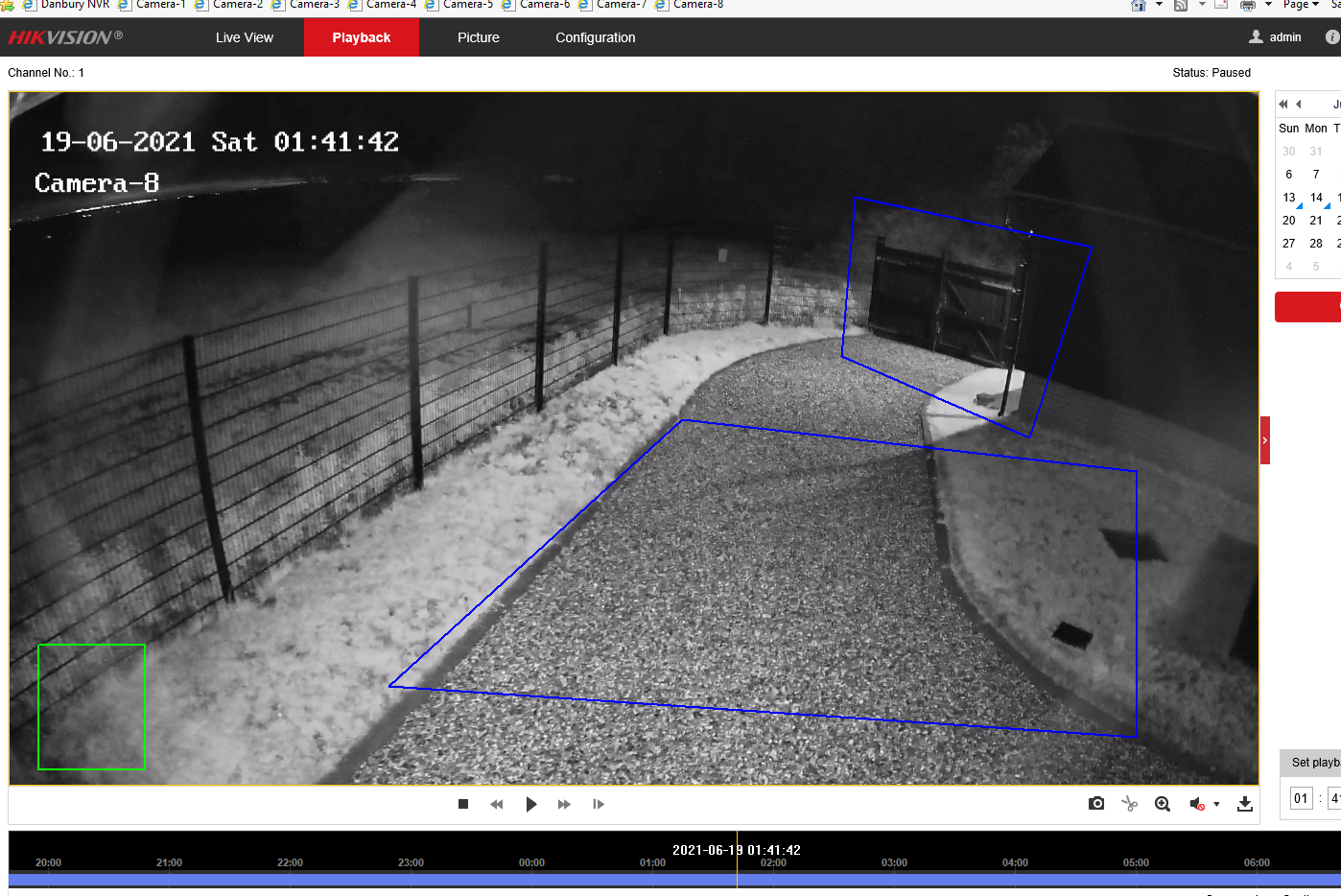

Originally picked up via Intrusion Detection early this morning. Almost no wind and only intermittent rain. The camera itself mounted in a reasonably sheltered position under the "significant" over hanging eaves (over 2 feet deep) of the building roof:
Attached are screen snips taken from the video recorded by the camera itself - as it has the "rules" visible.
What ever it is takes several seconds to (relatively) slowly go from right to left, near horizontally.
Where's that Yvette Fielding and "Most Haunted" when you need them ;):) LOL

Those "floaters" in the images that trigger your rules are very common, I see them all of the time on two of my cameras. Not sure what they are - very small insect or something that's blown off a plant, a cobweb floating around the camera. There was a story in a North East paper recently where a grieving mother believed the "orbs" were the spirit of her recently lost son - absolutely tragic and somewhat despicable that the newspaper reported it and no one had the heart to tell her...
I think in our case it has to be something, at least partially, to do with that camera's specific location and orientation. There are 7 other cameras (Foscam) on the site - you can see the IR illumation from two of them around the gate area. Four have been there for over 3-4 years now and haven't seen that sort of effect. I'm definitely convinced that it is something natural - it is an outdoor site - rather than "supernaturnal" which just happens to show up on that camera due to position.
Off to the right, out of shot, are another three cameras, one of which is potentially well positioned to provide "back IR illumination" to what ever the "patch" is. No doubt increasing the effect.
It is interesting though and makes a change from the "squabbling pigeons", "patrolling local cats", and deer. :)
Also beats the gazillion things which trigger the Foscams - anything from rain, flying bugs, spiders (AAGGGHHH!), just anything that can change a few pixels at night.

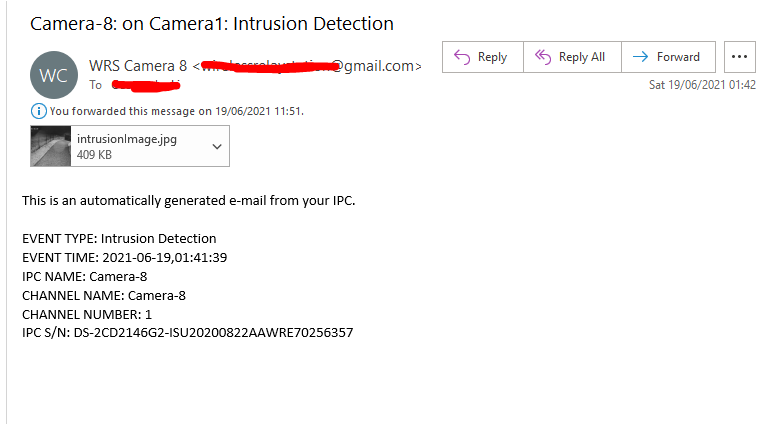

First thing to say is that I NOW HAVE IT WORKING! Albeit being sent from a different and newly created Outlook.com account to the existing one used by the Foscams. Hmmmm

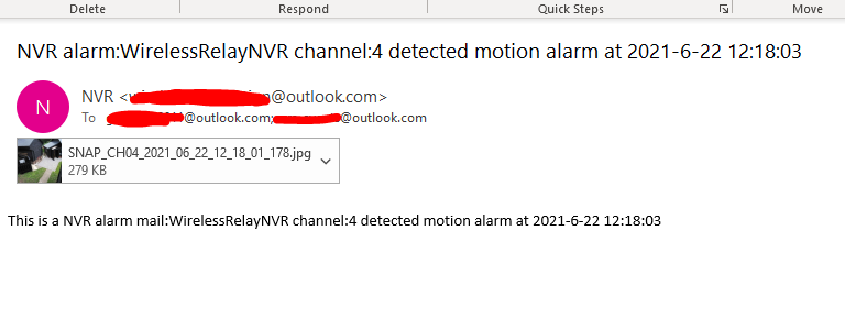

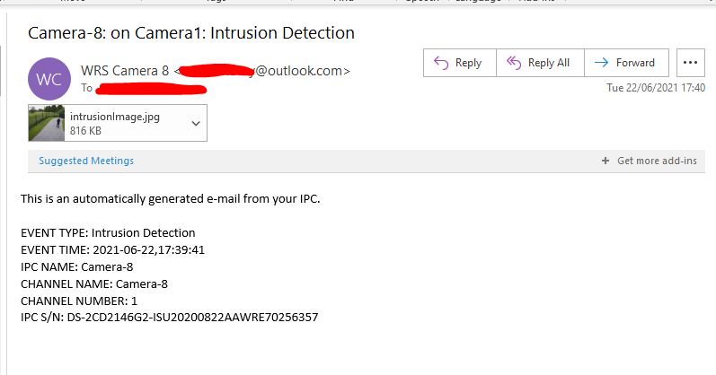

Clearly, something about the way the emails are formatted by the Foscams and the Hikvision are triggering some form of "spam suppression" with Outlook.com and blocking the Hikvision ones being sent.
Best guess is the "sender" details just seem too different to Outlook.com, causing it throw a "hissy fit".
This is how emails from the Foscams appear (certain details may be "redacted" for security reasons):
Where as ones sent from the Hikvision (currently) appear as:
I'm just wondering if changing the sender in the Hikvision SMTP settings to "NVR" may overcome the issue. I just get the feeling that the emails appearing as two different senders - one "NVR" the other "WRS Camera 8" it is causing the "newer" "WRS Camera 8" to be treated as a "spoofing/spamming" attempts and sent into the "black hole".

Fresh set of emails began with my new technical support contact began -this time in the UK - on the 26th October.
Now this is where things get interesting!
I received a phone call from my new contact, Daniel, on 28th October (last Thursday). This guy was the real deal with the in-depth technical knowledge and experience to match. FInally!!
A very interesting series of phone calls and emails during which Daniel was able to check and verify that two Outlook.com accounts that I'm using for sending camera event notification are the same in all the important areas which could be relevant. He was very puzzled why one account worked and the other one didn't.
Best of all, loads of feedback from him of what has been done, checked, etc.
Quick summary:
