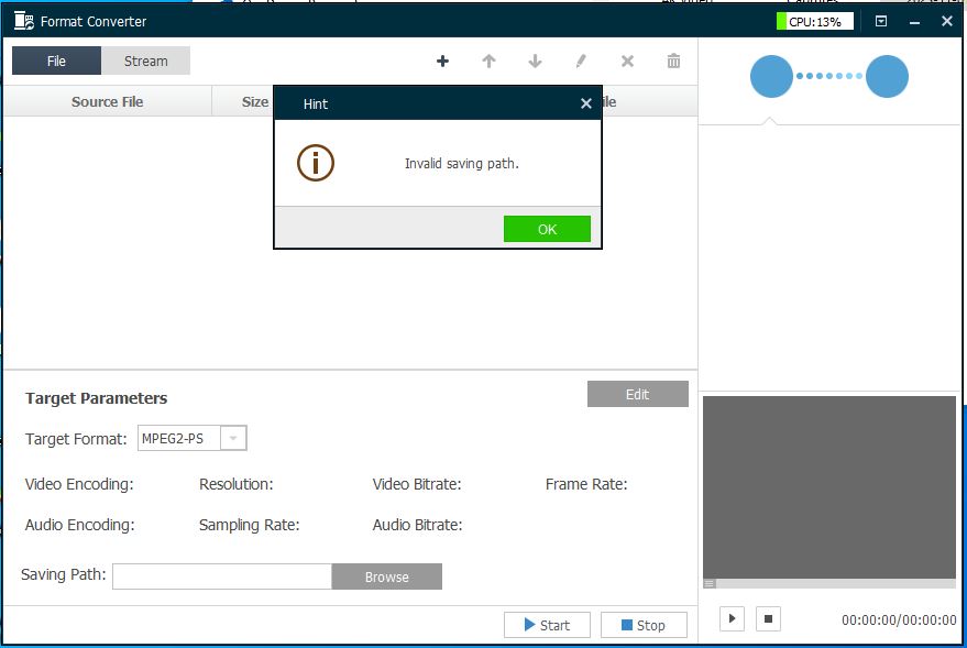

Every time I try it and try adding a "task" all I get is this:
The buttons don't work to set the saving path and if I try changing the default saving path it doesn't remember it and bombs with the same error.
I've found it.
For some reason I have to use "Run as Administrator" when launching VS Player otherwise the converter bombs with that error.
I've found it.
