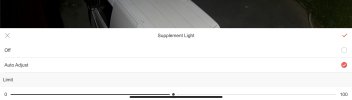

More likely a setting. It could be that there's enough light for the exposure time set - that would prevent it even if it's set to Auto. Try setting a shorter exposure time 1/50s or 1/100s. Also ensure the light is on in the camera itself (rather than through the app) You could prove the functionality of the light just by rebooting the camera, as when the camera powers up the supplement light comes on very briefly regardless of day/night etc. I've never known a failed LED on those cameras yet.

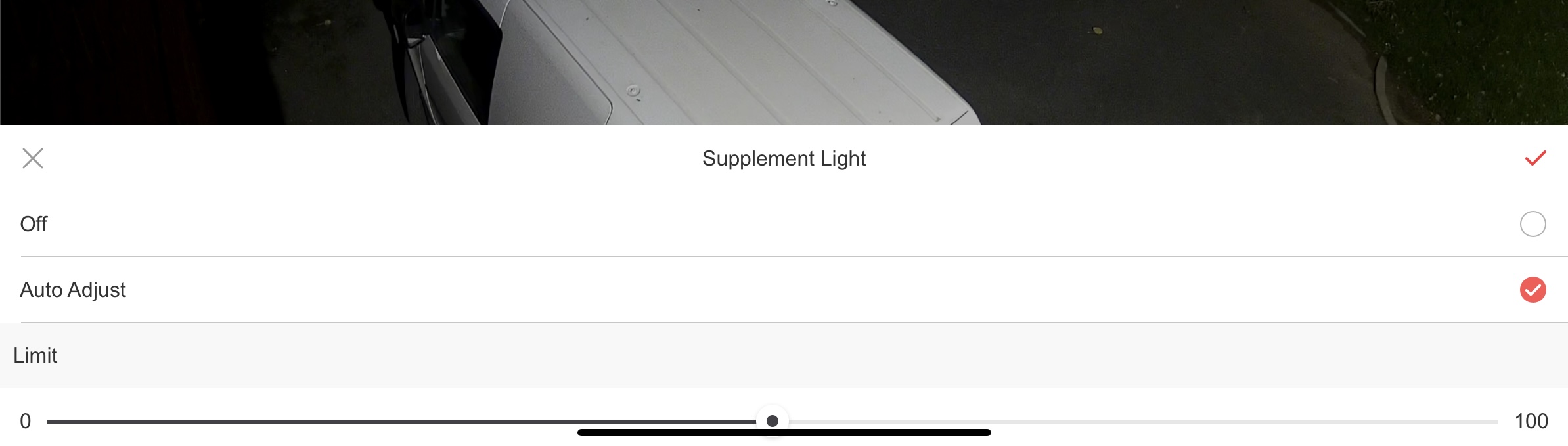

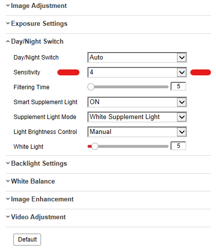

Did you experiment on Image - Day Night Switch - Sensitivity? Try 7 instead of default 4
Hello thank you for the reply.
No the only settings on the app I am aware of are the ‘supplement’ light settings I shared above. Can you elaborate a bit?

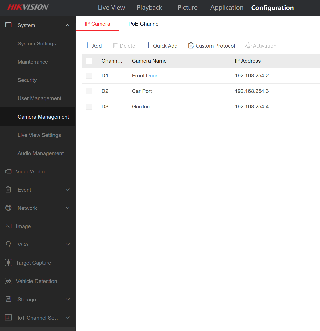

Hello. I am logging in on a pc from work via Hikconnect. I cannot find the settings?
Do I need to login on the local network to see them?

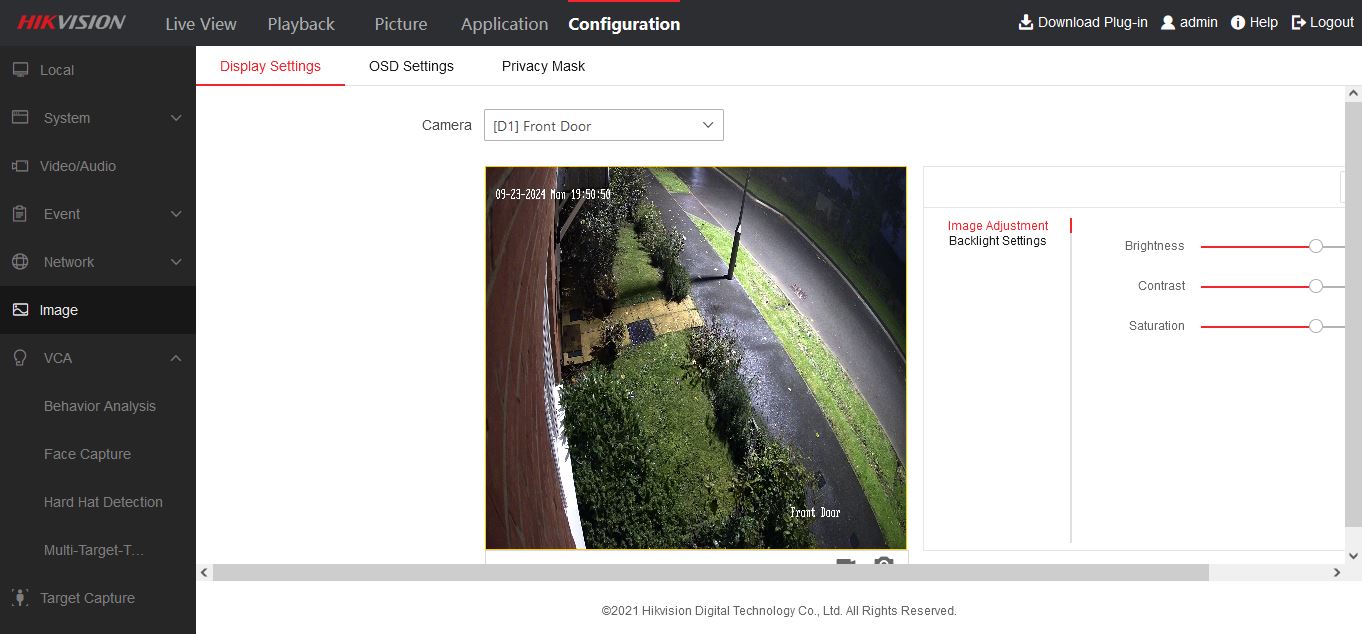

Go Image - Display Settings - your camera - Day Night Switch -Sensitivity.
But you can only experiment when dark ....
Thank you, I am logged in on the same network over wifi and am not seeing any of the settings. I am sure I used to.
You’re logged into the NVR, you need to be logged into the camera itself as there are additional settings there.
Thank you, I will need to work out how to do this as that I always have logged in this way.
Update. Logged in to the cameras no issue. Ill see how I get on.
