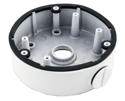

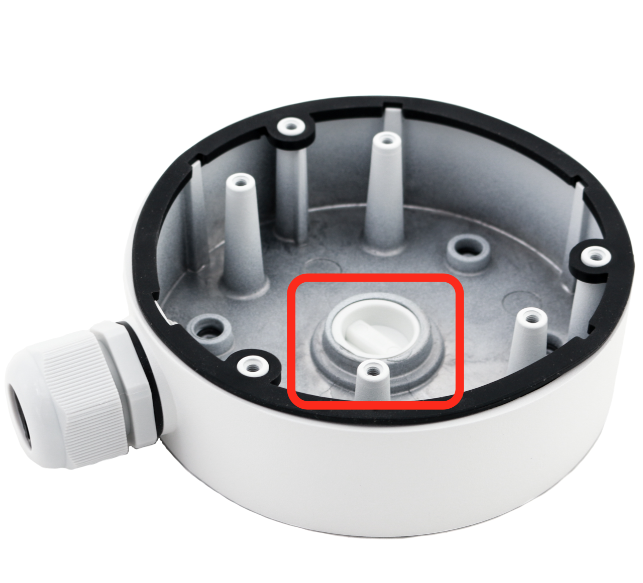

So, you will need to use a junction box rather than coiling your cat5 cable and connections in the base to protect them - hiding them in the base can lead to water damage / corrosion which Hikvision's warranty will not cover. The correct junction box for the camera is the DS-1280ZJ-DM21, as you can see in the product photos, the side-mounted gland can be removed and blanked off by the white plug that comes in the base if you need to use the rear entry:
Hi rather than starting a new thread regarding the DS-1280ZJ-DM21 my pigtails will also be going straight out the back of it and into the wall.
Is there something I can use to seal the hole with as it is exceptionally big and I'd imagine rain would get in as it will be mounted on a pebbledashed wall so not even tight against the wall.
A rubber grommet would be ideal I'd imagine if anyone can recommend a size or is there another way?
Hi @RoundSquare
The threaded holes in the junction boxes are usually 3/4 BSP sized, you should be able to find a rubber grommet or gasket to fit those threads.
