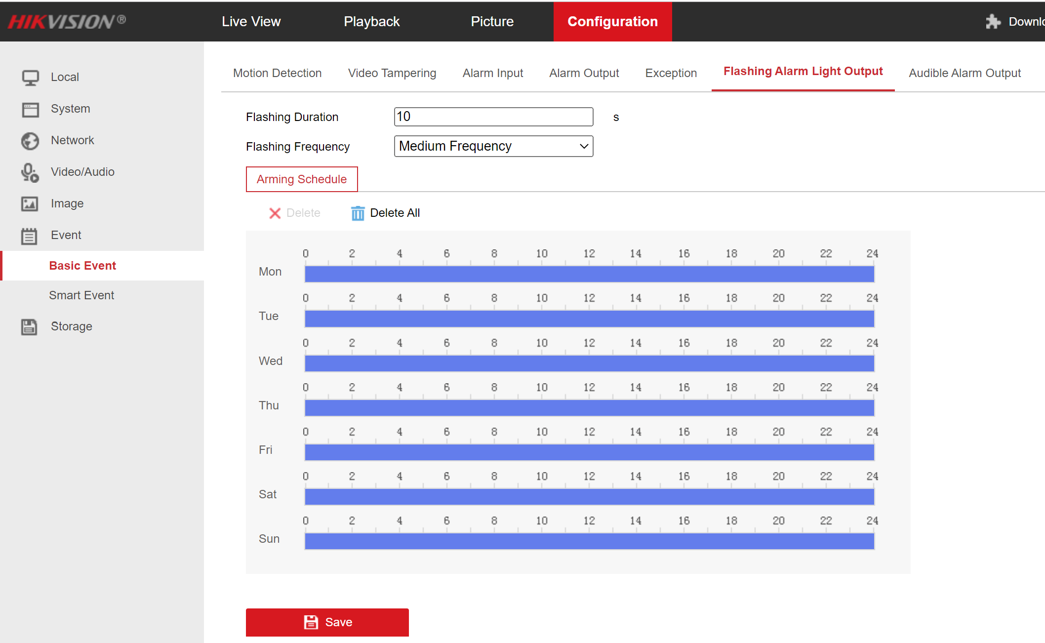

regards the attached picture, originally i had it to to alarm from 00:00-08:00 and then from 18:00-24:00.
i've changed it so it's 24/7 now and now the intrusion detection is working at night, haven't tested it properly, but now it alerted when i stepped onto the driveway.
