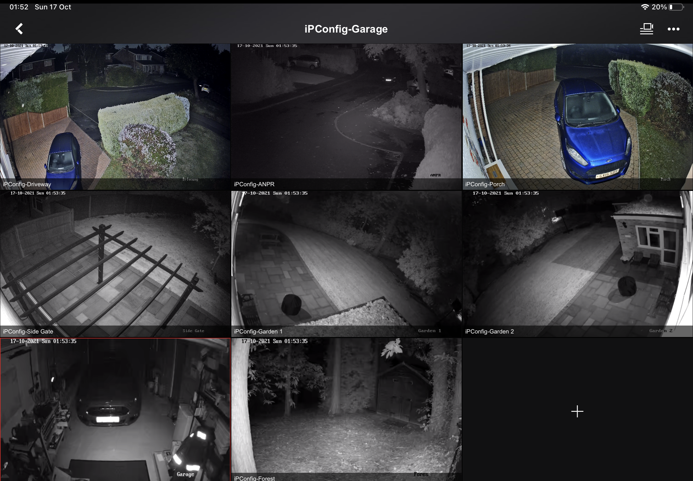

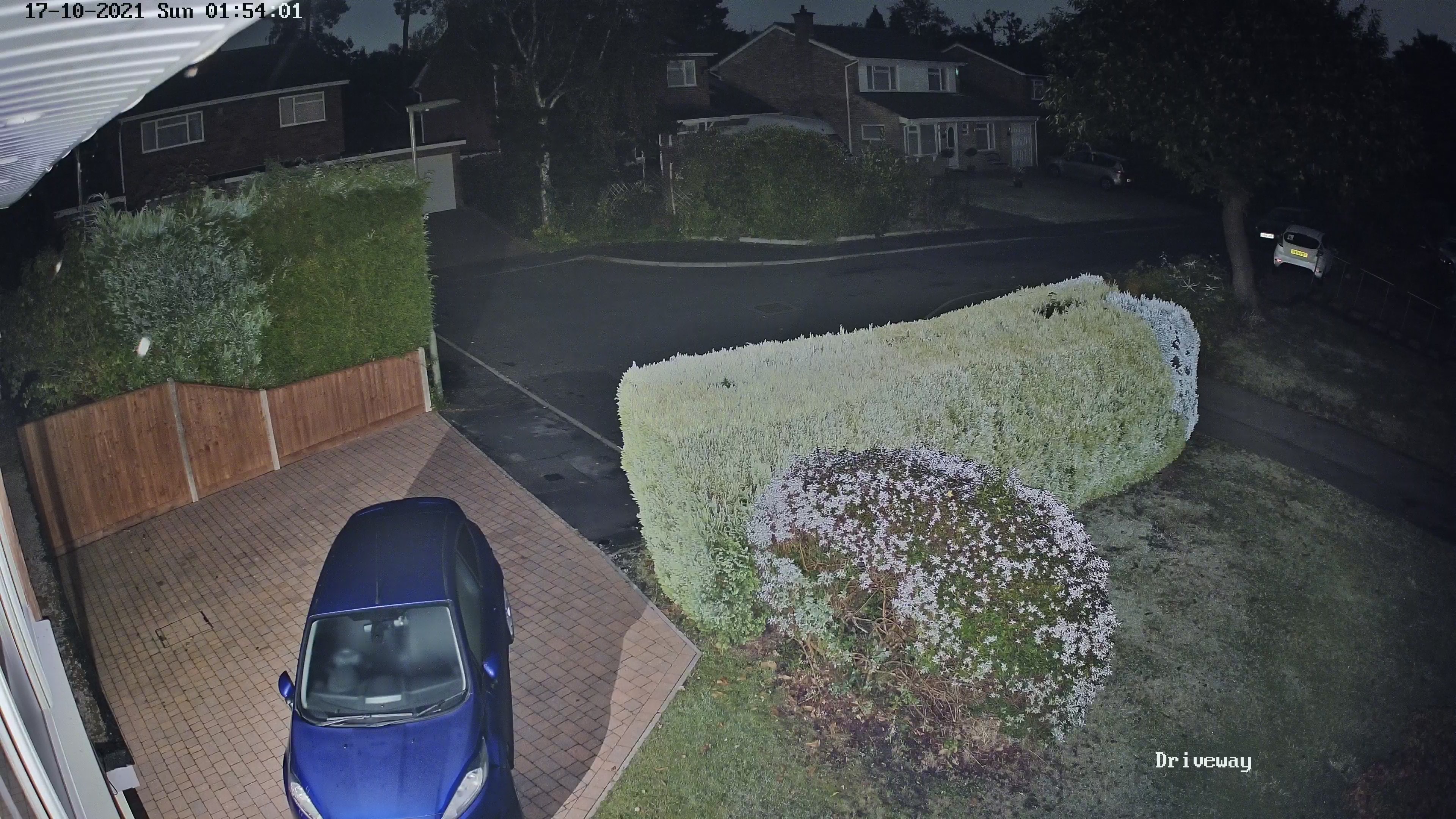

Hello everyone.
I installed two DS-2CD2387G2-LU 4K turrets today with a DS-7608NI-I2 running V4.51.007 build 210818 and had a few issues listed below:
1.. Pixelated 1/3rd image in live view in 8MP
2.. Digital Zoom function turns screen black and only way to reset to normal view was to restart NVR
3.. Auto switches resolution down from 3840*2160 to 3200*1800
I searched for a new firmware and found Firmware_V5.7.1_211009 available via the UK product link page:
Since carrying out the firmware update the faults seem to be fixed but Im not getting the event/white light linkage to control?
