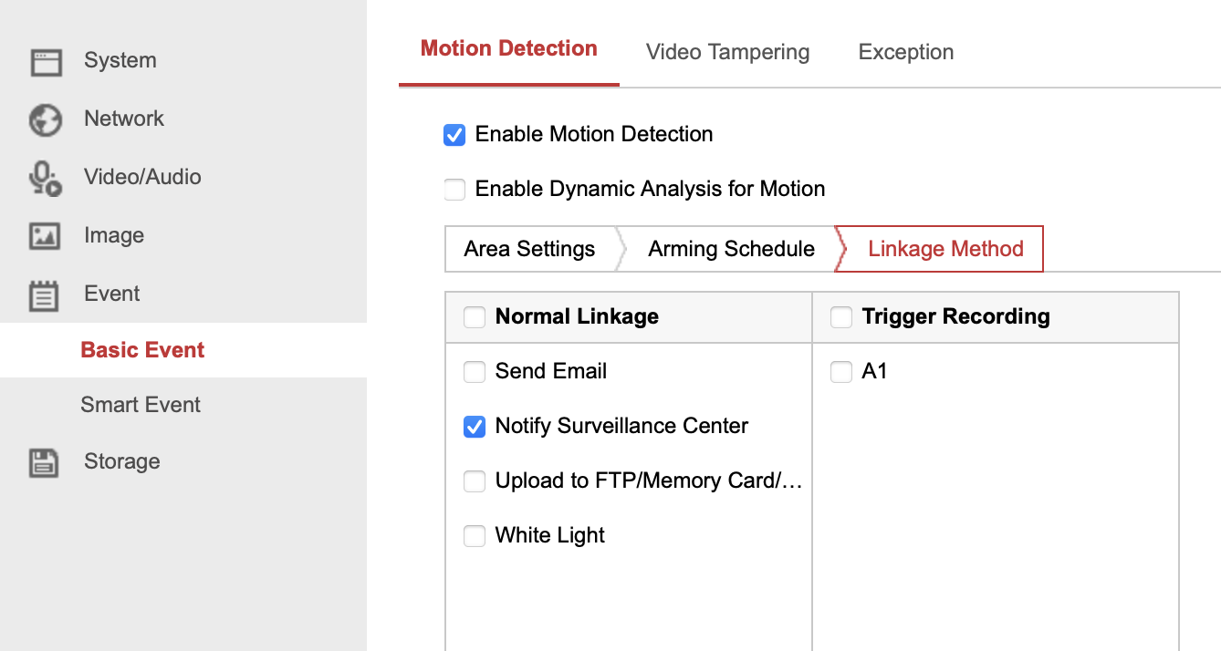

It's actually still available (white light on event) on the new 5.7.13 I posted about yesterday. It's been added and removed several times. This is an LU on 5.7.13:

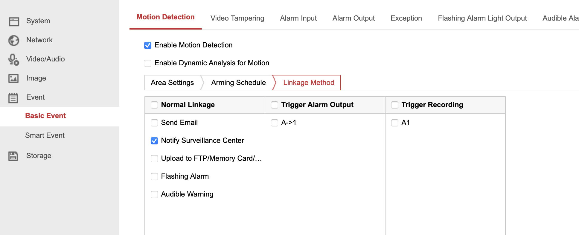

The LSU/SL model doesn't have white light on alarm, just flashing light on alarm and has always been that way. This is an LSU/SL also on 5.7.13:
Though these are both G5 (C) cameras not G3.
@grantring you won't see the setting in the NVR, after you've set up your event as normal, the white light action can be added by logging into the camera directly.

The linkage action 'white light' is available for all events but as said it has to be done directly in the camera as there's no option in the NVR linked to it. I've not used it myself but from what I recall, as it is linked to the event, it activates the white light 24/7 if the event is triggered.
