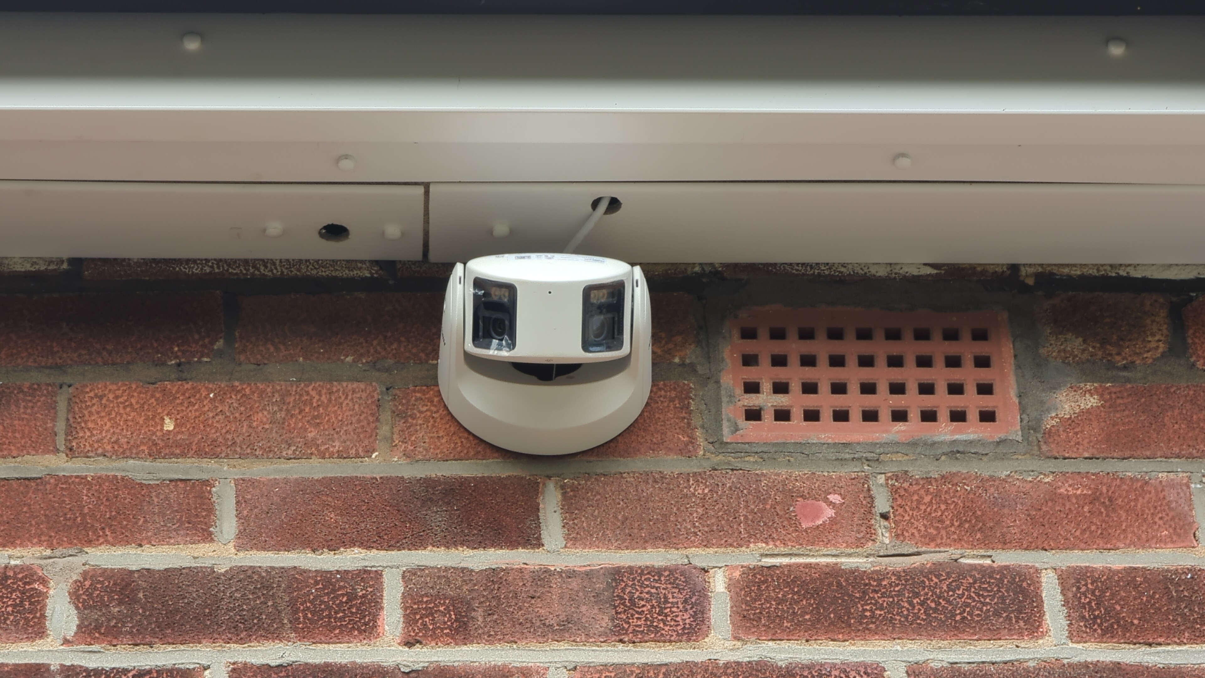

I've had to mount two of these cameras against a wall instead of the roof soffits.
For the camera to be the "correct" way around the base plate has to be position so the cables comes out below or to the left of the camera.
I'm still sending the cables up through the soffit so I put the base plate on upside down so the cable comes straight out of the top and into the soffit.

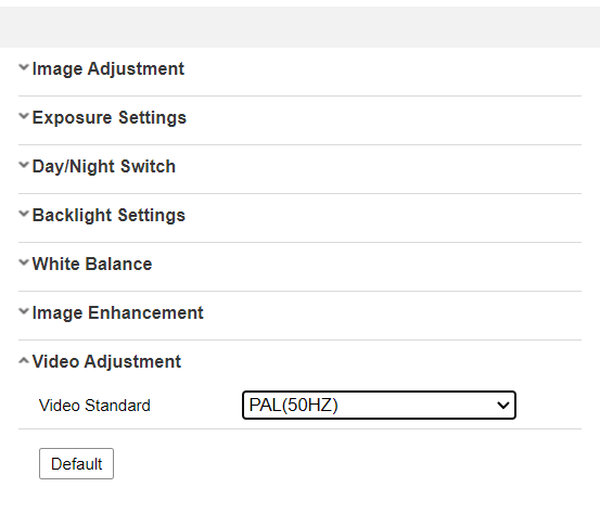

Thanks Kyle, I read through your tutorial but the option doesn't exist. (see screenshot)

I've just spotted that the model you are using is the Panoramic Turret, as far as we are aware these models do not support the rotate mode.

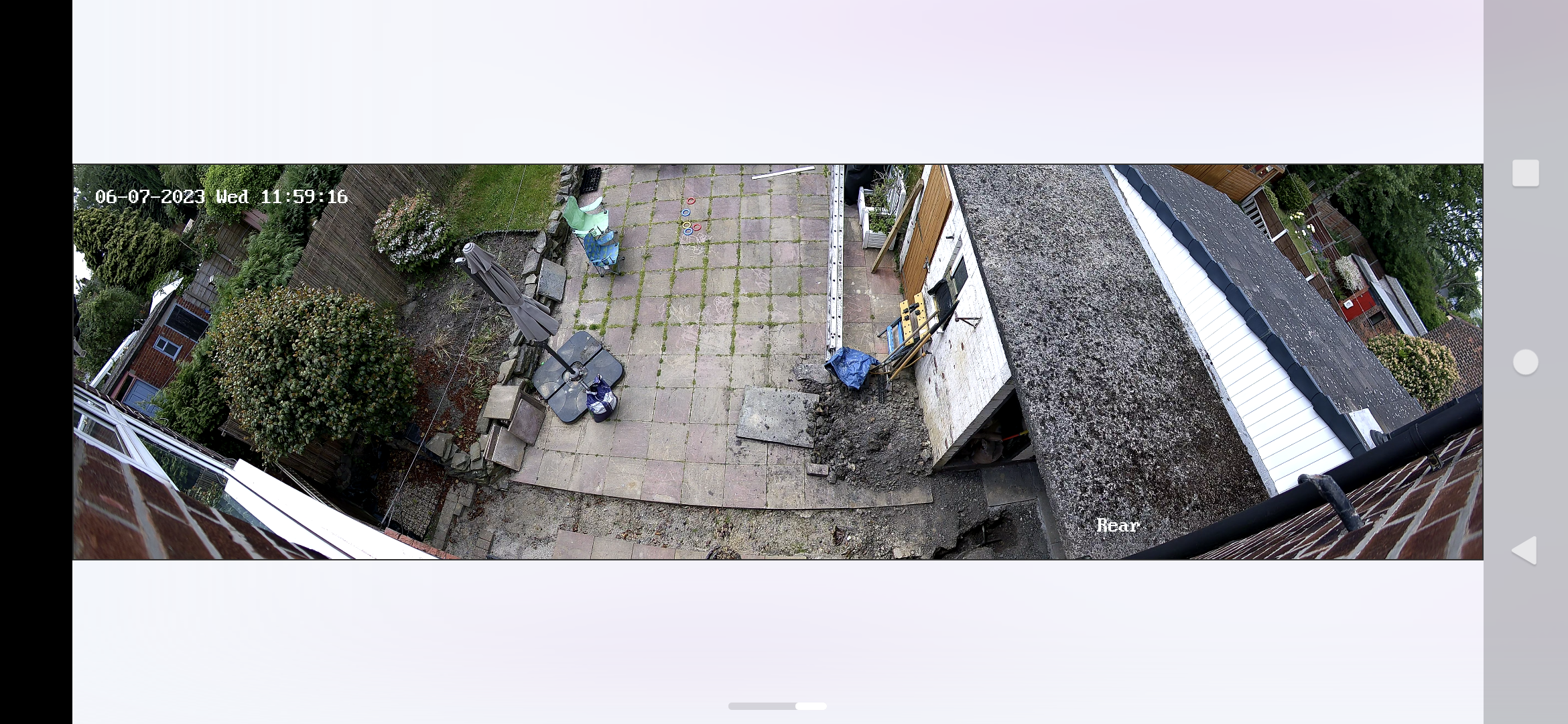

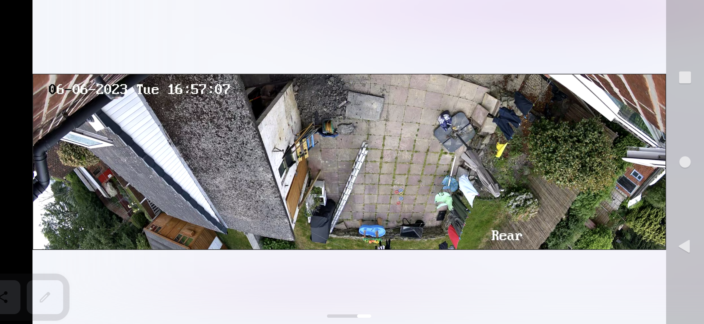

Removed camera, mounting plate, turned it around 180 and it's now "upside down" but the camera is now mounted the correct way around with the cable coming out of the left.
Doesn't look as nice but at least it's not upside down anymore.
Baseplate correct way up and camera upside down, cable coming out of the top
Baseplate on upside down and camera the correct way around, cable coming out of the side
