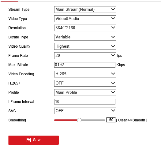

Hi,
I recently replaced two of my DS-2CD2087G2-LU with DS-2CD2T87G2-LSU/SL, shh don't tell the wife, she thinks it was a 'needed upgrade'.
I've noticed when watching Live View on my phone and PC anything with motion almost seems to jitter every few movements, like the camera can't focus on the speed they're moving at, I also noticed that if I zoom in onto someone's face it's just pixelated.
Settings on the camera are:
I've tried smoothing at 1 and it's still the same.

Edit: both camera and NVR are running latest firmware
I thought it could be my NVR but I've checked directly on the camera and I'm seeing the exact same thing.
