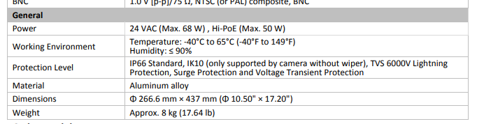

I have installed x2 DS-2DF8225IH-AEL(W) this week. The one was powered by a 60W POE injector the other a 24V AC 3amp Power adapter( this was a upgrade from a 2DF7286-ael)
As soon as night time fell they both started to give the same issue. The second unit I tested for 15 hours in my office (but the light's were on) before we installed on-site.
The issue I am having is as follows...
The unit says on-line for 6 minutes, then it's off for 1:30 seconds then back on for 6 minutes.(it does the full initial start up process where ptz spins 360) Rinse and repeat. Its doing this even in Inactive mode....
They are both brand new units. I unboxed them myself and took off every seal. The units are still on the original firmware.
Date of Manufacture is 02/2019.
Any help will be greatly appreciated.
