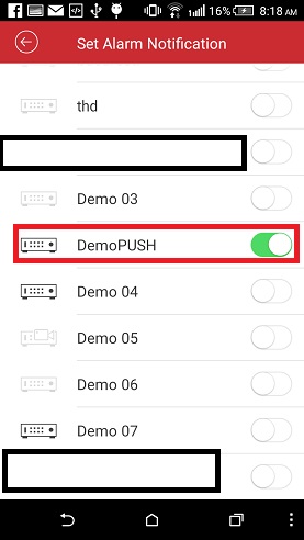

You are logged in as admin at your S10 I believe and not as user or operator.
Try to turn off the "Set alarm notification" from any other IVMS-4500 device and log in only you as admin from S10 to see if there is a change.
Me logged in as admin and my wife as user or operator, no notifications to my wife.
Also make sure you use 4500 and not 4500 HD (worked abnormally on my Sammy).
