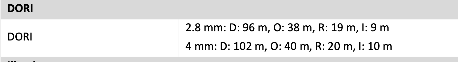

You will undoubtedly get better images. There are DORI (Detect, Observe, Recognise, Identify) distances given on the data sheets for each camera and lens combination. Identify (someone unknown) is half the distance of Recognise (someone you know) and bear in mind those distances will be based on captures in decent light without taking movement into account. The DORI for the 8MP is shown below:
At 15/20 metres you're still going to struggle to identify a moving person in darkness. You would be better having an additional camera optically zoomed to cover the specific area.
