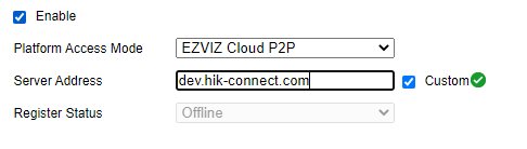

I'm trying to have a DS-7332HGHI connect to HikConnect platform, but for the love of me I can't seem to make it.
I contacted tech support but they could not help me.
The reasons could be multiple, I'll try to give as much details as I can.
  • DEVICE: DS-7332HGHI (Turbo 1.0 I think)
  • FW VERSION: V3.3.4 build 170220 (installed already, I have not upgraded it as it seems to be the most recent version)
  • NETWORK THE DEVICE IS CONNECTED TO: ENTERPRISE (under a dedicated VLAN with internet access)
  • PORTS OPENED ON FIREWALL: HTTP (80), RTSP (554), CLIENT (8000)
  • CONFIGURED DNS: GOOGLE (8.8.8.8)
  • PLATFORM ACCESS PARAMS
    • PLATFORM ACCESS MODE: EVZIZ Cloud P2P (could be a culprit, I CANNOT CHANGE THIS, interface is as in this post)
    • SERVER ADDRESS: dev.hik-connect.com (originally was dev.ezviz7.com, tried also dev.eu.hik-connect.com as I'm in europe, or even the direct IP address, no change)
    • REGISTER STATUS: Offline (locked)

Hi @probably_decommissioned
We have minimal experience with analog equipment and no experience with DVRs this old.
From some digging in the Hikvision download portal, I can see that the firmware version you are on currently is the latest version for -SH models.
The only thing I can recommend to try is unbinding the DVR from Hik-Connect using SADP and then try enabling Hik-connect again.
If that does not work then I can only think that this model is too old to support Hik-Connect and you will need to set up port forwarding instead for remote access.
Hi @Dan, apologies, I delayed the reply to try and follow your suggestions (had to ask for help from the local colleagues, took some time)
We tried to unbind the DVR but to no avail, it still shows as "offline" all the time. Port forwarding is neither an option, unfortunately, we don't have a static IP available.
In the meanwhile we found a newer unit, a DS-7332HQHI-K4, which seems to be able to connect the hik-vision with akin network configuration, therefore it's likely as you say, the DS-7332HGHI might be too old to support hik-connect.
