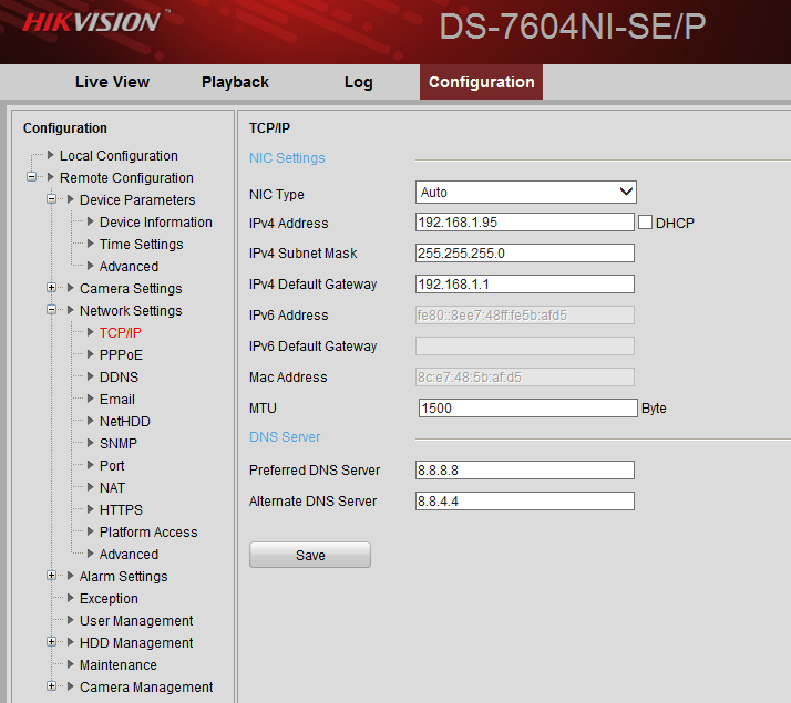

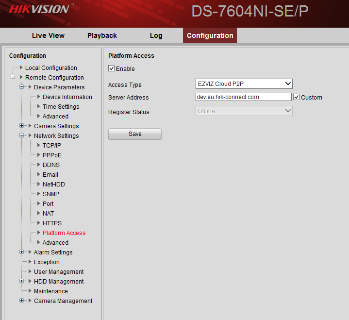

I have the same DVR. I'm also having trouble connecting to hickconnect.
These recorders (and a lot of old hikeconnect equipment) used the standard ADCDEF verification code.
When I try to add the DVR to the hikeconnect cloud and enter this verification code, I get a message that it cannot be used and I need to change it....
There is no possibility to change this code to another one in the web settings of the recorder and in the IVMS-4200 application....
