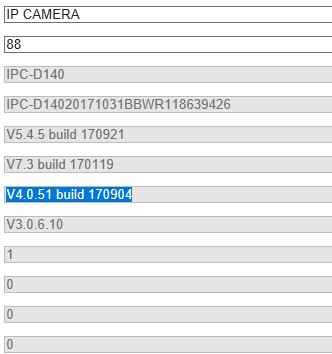

Hi Dan
the firmware version is V5.4.5 build 170921 and the firmware in use at present is V4.0.51 build 170904 just to make sure I've got what you asked for I've attached a screenshot

Thanks @IanW
So you don't have a 'Firmware Version Property' box at the bottom of that page that looks like the one below?
I just want to double-check because we don't have any experience with the HiWatch/HiLook cameras so don't know if they include this same information that the Hikvision cameras do. It would be helpful if they do because this code would direct us to the correct firmware, currently without it there are many HiWatch firmware folders with very similar firmware versions and no documents to confirm which are compatible with your camera model.

Hi Dan
No there isn’t a Firmware version property box don’t worry as all the cameras are working ok and I just thought as I had updated the NVR I would also do the cameras. I do appreciate the help you have given me and would like to thank you for that I think I will just leave well alone for the time being and probably gradually replace the cameras
