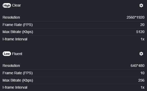

The first problem is that the doorbell camera seems to be limited within Hikvision to only accept the cameras “fluent” video config of 640x480@10fps, despite the camera having a “clear” stream config of 2560x1920@15fps. The option to select a different resolution is greyed out. This differs to the other camera which is an indoor unit that Hikvision seems happy to take its “clear” stream of 2560x1440@15fps and allow you drop down to 1920x1080@15fps if needed.
I haven't used ONVIF, but I'd guess the compatibility you are seeing now is the best you will get with ONVIF... an alternative would be to switch at least the doorbell from ONVIF to RTSP... I think you would be able to record the clear/main stream that way, but you would not be using the NVR to configure the camera... instead just use whatever Reolink software there is... I have a similar setup to you with some Wi-Fi cameras (doorbells and 2 indoor cameras) added to my Hikvision NVR, but they are EZ-Viz cameras which use the Hikvision protocol, so things are quite compatible.

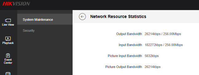

The incoming bandwidth limit on the DS-7608NI-I2/8P is 80MB. You're probably using most of it especially after adding the 2 new cameras. What bitrate are you running on the cameras? There is a "Network Resource Statistics" screen if you log into the web GUI that will show you how much of the 80MB you have allocated (this screenshot is the 5.0 GUI, but it was also in the 4.0 GUI) ...

The I series NVR was the way to go when you got it 3 years ago... If you decide it needs to be replaced, go with the DS-7616NI-M2/16P.... it has 256MB incoming bandwidth vs 128MB on the DS-7608NI-M2/8P... and you have 8 cameras now, not hard to imagine you might want to add at least 1 more camera sometime?

I had a similar ONVIF problem and ended up adding the cameras to the NVR using the custom protocol option and the RTSP protocol. I think two different ONVIF standards agreed a lower common ONVIF standard to offer "fluent" video resolution only. The camera offered three RTSP URL streams with Low / Medium / High video resolution along with audio.

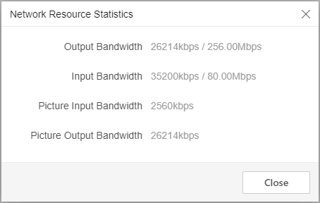

See below Network Resource Stats after having re-added the cameras over RTSP. This seems to suggest there is headroom as I'm only at 35.2/80Mbps.

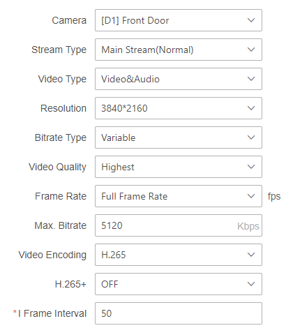

All of the Hik cameras are set to the below config:
Plenty of room there so I it doesn't seem like the Reolink issue could be caused by limited NVR incoming bandwidth.
I might try increasing the bitrates for the 6 Hikvision cameras from 5120 Kbps to maybe 8192 Kbps... the max bitrate on those seems kind of low considering the resolution and frame rate. Your overall incoming would change from 35/80 to about 53/80 Mbps.

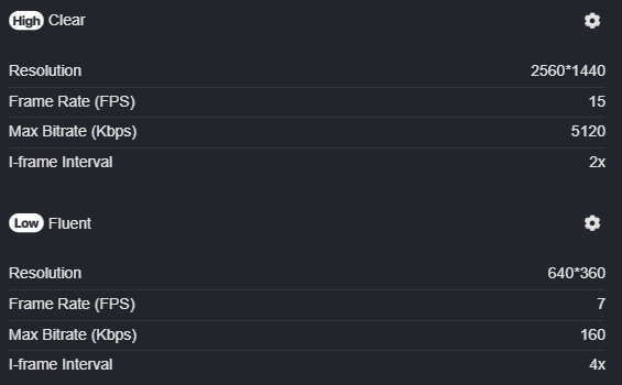

The indoor is an E1 Pro. Link here. The bitrate is set to 5120. See below configs for both Reolinks. 5120 is the highest bitrate I can select.
E1 Pro
Doorbell
Frame rate mode is constant (not variable).
I've upped all the Hiks to 8192kpbs.

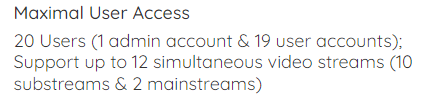

I noticed in the camera specs...
Any chance you are trying to get the mainstream to more than 2 devices at the same time?

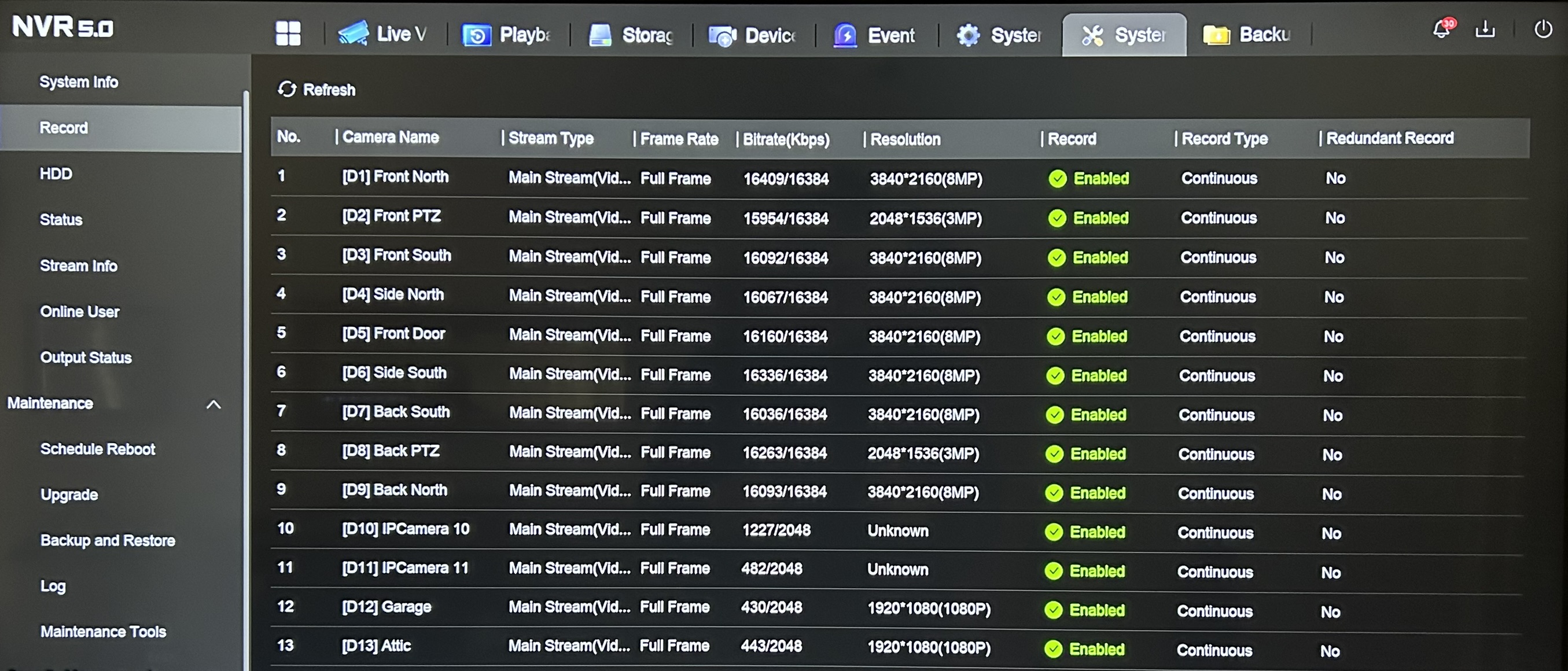

Here's my "system maintenance/running info/record" page:
Cameras 10 and 11 are connected with RTSP... camera 10 has a max bitrate of 4096 but the NVR shows 2048... at night the camera does run at a higher bitrate, and I see something like 4444/2048... I wonder what bitrates you see on your NVR's record page?
Had a think as to whether I was viewing the mainstream to more than 2 devices, but realised that for the impacted camera; the indoor E1 Pro, I was only viewing one stream at any time. So another dead end.
Unfortunately I don't have a monitor hooked up to my NVR as its in a server cab so can't easily check the "system maintenance/running info/record" page.
But having worked out that it was now just the E1 Pro I was having issues with, I decided to check if there was a firmware update for the E1 Pro on the Reolink website. I totally thought this was a longshot, as it must've only been a couple of months ago that I last checked, but low and behold, there was an update released only on 10th Jan 2024. I updated the device to this firmware last night and with great success I can report the stream is now smooth within Hik-Connect, Hik Portal/GUI and when playing back recorded footage. It's been painful getting this far and has cast doubt on adding further Reolink cameras. I think Reolink's only defence is that the E1 Pro is I think a relatively new model.
