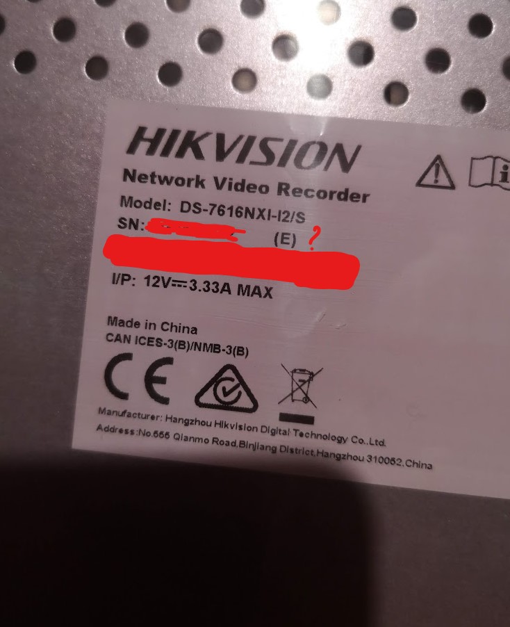

Hello. I have recently purchased NVR DS-7616NXI-I2/S(E) but firmware is 4.62.325 build 230810 and the online update says that it is the latest. Cant understand I have DS-7616NXI-I2/S or DS-7616NXI-I2/S(E) revision and can I manual update to V5.03.020_240904?
Hi @dimmon-ua
The latest firmware for your NVR is V5.03.020_240904 (Go to Resources > Firmware to download the firmware file)
Sometimes the online firmware checker in the NVR menus doesn't detect the latest firmware versions, always check the Hikvision website.
Thanks, I was confused that (E) must be in Model name, like DS-7616NXI-I2/S(E). But how I understand Model name: DS-7616NXI-I2/S and revision (E) above serial number.
Yes, the model number is DS-7616NXI-I2/S(E) but Hikvision for some reason print the (E) on a different line on the NVR label.
