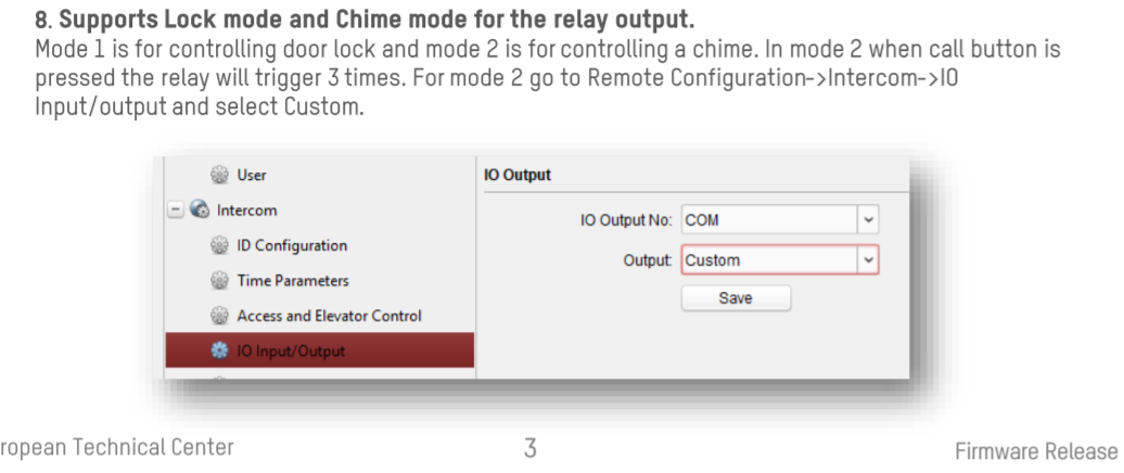

But not sure about the relay about the physical chime, however found this in the firmware release pag3 point 8.:
Anyone with experience in this doorbell? The Output relay can triggers when the button is pressed?
