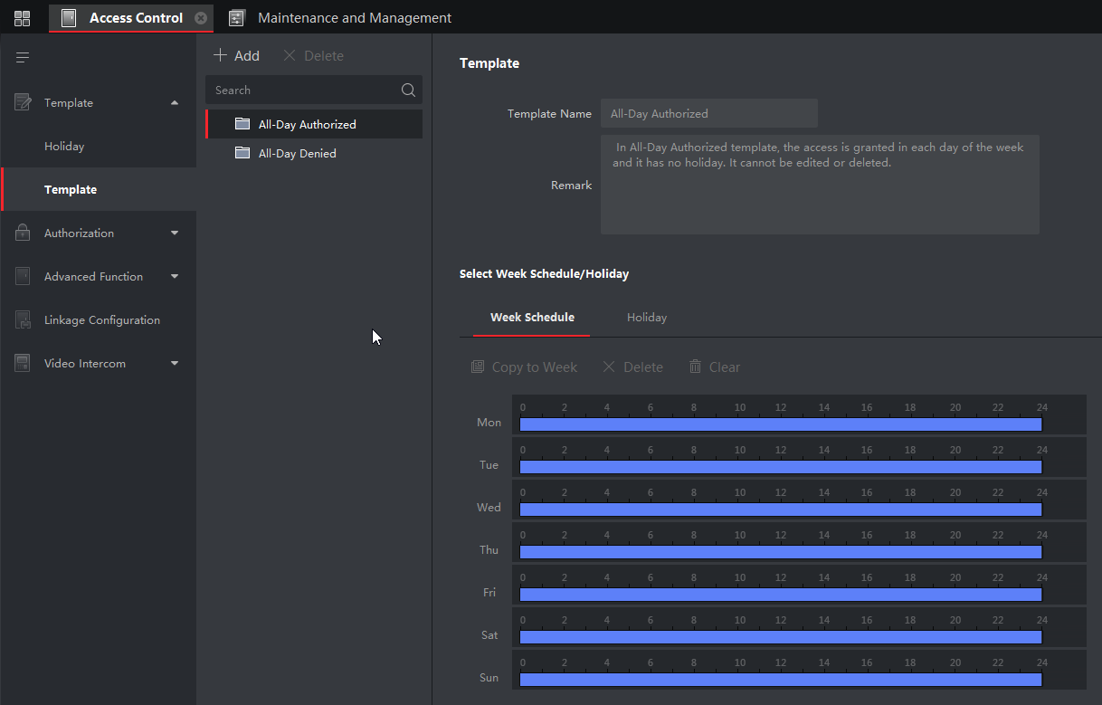

Hello everyone ,. I want to know is it possible to set up in Access control section in IVMS 4200 - Door open/Door closed schedules on DS-KD8003-IME1 ? I need to make entrance door to be open at specific hours :)
You can add users, and when adding template you can decide when those users can use doors.
But you can use this only if you use cards or pin for opening doors.
So you firsty add person into organization ( add card or PIN), then edit template and then go to Autorization/Access Group and add those users to group with specific template.
So you need DS-KD-KP ( keypad module) fot this to work.
