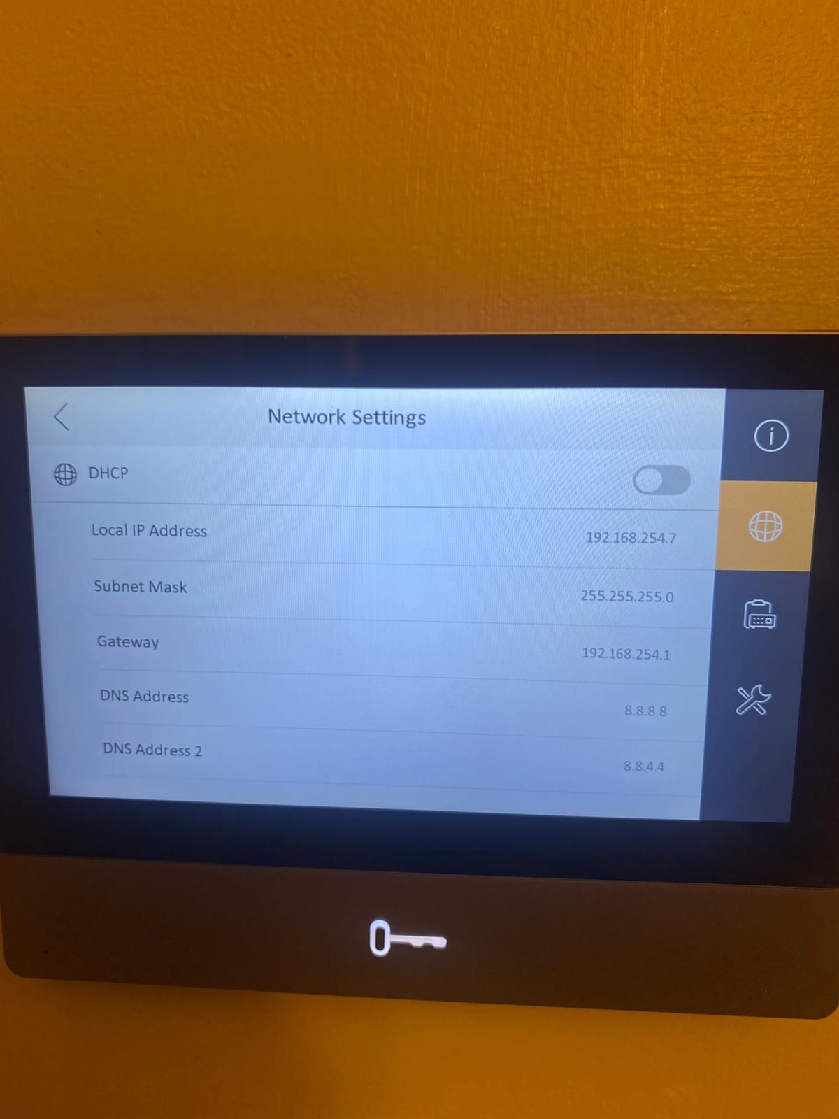

Hi @John Carr , the video guide you posted - is the exact one I followed to set up my intercom.
At 6mins in - the guy uses WiFi to enable Hik-Connect on the intercom. So he is using the NVR to provide POE power, and record, but is still using wifi to give the intercom hik-connect.

@user7364 Connecting a poe switch to the router, and then the intercom to the poe switch - it still shows as no hik-connect service / no internet access. (I did fixed IP in router, and assigned it in the intercom) I'm starting to think the intercom only allows hik-connect through wifi :(

all on indoor station:
1. disable wifi on indoor station
2. go to network settings and click on DHCP button, it will get new dhcp settings from your ROUTER
3. go to outdoor station (in indoor station menu), click on the small gear, it will open the network settings for the outdoor station. click on dhcp. dont click on the other small button, it will reset the outdoor station to factory
4. it should now show a new ip adress in the menu for the outdoor station, click once on it to activate it.
5. write down ip address of outdoor station
check if ringing and hik connect works, maybe you have to pair hikconnect again
