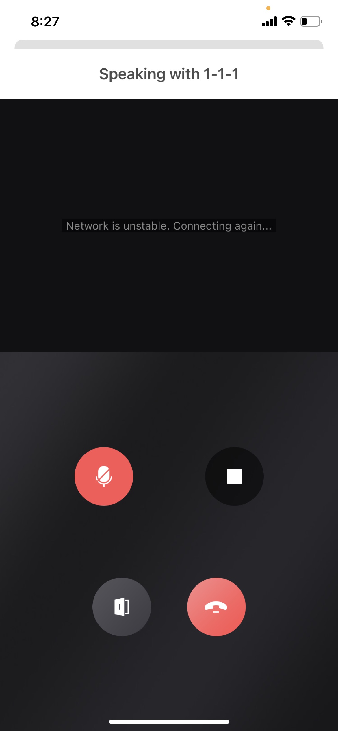

So the Doorbell camera works and all. Video, Calls Phone, records to NVR, etc
but when button is pressed and I answer the phone to see who it is, the video feed comes up as “Network Unstable” but the 2 way audio works and buzzer (if it existed) works as well
everything is hardwired, Not relying on WiFi whatsoever, super fast internet, super fast ubiquiti network, no port isolation, no Meshing, or any crazy firewall rules, tested using cell connection and WiFi.
I have the device video feed pointing to the NVR and DB is plugged into the local network via PoE and not behind the NVR (maybe I’ll try connecting it behind NVR)
I’ve adjusted video quality on main and sub and didn’t help at all
connection to app was made via QR code scan and not port forwarding and manual entry.
could it have something to do with Multicast since the NVR is pulling video feed as well
