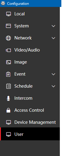

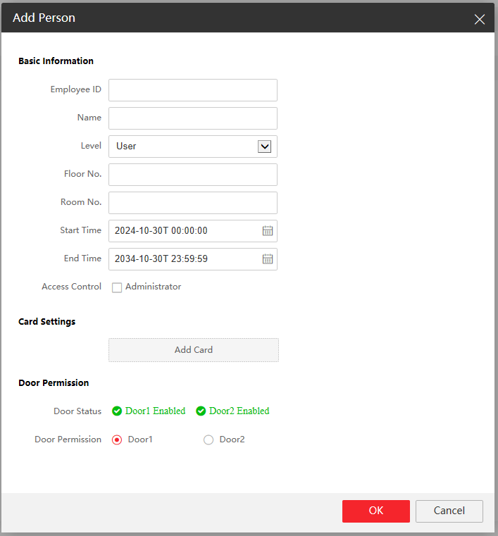

Responding to an old thread so maybe you already solved it. I could not figure out how to do it through iVMS/Access Control but if you setup user directly on DS-KV8113-WME1 you can select Door Permission as Door1 or Door2 (you have to configure it through iVMS and not webui as in webui the last two menus for Device Management and User are missing for some unknown reason).
