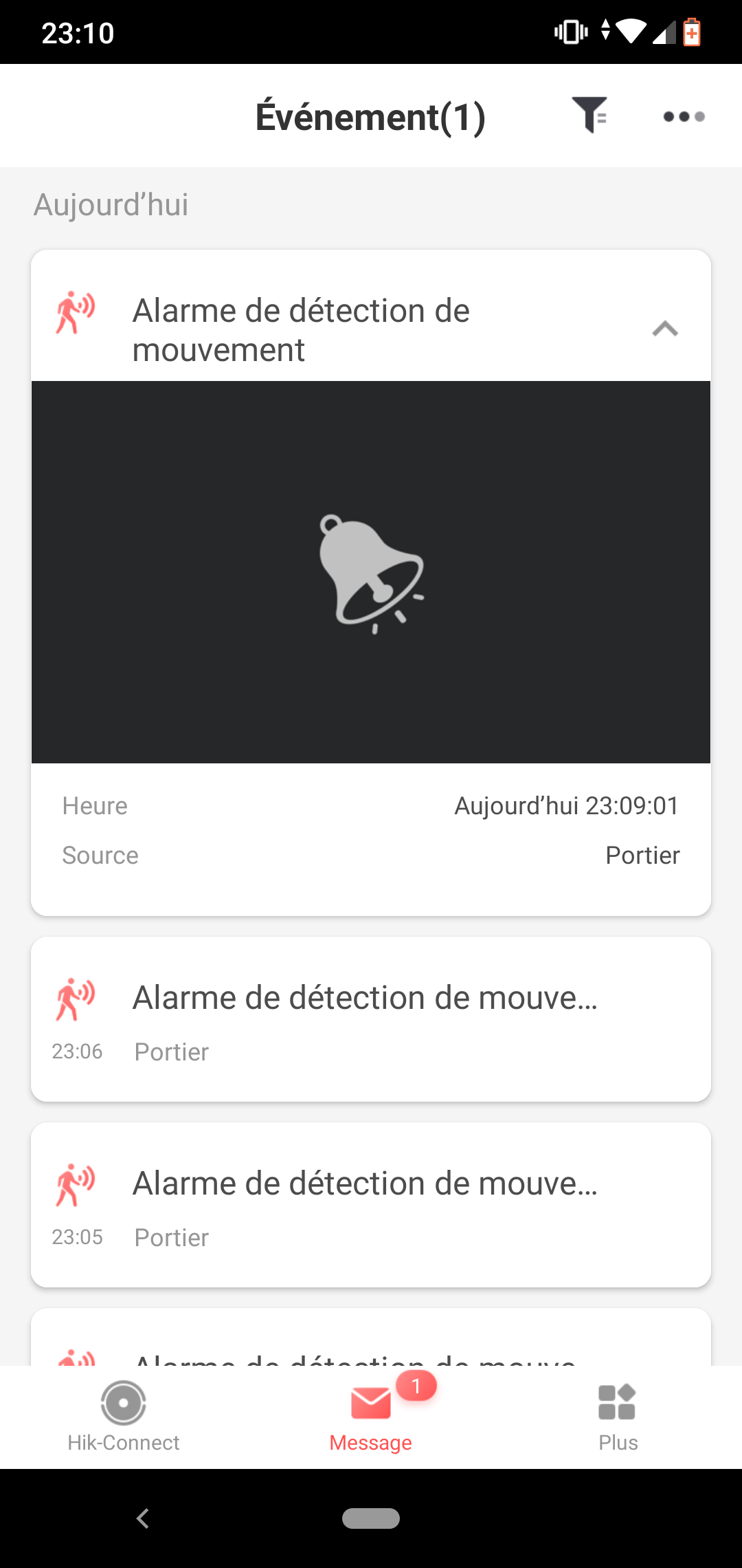

Hello, I have a problem with the KV8113 and hikconnect device detection captures. Indeed, I do receive notifications of each detection but no image on the detections.
Version of KV8113: V2.2.11 build 201126. Version of KH6320 V2.1.10 builde 201221.
On Hikconnect I have the notifications to activate for detection.
The KV8113 is supplied with POE and the KH6320 with wifi on the same network (192.168.1.1).
I don't have an NVR.

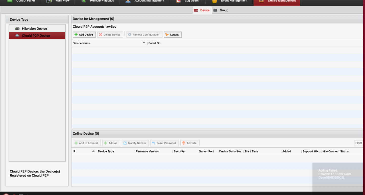

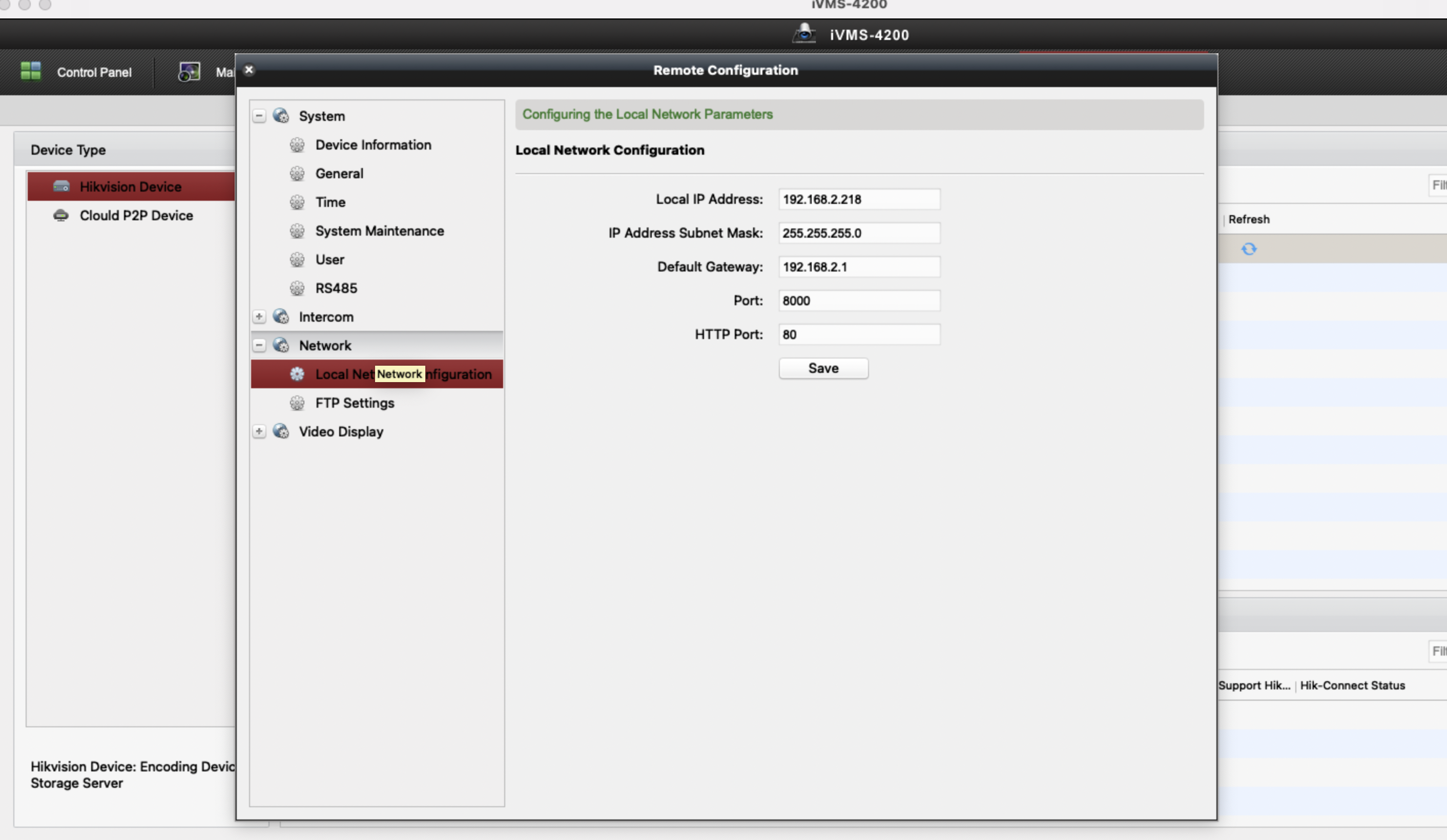

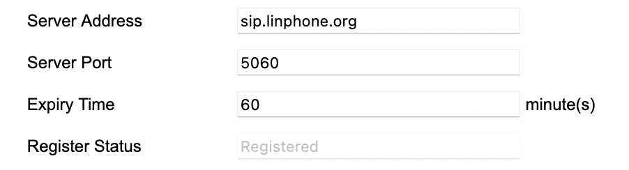

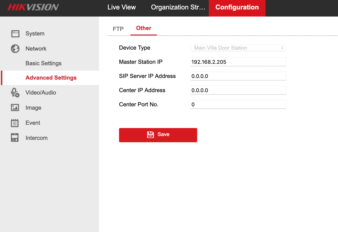

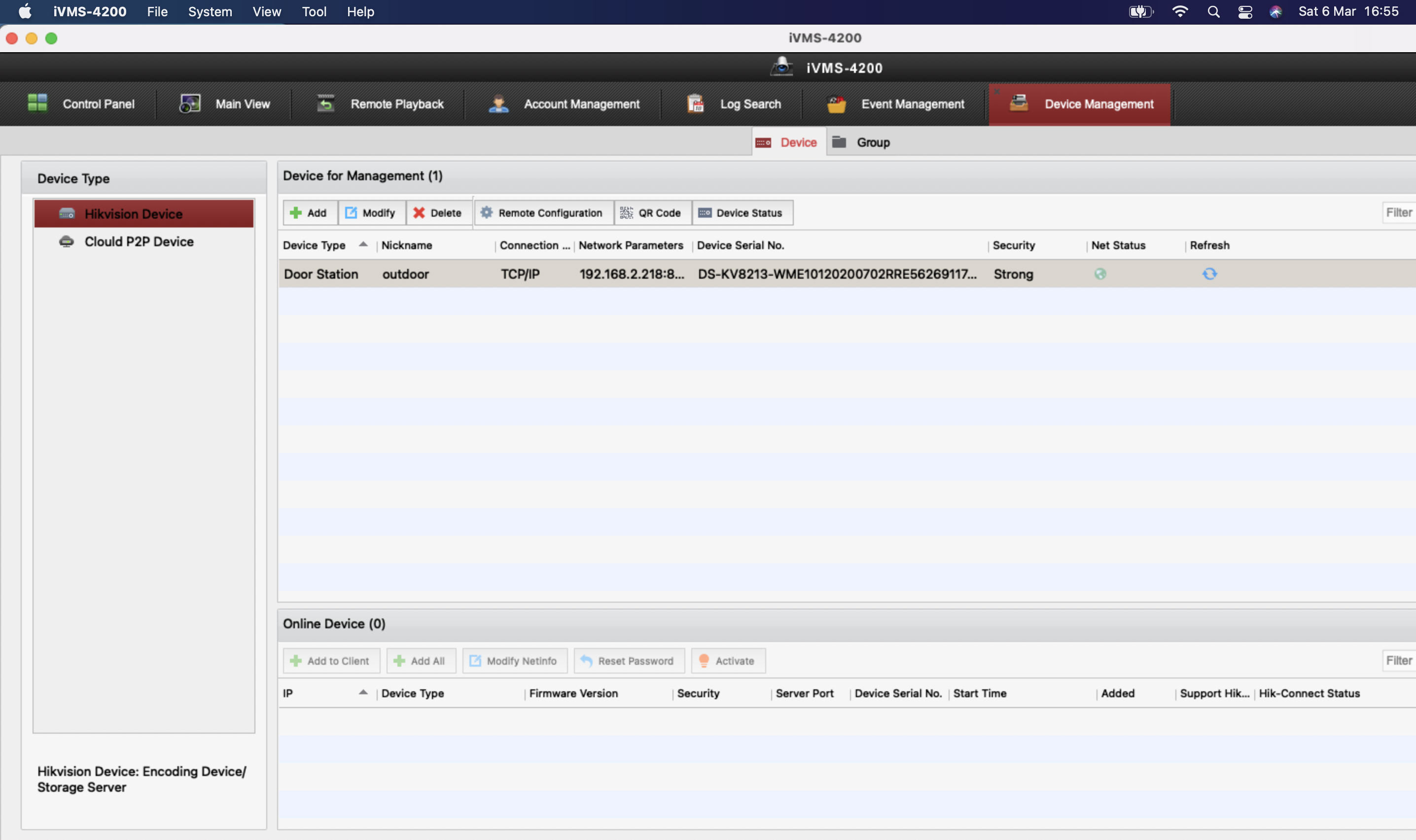

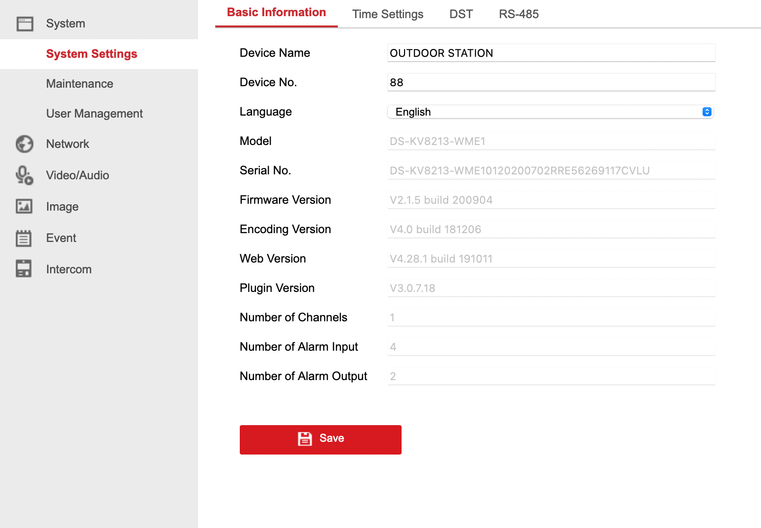

I also bought a DS-KV8213-WME1, and there is no option to connect to hik-connect, I can manually add it to the IOS app, but then I don't get any calls when they ring, and on the website it doesn't appear, on the IVMS 4200 I was able to add , but then when trying to put online, putting the serial number and the verification code, an error appears saying: Error Code OpenSDK (320002). I also created an account on sip linphone.org appears as registered, but when pressing the button, make the call but after answering an error message appears: Not Acceptable, can someone help?
