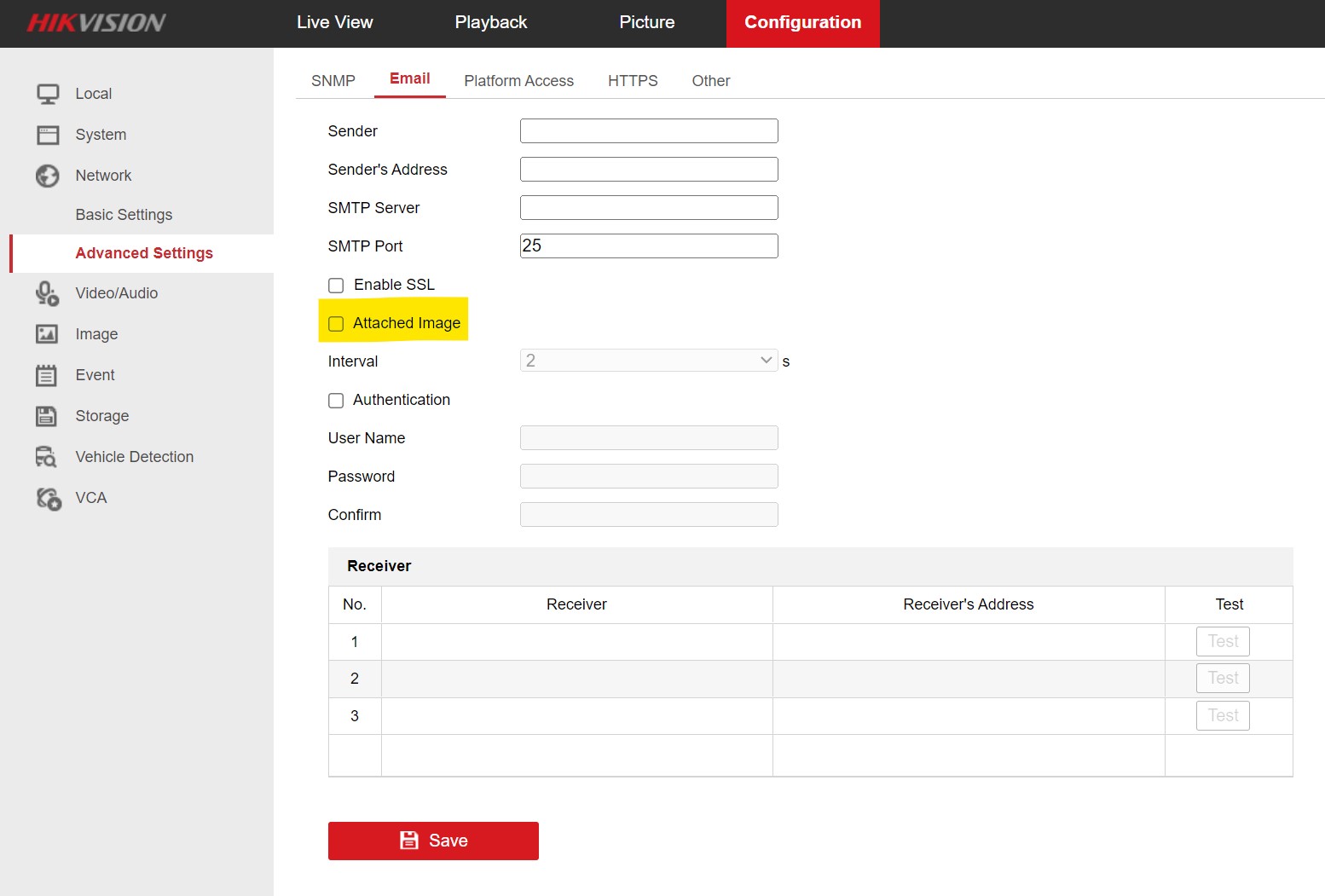

With regards to the email image, there will normally be a tickbox to enable the "Attached Image" in the email settings on the NVR (usually in advanced network settings).
I would connect to the NVR in a web browser (Internet Explorer is probably best), and check if you have this option - if you don't, I suspect that your NVR does not support this feature:
