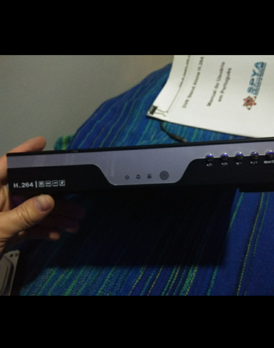

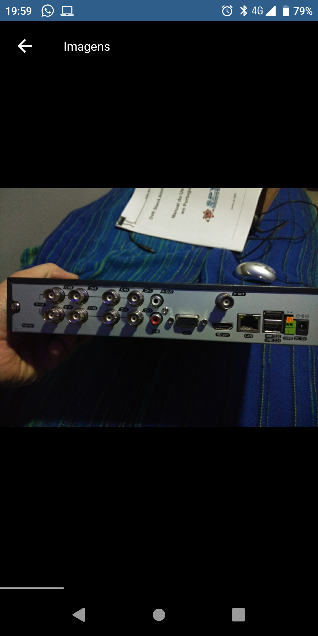

I have One DVR stand Alone

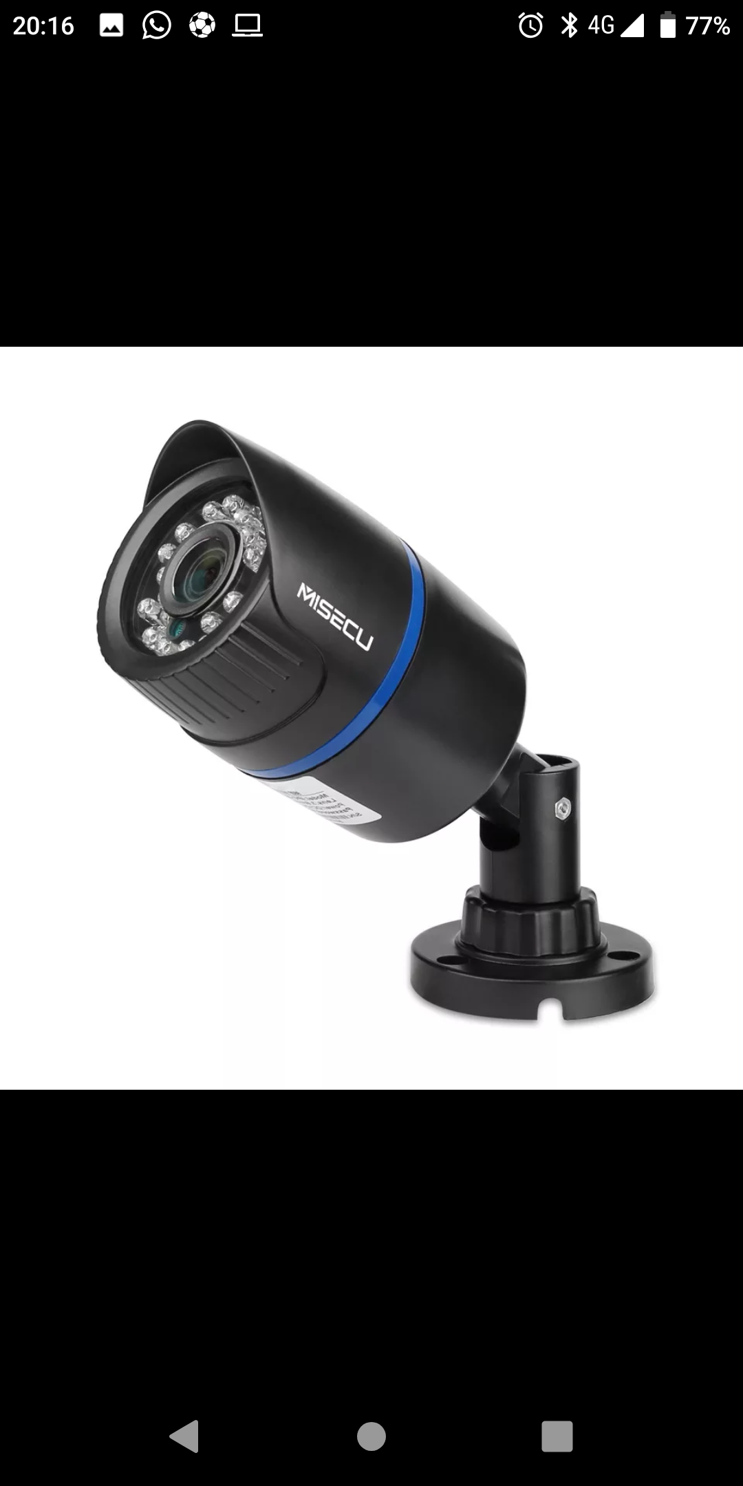

i want to know if its possible to use these cameras with the following specs.
  • Horizontal Resolution 1200TVL
  • Lens (mm) 3.6mm
  • Alarm Action FTP Photo
  • Sensor Size 1/4"
  • Model Number YN-AHD-BT511S
  • Technology Infrared
  • Focal Length 3.6mm
  • Viewing Angle (Degree) 75°
  • Supported Mobile Systems ios,Android
  • Connectivity Closed System/CCTV Wired
  • Sensor CMOS
  • Brand Name MISECU
  • Style Bullet Camera
  • Storage None
  • Video Compression Format H.264
  • Focus 3.6mm
  • Audio Output NO
  • Image Sensor 1/ 4" CMOS Image sensors
  • Specific 24 PCS IR cut filter with auto switch
  • Sensor 720P 1.0 AHD Megapixel HD CMOS Sensor
  • Lens 3.6mm
  • Color black default, white optional
  • Housing ABS Plastic Waterproof , Outdoor and indoor use
I'm asking this because i connect the cameras but the DVR don't recognize them

I don't recognise either the camera or the DVR, but would guess that the clue is in the claimed resolution of the cameras.
At a claimed 1200 TVL they would need to be some form of HD over co-ax format such as TVI, CVI or AHD.
If it's a standard DVR it'll be expecting standard composite 1 volt peak-to-peak composite video to a maximum resolution of around 550 TVL (no tricks / no HD over co-ax).
