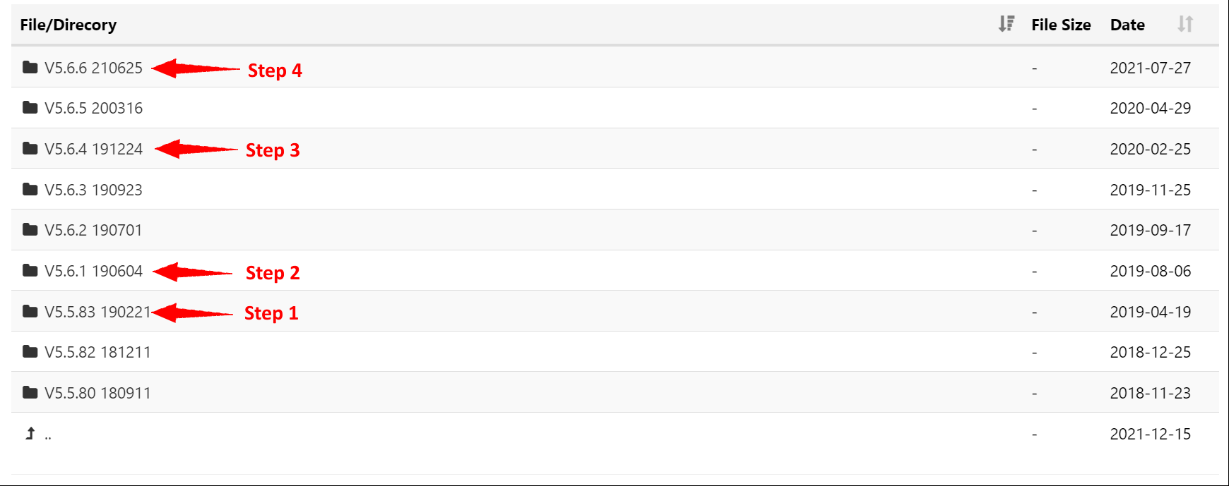

I would definitely update the firmware on your camera too, which should improve the performance and security.
V5.6.6 210625 is the latest version, but update in these incremental steps to make sure everything installs properly:
Here are our instructions for carrying out each update:
