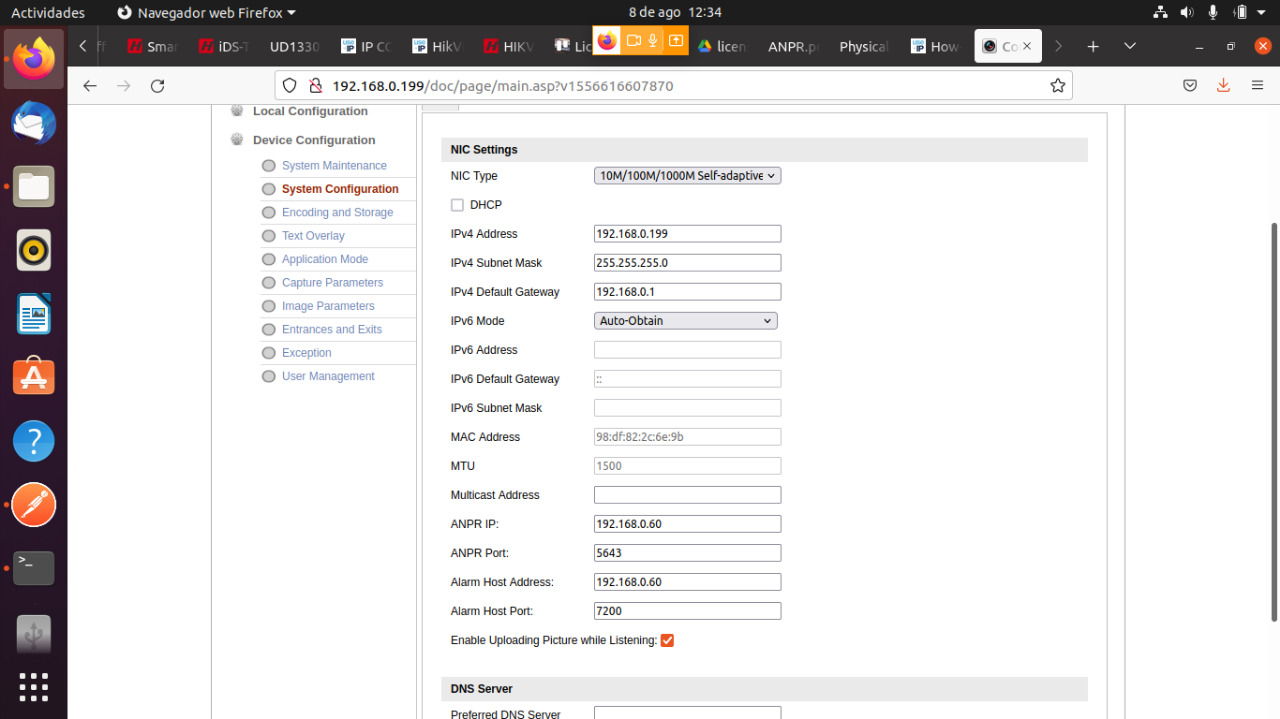

I'll attached my configuration for give you the big picture.
