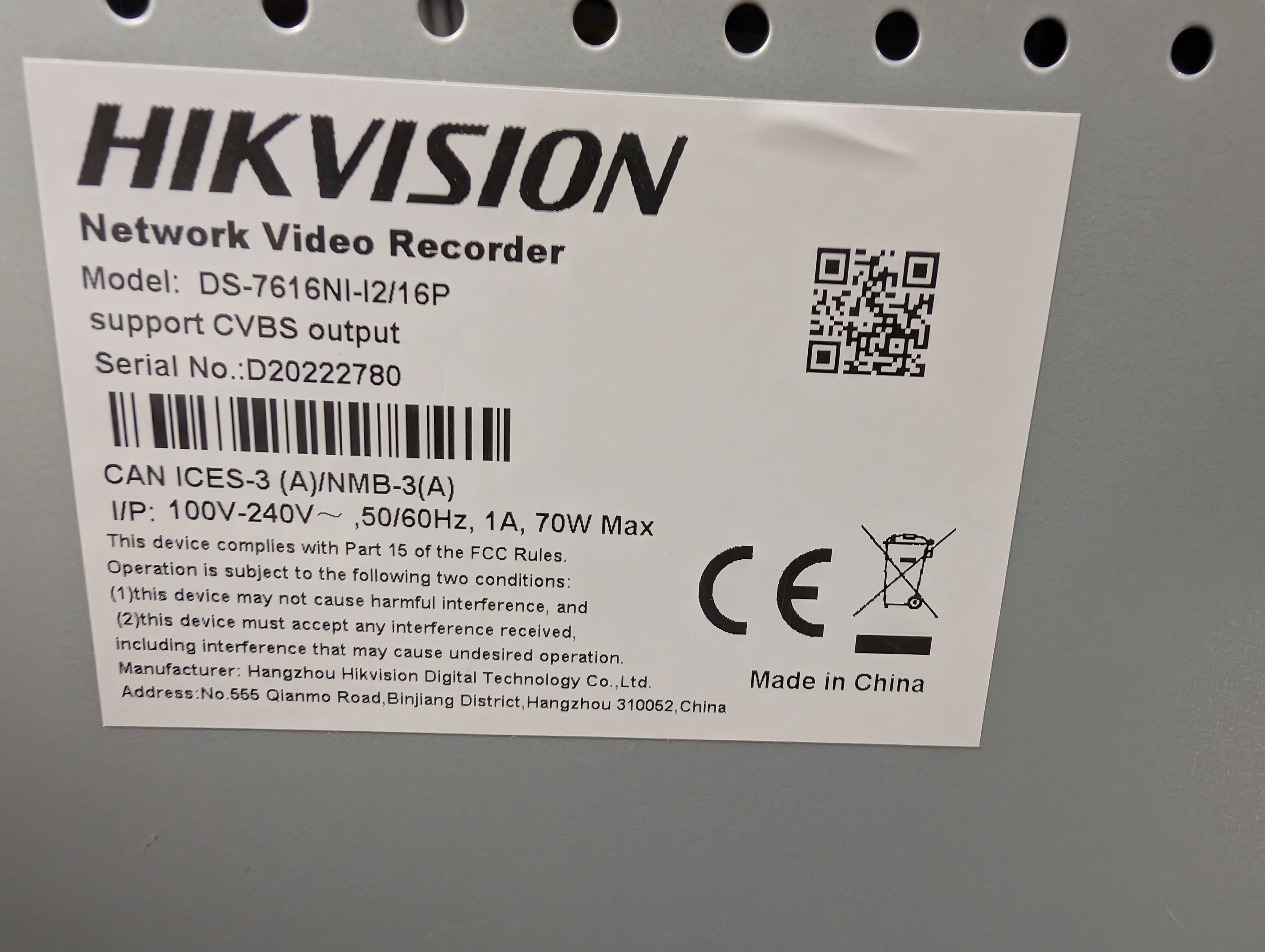

Can you please confirm the model number for the product that is giving you this error code?

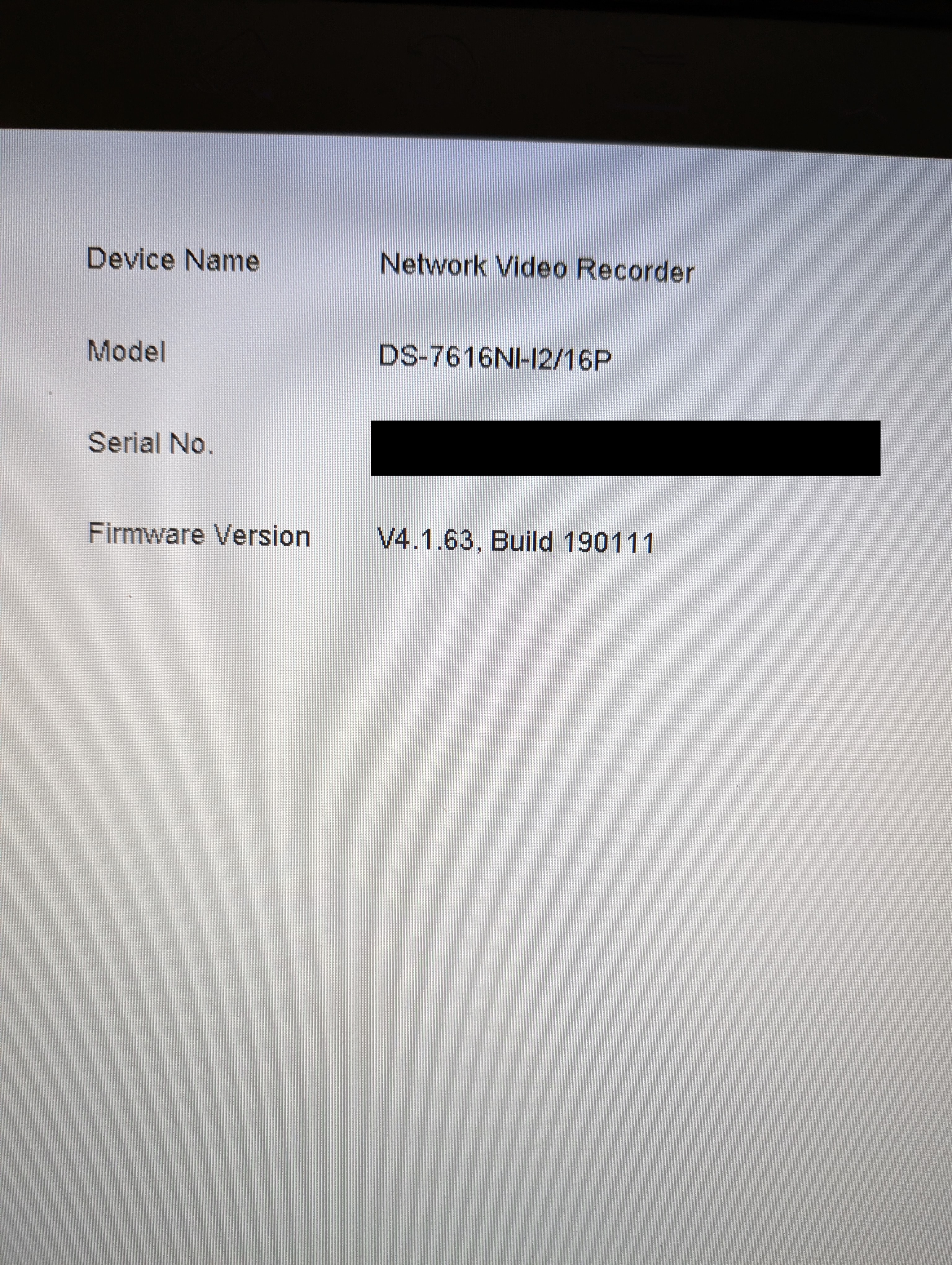

What firmware version is the model currently running?

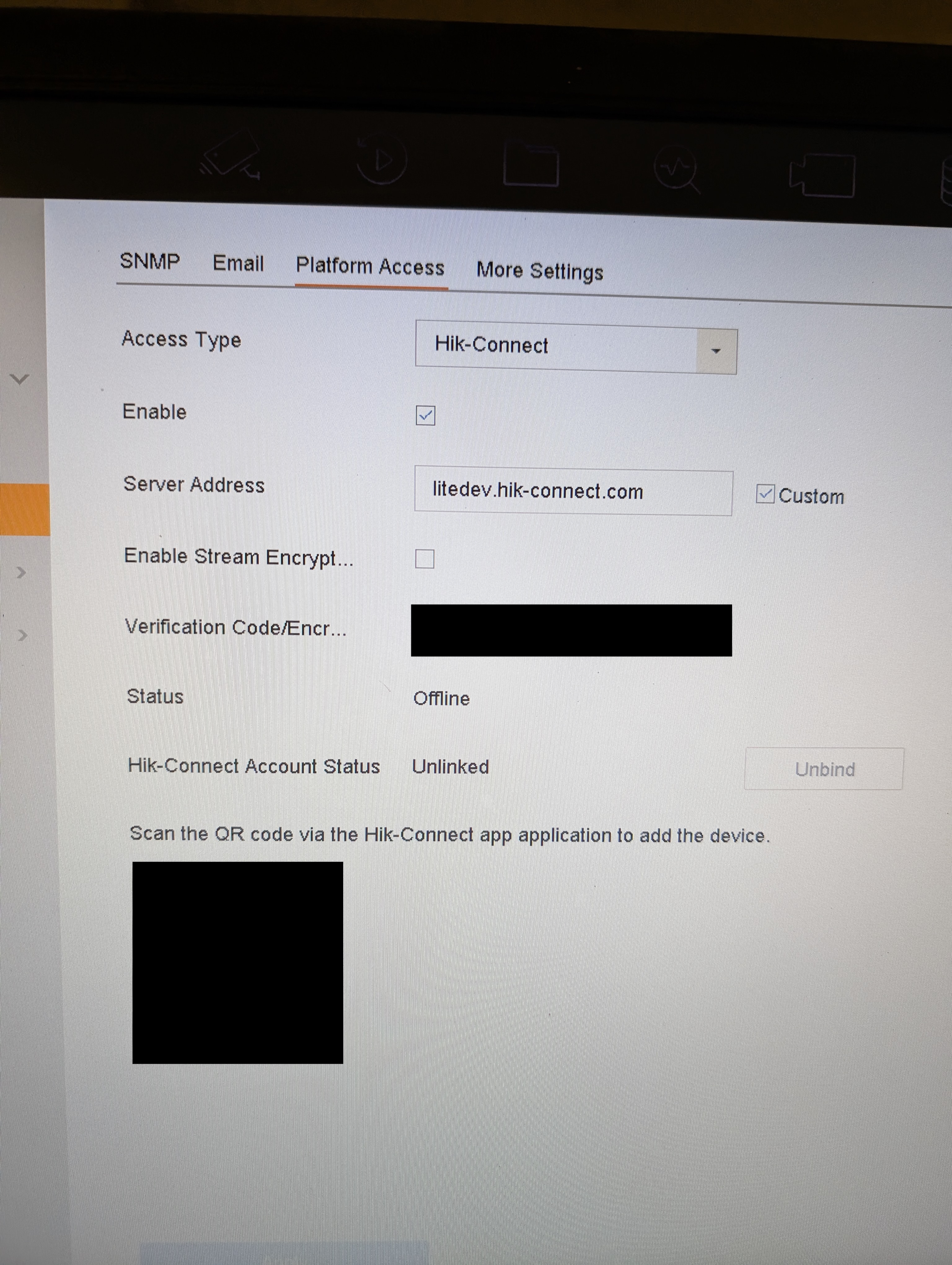

In the NVR menu on the direct monitor, under Network > Advanced > Platform Access, is Hik-Connect enabled? Did you enable it or was it already enabled when you first accessed the NVR?
Can you also go to Maintenance > System Info > Device Info and confirm the firmware version the NVR is currently using?
It was already enabled.
I just down loaded app and logged in and it came up as online device but when I click on camera or live view just comes up with the error

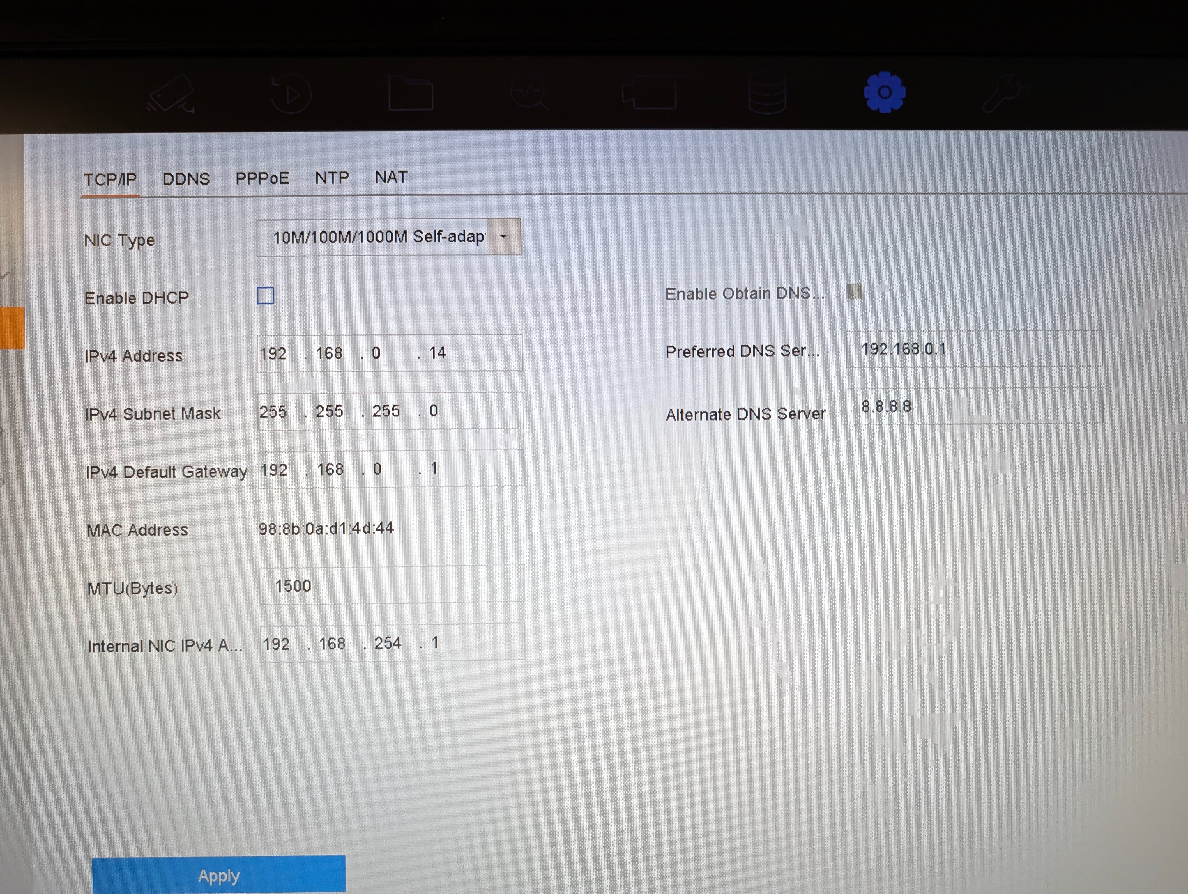

Do you have a PC on the same local network as the NVR?
As Hik-connect was already enabled, I think the error is most likely to do with the NVR already being connected/bound to a previous user.
You will need to install the Hikvision SADP Tool onto a PC on the same network as the NVR and then use that tool to unbind the NVR from the other user's Hik-Connect account.
Once unbound, you can follow the below instructions to add the NVR to your Hik-Connect account:
