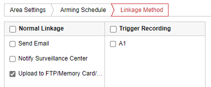

I have the Line Crossing Detection enabled in the camera and have the Arming Schedule set to 24/7 and the Linkage Method set to "Notify Surveillance Center" and "Upload to FTP/Memory Card/NAS" ticked. I've not ticked "A1" in the Trigger Recording section as I have it set to record 24/7 so I assume this makes no difference in this case?

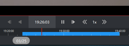

Hi Dan,
I found an old 32GB MicroSD card, quite small but all I need for testing. Unfortunately I'm seeing exactly the same behaviour using the SD card as using the NAS storage. With continuous recording enabled in the camera + motion and / or line crossing detection, I see absolutely no mention of these events in the playback timeline. I also don't see any event options in the Filters menu at the bottom left of the timeline either. There were definitely events triggered during this time on this camera as they show up in the 'Event Center' but this appears to only record events whilst iVMS-4200 is running which isn't much use unless I leave the PC on 24/7. The event data should be stored on the SD / NAS, not the PC running iVMS.
See images attached.
Just to add to this... If I select the 'Event Playback' tab on the left hand side of the 'Remote Playback' window in iVMS-4200 and search for Line Crossing events on the camera I know has these events in the selected timeframe, I get the error message "Playback failed. No record file found". This would suggest that the camera isn't storing the event data??
I've done some more testing and it looks like the only time the camera saves any event data to the MicroSD card or NAS is when a recording is triggered. If continuous recording is configured, this prevents any event related recordings from being saved (or even storing the event metadata). This seems crazy and an obvious bug to me.
What is the purpose of the "Upload to FTP/Memory Card/NAS" setting? I'd expect this to save event data so it can be recalled in a VMS but it doesn't seem to do anything from what I can tell. The files on my NAS are not updated when an event is triggered using the settings below.
Just to answer my own question... the "Upload to FTP/Memory Card/NAS" option is for image storage only. If you have the "Enable event-triggered snapshot" setting ticked in Storage > Schedule Settings > Capture > Capture Parameters, this will upload those snapshots when the event is triggered.
