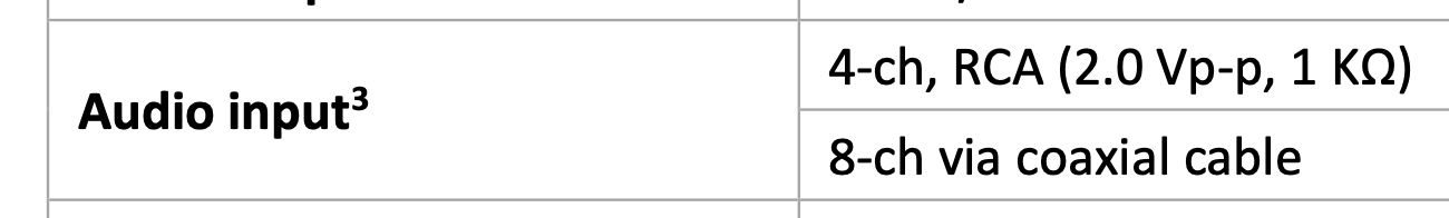

Edit: The below snip from the data sheet for your model seems to indicate that you've got AoC. The number of separate audio RCA inputs is optional along with alarm inputs (the number 3 in the image pointed to a comment detailing that):
Thanks for that, so the 8-ch via coaxial cable - is the part that pretty much means all 8 can be aoc (maybe provided you turn the poc part off) - maybe
The ports sense whether there's a PoC camera attached or not and disable PoC if the camera doesn't support it. There are no models that support both PoC and AoC so it shouldn't be an issue.
