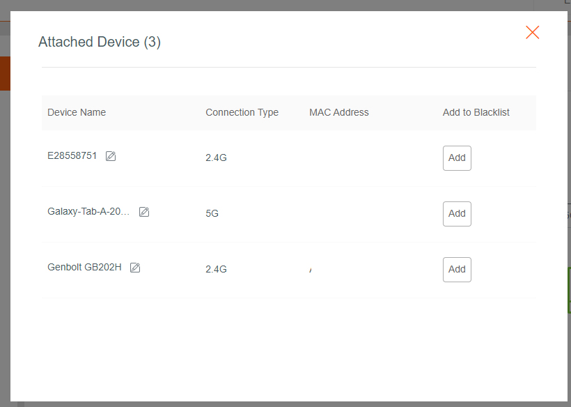

I have my EZVIZ CS-CV310 camera running under Blue Iris. The camera was working and then suddenly failed to connect. I unplugged the camera and plugged it back in, as sometimes this works for me, but it still didn't find the camera. When I run the EZVIZ app off my phone the camera is detected and running.
I logged into my router thinking maybe the IP address for the device changed.
The camera is running through my BrosTrend WiFi Extender. When I login to the BrosTrend WiFi Extender it lists my device with the matching MAC address. (picture included)
When I login into my router the IP address the camera was using is listed but it is listed under the MAC address of the BrosTrend WiFi Extender. The MAC address of the device itself is not listed under the router. I did not notice another camera I have that is using the BrosTrend WiFi Extender, and is working, is listed under its MAC address on the router as well as its IP address under the BrosTrend WiFi Extender.
So my EZVIZ was working fine and then suddenly failed to connect under Blue Iris when previous to that it was working fine for months. The camera is still working and running under the EZVIZ app but not under Blue Iris any longer.
Any help would be most appreciated. Thank you.
