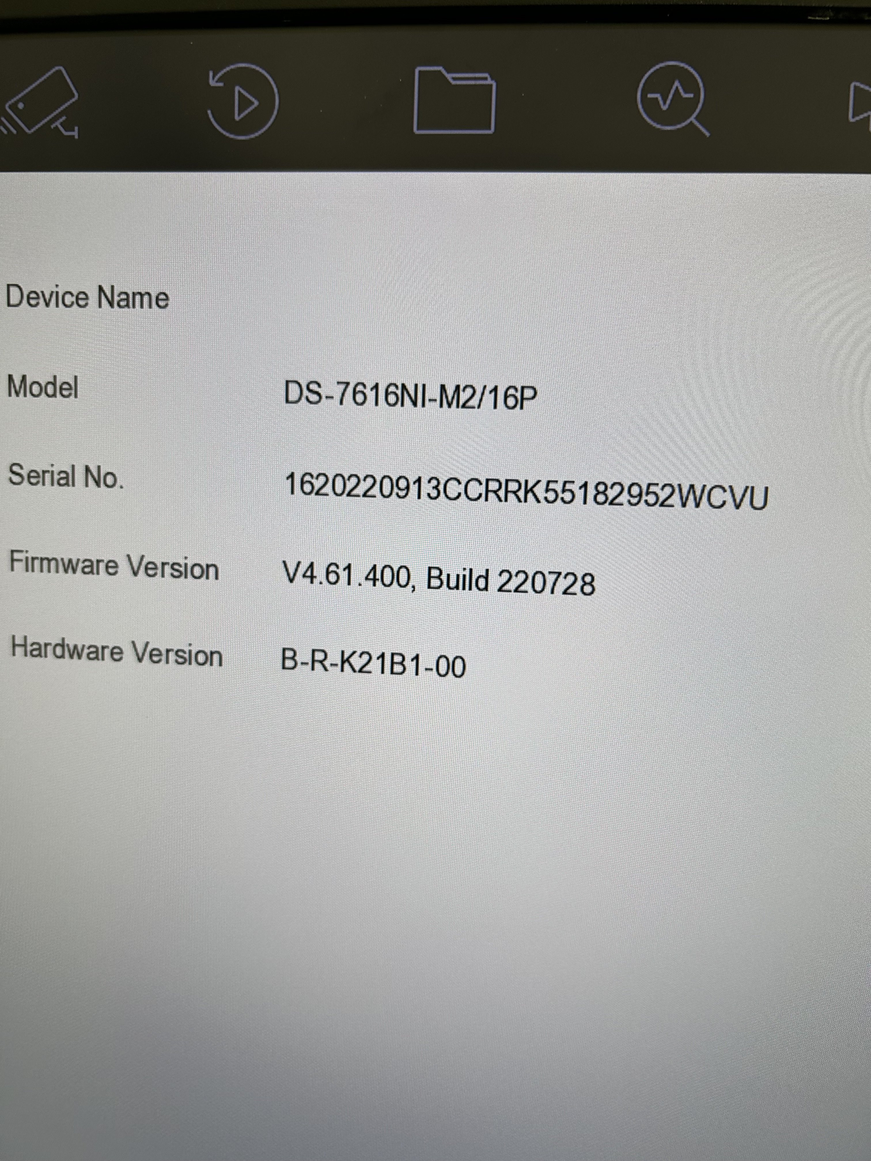

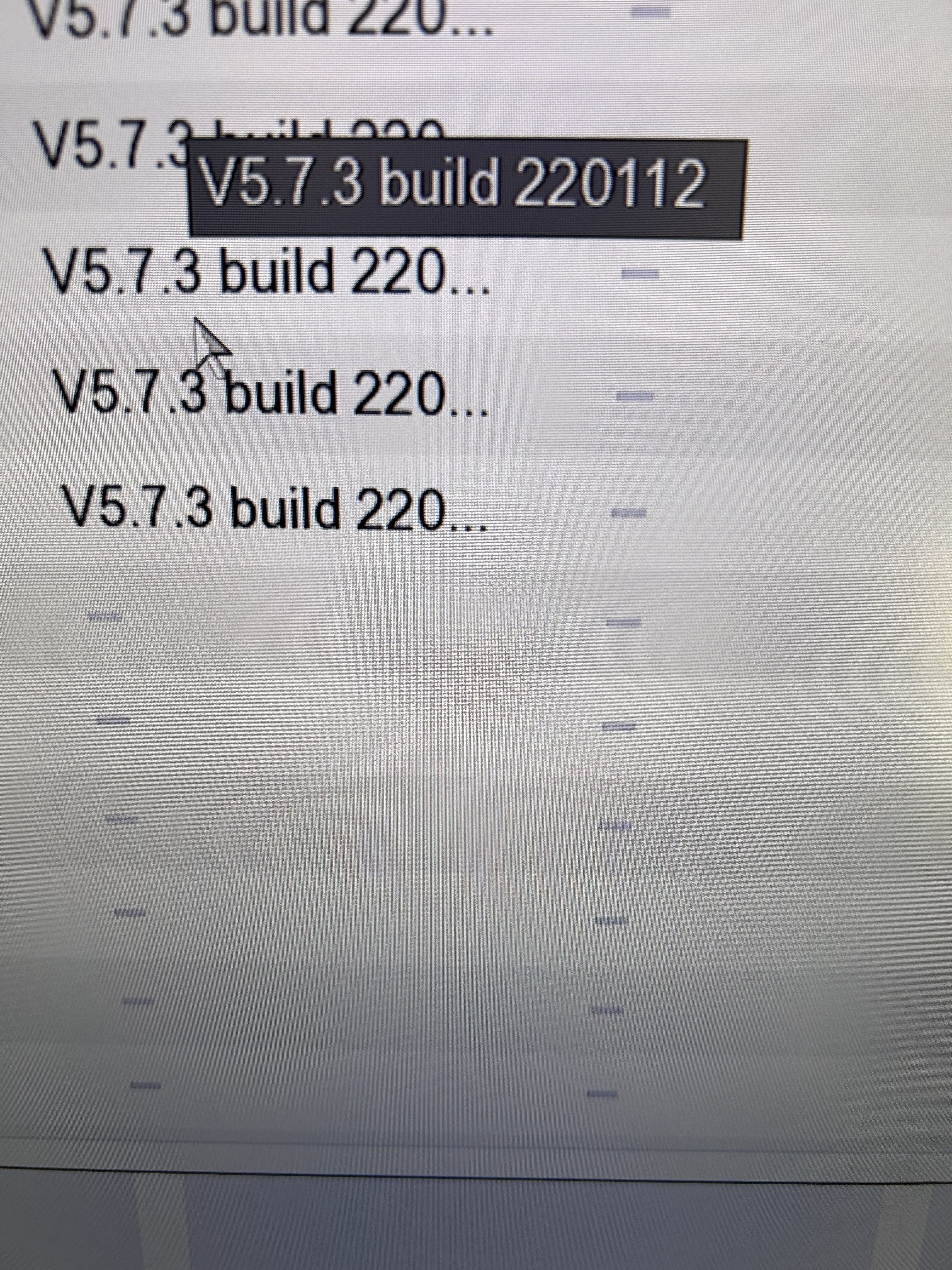

What firmware versions are the NVR and camera currently using?
In the image settings for the camera, what exposure time is the camera currently using?
Hi @Kilojade

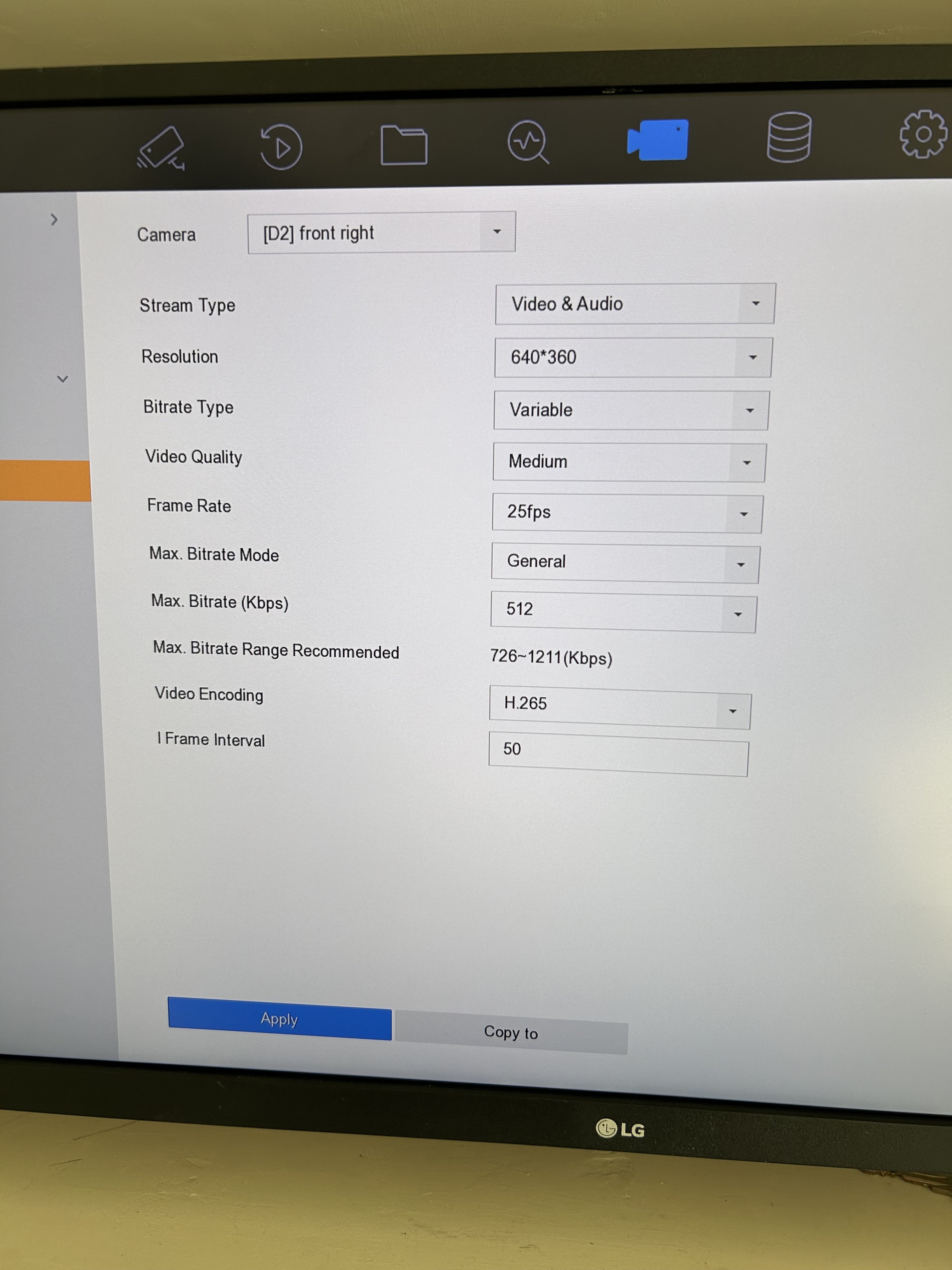

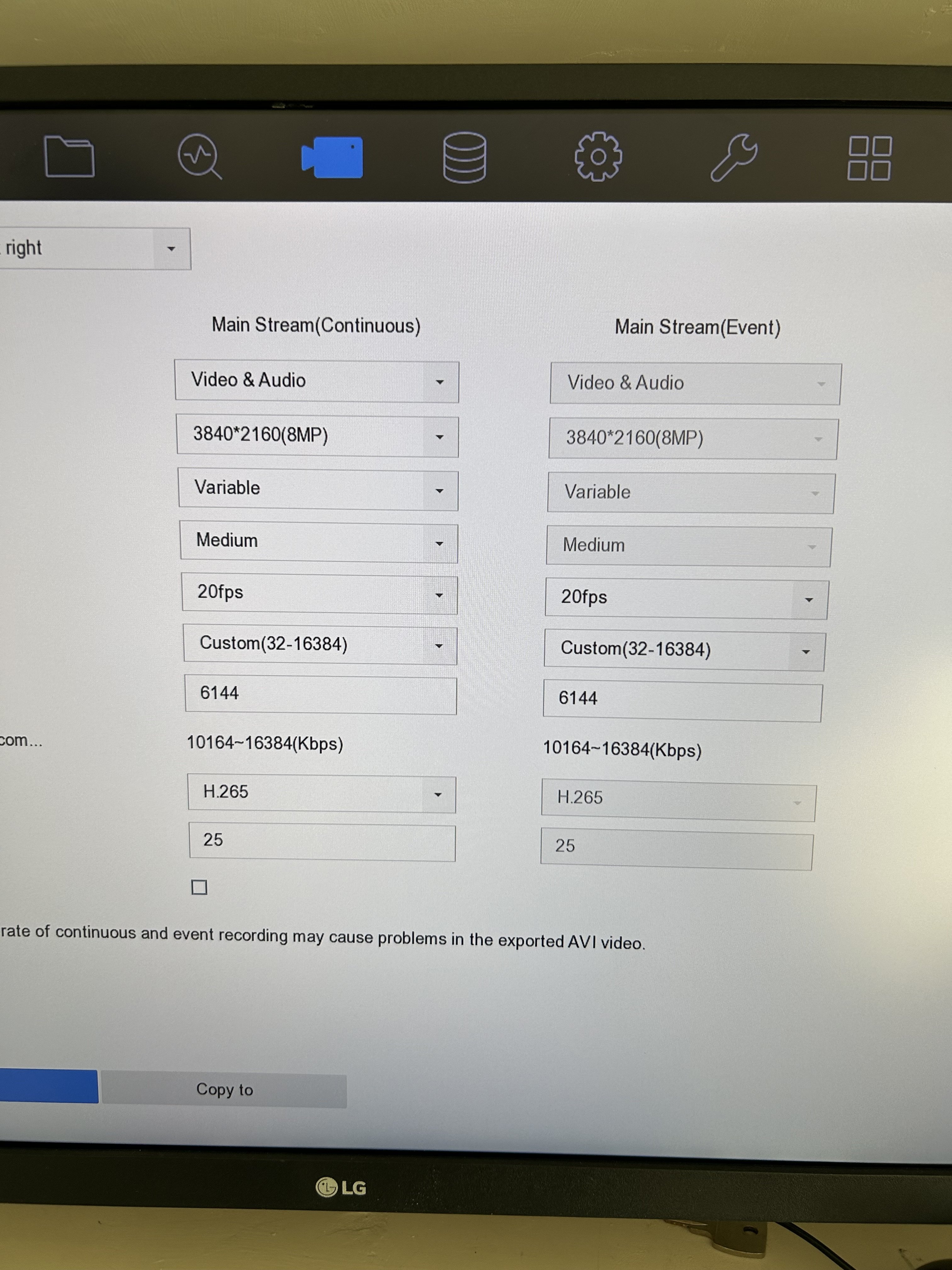

Hi, exposure was 1/25 but I just changed it to 1/50 seems abit better.
Info attached.
Info
Info
Thanks @Kilojade
The latest firmware versions are below:
NVR - V4.63.020_230808
Camera - V5.7.13_230706
using a faster exposure time/shutter speed like 1/25 or 1/50 will have the greatest impact on reducing motion blur, but you can also try disabling image settings like DNR, WDR, HLC, etc... to make further small improvements.

Ok thanks mate. What settings make it less jittery? Like if a person walks past it’s not smooth just abit jittery.
