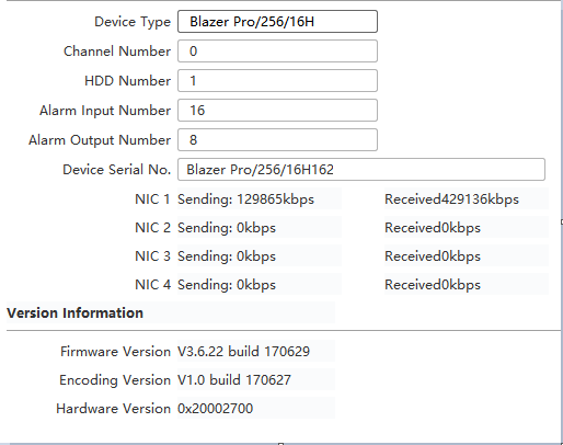

Could someone help me. We are facing restarts on our Blazer Pro.
Every hour or so.
I want to upgrade the firmware to the latest one.
Do you know where I can download the mentioned firmware?
At the moment we have the following:
Here's a link to download the latest available firmware (V4.40.500_201020) via WeTransfer - NVR_X50_BL_ML_STD_V4.40.500_201020.zip
Provided to me this morning by Hik Tech Support
I hope that helps
