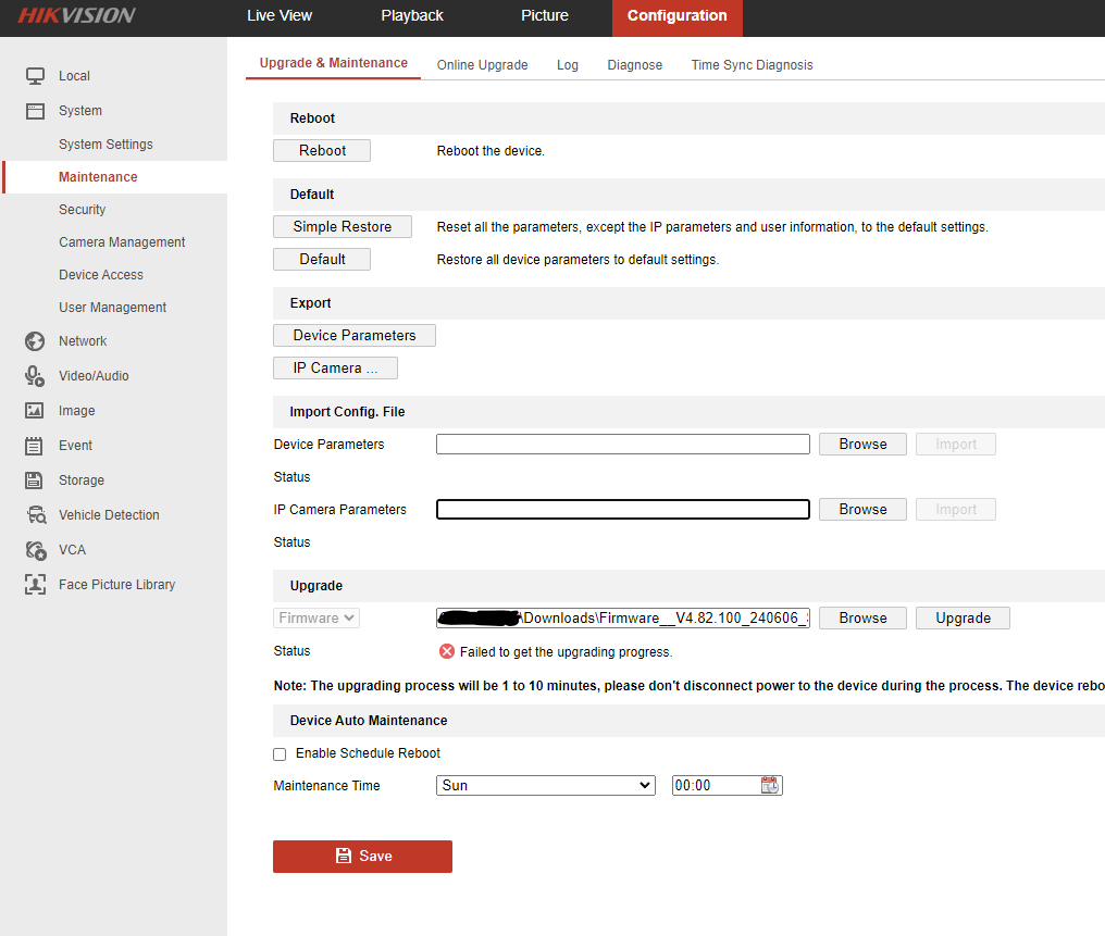

Can you share a screenshot of where you were trying to load the firmware?
Are you unzipping and loading the 'digicap.dav' file?
Hi @Dan, yes that's right, the same way I did it for the cameras. Here's a screenshot

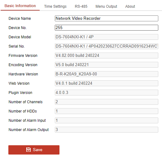

Can you please go to System > System Settings > Basic Information and share a screenshot of this page?
