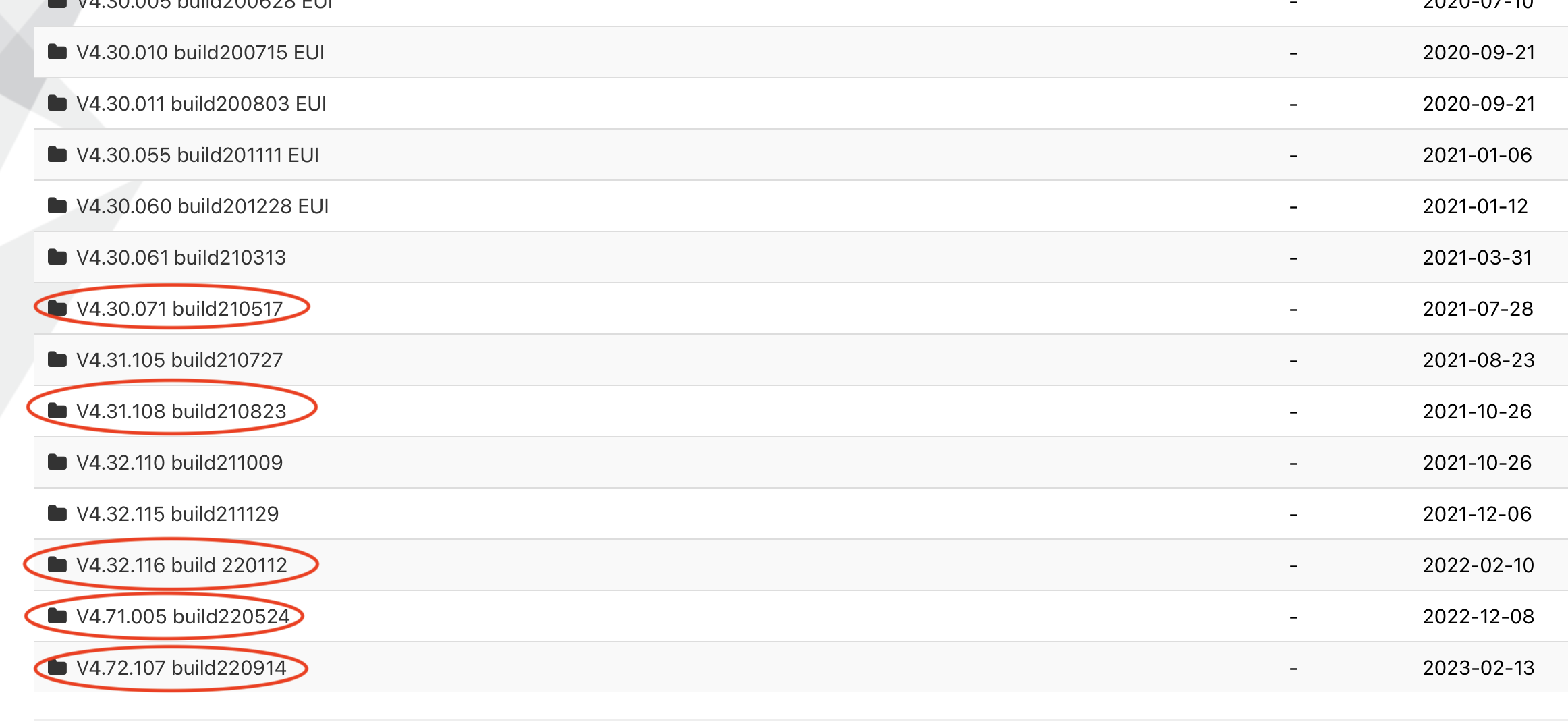

You've got the wrong model yours is not a D, it's one of the original ones by the look of it (you can see your build in the screenshot). Give me a moment and I'll send you a link to the correct page....
Here you go:
I would just install the versions highlighted in the screenshot below:

When you have your NVR up to date - your camera firmware its also a way behind. Luckily on that one you could just jump to the latest (and final) version for your G3 platform AcuSense turret. 5.5.801 is here. You'll need to log into the camera directly with a browser to to do the update:
