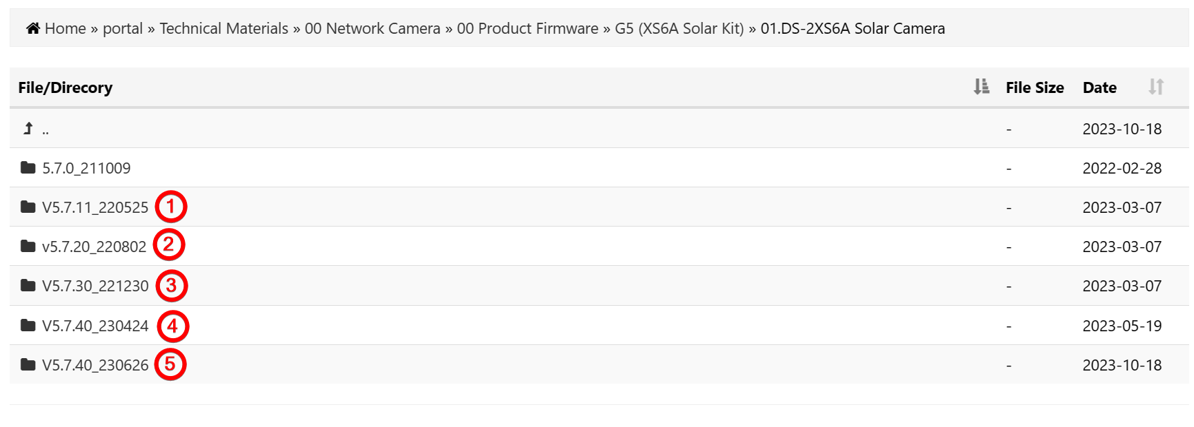

I understand that the device FW needs to be upgraded sequentially and also has to be region specific. Can someone help me locate the next FW version for the camera to get it to minimum V5.7.10 build 220409.

The firmware released for the DS-2XS6A87G1-LS/C36S80 can be downloaded here.
To be extra-safe and update incrementally, I you will need to do so in these steps:
Then, all new firmware will be available in the download centre of Hikvision's product page for the camera :)
