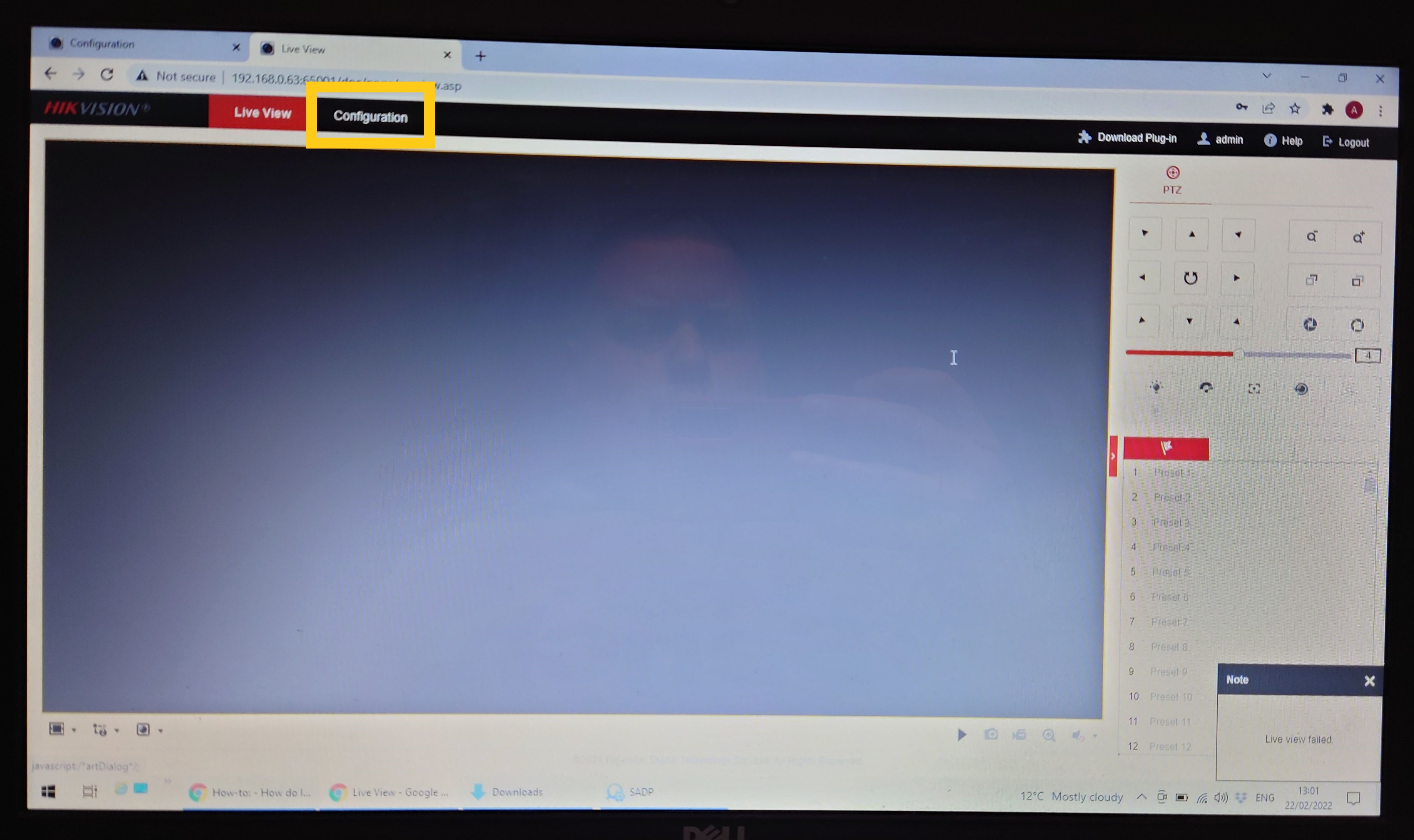

yes connected directly.Presumably your cameras are directly connected to your NVR?
If so, you will need to enable Virtual Host on the NVR, so that you can then access the camera's settings, and flip the image:
How-to: - How do I use a Hikvision NVR's "Virtual Host" feature?
One of the most successful selling points of a Hikvision NVR to many small-setup customers is the "Plug and Play" functionality that simplifies the setup process of their surveillance system. However, plugging a camera directly into a port on the NVR, unfortunately, does not allow you to access...forum.use-ip.co.uk
sorry missed that, many thanks,Click the link in my first response.
You will find a 'How To' tutorial there.
