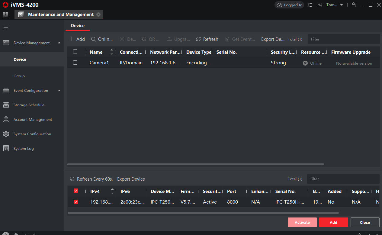

Image attached, not sure if I should paste it in? The activate camera button is greyed out.
Thanks @tmarsh
It looks like the camera is inactive, you can usually activate Hikvision cameras in iVMS-4200 but by the looks of it you can't activate HiLook cameras like the one you have.

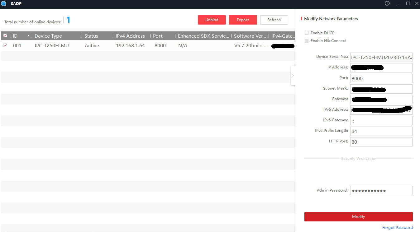

I can't do anything in SADP, I tried enabling DHCP (read somewhere that is what's needed) but when using modify it times out.
Okay,
The camera is showing as offline in ivms-4200 and the IP address it is displaying in SADP looks like a default one.
Use Command Prompt on your Windows PC to confirm your network range, if the IP range of your network is not 192.168.1.xxx then you will need to change the IP address of the camera in SADP.
Yes that's my range, I can log in to the camera on a browser on that address.

Hi. Hard to know what's going on! I enabled DHCP on SADP and couldn't get a login via browser. I disabled DHCP and now have a live feed on the browser. Camera still showing inactive on IMVS with no way to activate. The only thing that has changed is the camera now has a new IP address. At least it's working, if it continues I'll not worry abouit IVMS.
