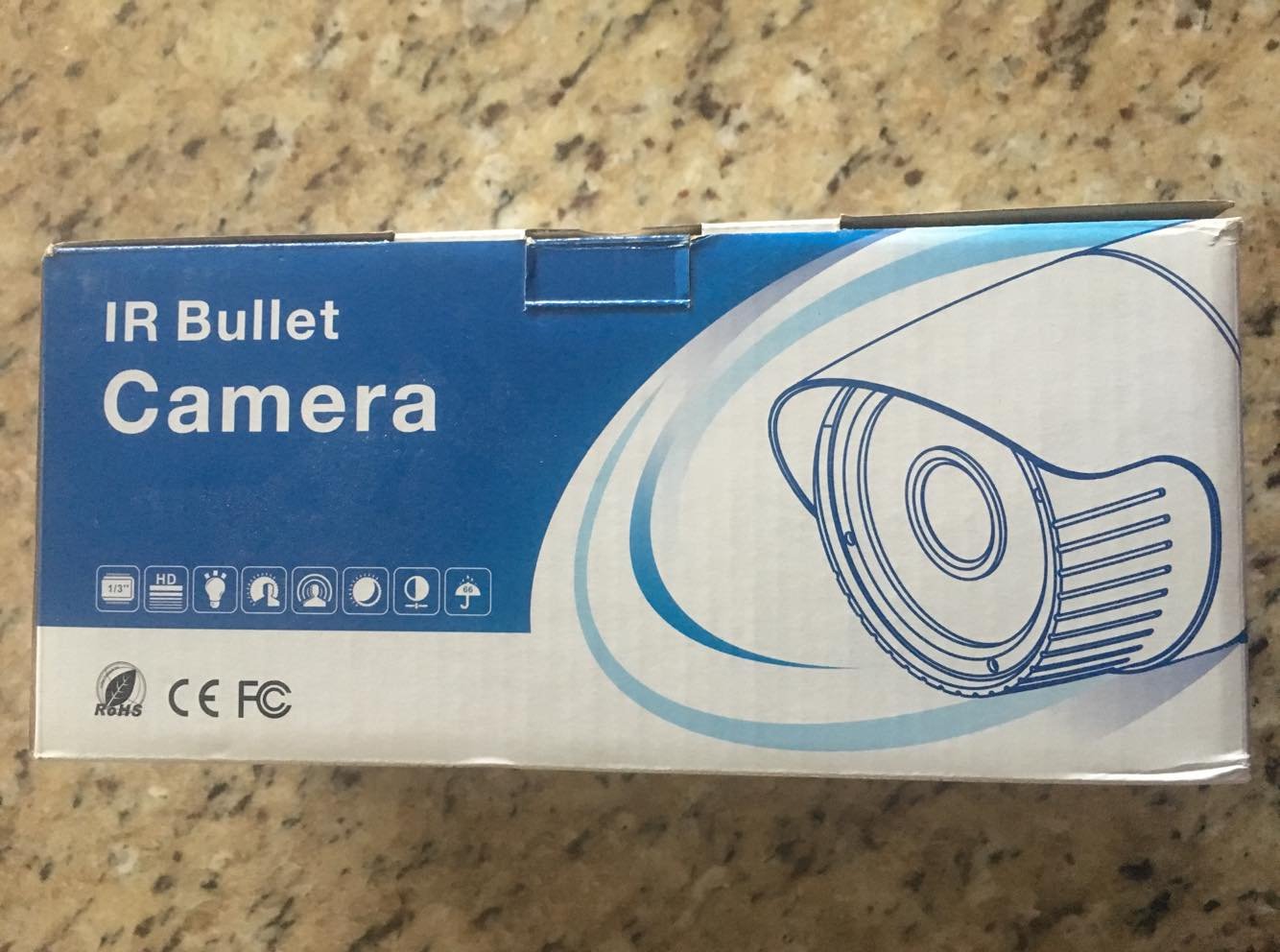

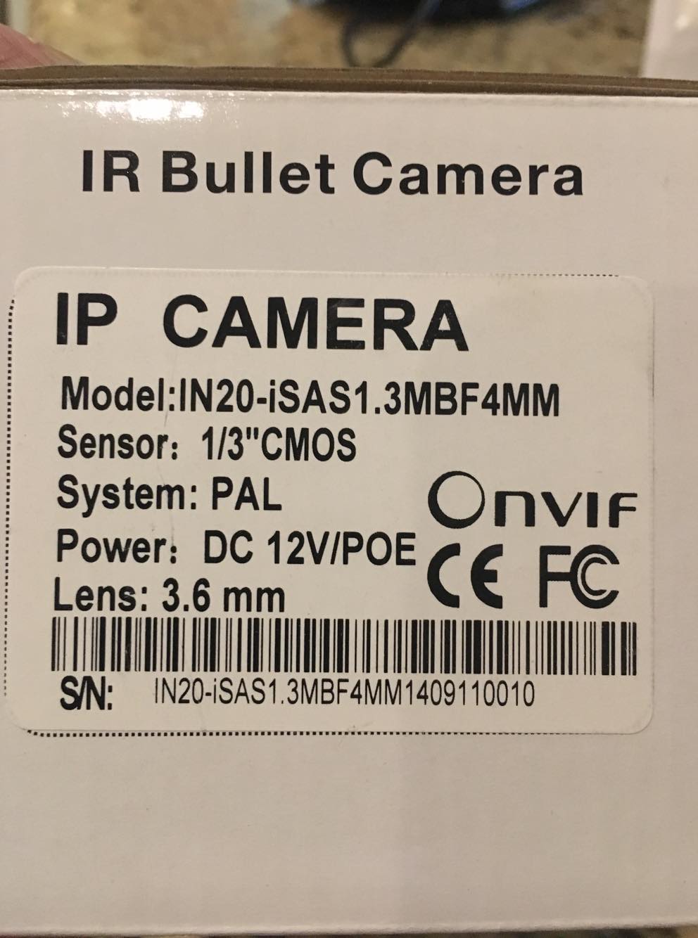

Thanks for the reply. I do have the software utility, but when i plugged my laptop into the same (POE) switch as the camera, and scanned for it the software never picked it up. I'm not sure if the cameras have a label or reset reset, I never looked and haven't been back onsite since, but will check next time I'm up.. See the image below if that is any help?
Thanks Paul.

Hikvision NVRs are nutritious for being problematic connecting to third party IP cameras. I tend to find the more "universal" NVRs (IE unbranded, or not a big player) can be better if you would like to keep the existing cameras. Ive had many a headache over this!
Funnily enough, I believe ive come across this camera before, and believe it was paired to a "xmeye" NVR. Not that it helps now!
You can get various IP camera discovery programs - I tend to use CMS which is a really terrible CCTV NVR software for windows. What it does do though, is ALWAYS discover unknown cameras. It is one of those headaches you come accross being an installer!
Ive just checked your datasheet and it does list the chinese CMS software.
Let me know if you need a copy - this SHOULD be able to reset any password stored on them. They are indeed netsurveillance chinese stuff.
