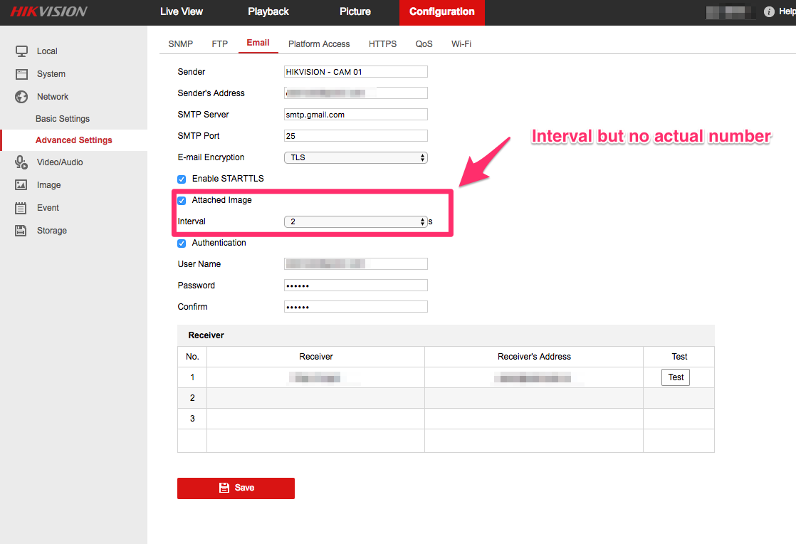

The only thing I've left to work on is why it emails me three images in particular. Where did it get that from?
I have settings to take 10 snapshots at a second apart but I still get three. Wierd. Any ideas?
Hmm, I thought three was standard, didn't know you could change - not seen settings as you describe?
Yeah it's interesting. If three is standard, then where is it specified? It must be a system setting which the end-user can't over-ride.
Email images (see screenshot)
We can enable Attached image and an interval but there's no mention of how many images to attach.
I think this is a badly missing feature.

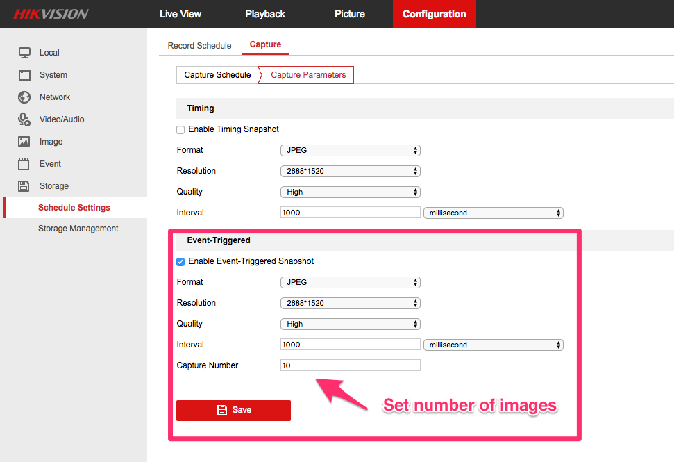

General Capture (see screenshot)
I have specified 10 images upon motion detection. Upon review it seems these are storage specific though (my bad) and not connected to the email functionality.
