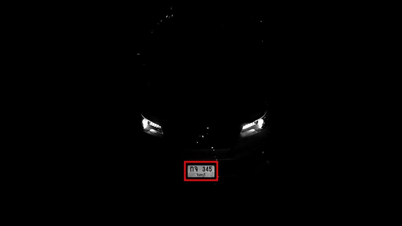

Your shutter speed is still too slow , if you are able to see anything else besides plate and lights.
Keep pushing shutter until result is PLATE + LIGHTS everything else is pitch black
Something like this
What you need to understand, ANPR cameras are not meant to be for general CCTV purpose. if you want a nice view for recording and ANPR in same time, you need 2 cameras instead of 1 with different settings.
