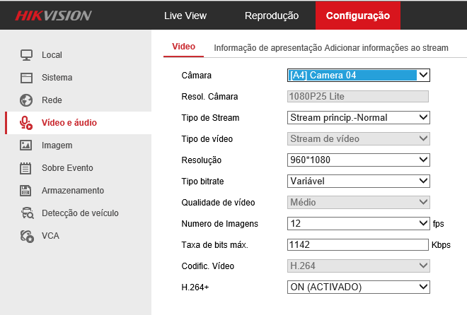

Are they all using that CODEC?
Sometimes, when you enable advanced CODECs you'll see a warning pop-up that advises that some other features e.g. analytics cannot then be used with the advanced CODEC.
I think the firmware version shows when you select System at the left side.
