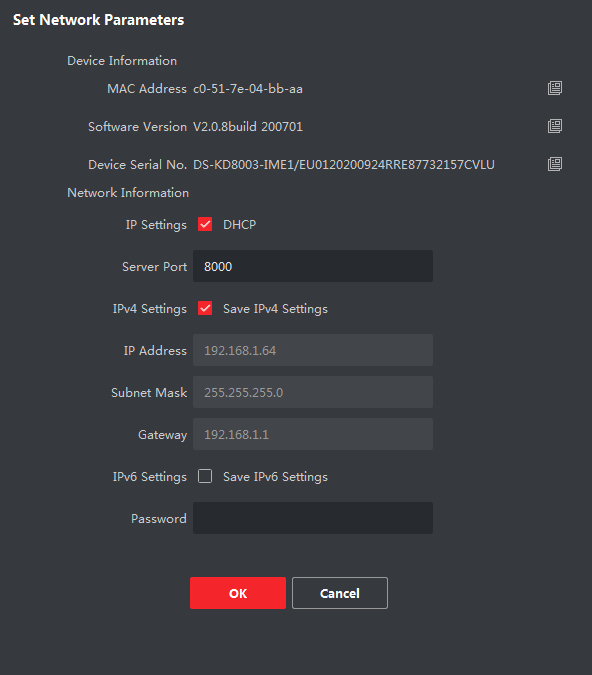

It looks as though it still has its original IP address as it's visible at the bottom of your second photo at 192.168.1.64. Delete the entry at the top, click the refresh icon at the lower left, then add the online device. You may not need iVMS to configure it . It might be possible to login to the device using a web browser. If so, you can reconfigure the IP address there and set it up for Hik-Connect (I'm not familiar with the model so can't be sure)

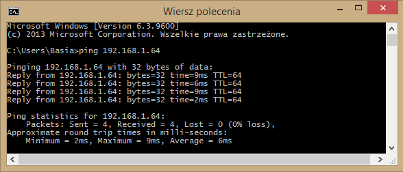

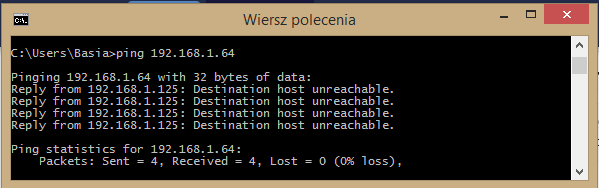

Thank you for your reply JB1970. I did what you advised. Now - IP address is the same but it is still offline, unfortunatelly...

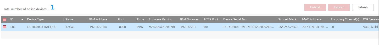

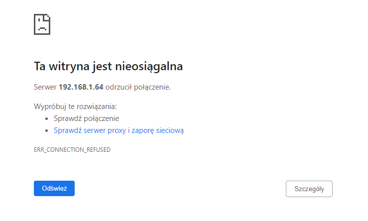

The device is visible in SADP as active, it is visible in Advanced IP Scanner, I may also ping it, but cannot open it in web browser for further configuration (by typing ip address bar).

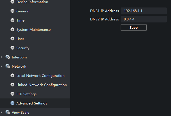

i heard that it can be caused by bad dns address, but to change it the device must be online... what did i do wrong?
As I said that device is possibly not configurable by web browser so that shouldn't be a problem. The device is activated (has an admin password that you've set) and is active at 192.168.1.64. If you haven't already, add the device so that it's at the top of the screen in iVMS (rather than just in the visible device list at the bottom). If you've already added it, click the edit icon and re enter the admin password in the pop up box then save.
Can you confirm that your home network is 192.168.1.xxx? If so and the device still shows 'offline', disconnect it and re run Advanced IP Scanner to make sure nothing else is already using 192.168.1.64 (or just ping the address with the intercom disconnected)
Regarding SADP...You don't need it. The 'online device' section at the bottom of the page in iVMS allows you to do the same functions. You can just double click the entry, change the IP address etc as needed (I'd usually set it high such as 192.168.1.250 so that it's unlikely to clash with anything assigned by DHCP). But you must also enter the 'admin' password in the same pop up screen that you enter the address, before clicking 'ok', otherwise the changed settings won't be applied.
Once you have it added and showing 'online' in iVMS, you should be able to click the configuration icon (gear wheel) and set everything up as needed.

Pinging result after switch off from POE switch in attachment (destination host unreachable).
In AIPS(Advanced IP Scanner) door station is greyed.

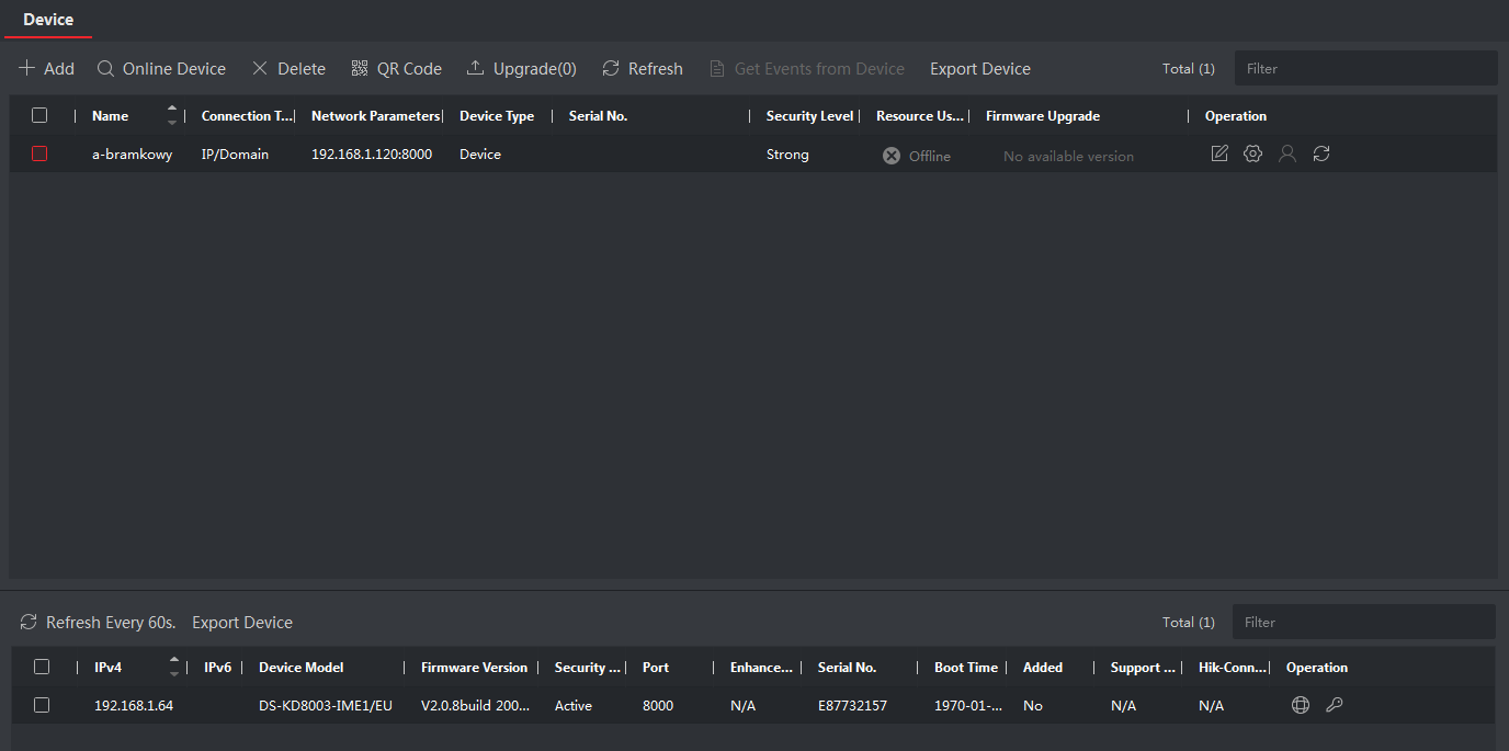

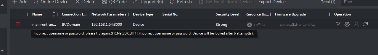

Interesting thing observed: when I hover over "offline" there is information about wrong password/or username.
Could entering the wrong password cause it to malfunction and stay offline of the device?
On the other hand - If I mistyped them, would the devices accept changes in the IP address? (and in fact it accept changes, when I entered the new IP several times for a trial, each time the input resulted in changes in the host configuration, at the bottom of the screen and at the top - after adding the device)
As far as I can see, there are two types of passwords: super user master password and device password. The documentation does not say exactly which password should be entered in which circumstances.
If the device needs to be reset to factory settings, is there any way to do it myself?

After editing (without changing anything) there is another monit in iVMS - network abnormal
Yes. I pointed that out earlier and detailed how to correct it in iVMS:
No. The admin password is required to affect the change. That is why the device was in the ‘discovered’ section at the bottom of the screen with its default IP address and ‘offline’ at the top of the screen with the changed IP. There was no device at that UP address as it wasn’t successfully changed.
No just the one. Super user has nothing to do with the device - that's the password that protects access to the iVMS app and nothing else. The password you need to enter in the device configuration, is the one you activated the device with
Finally - i manage to set it as an online. Thank you for you patience. Next question is - how to set it comunicate directly with a Mobile phone. Is it possible? Tutorials on The Internet use internal monitor to achieve that.

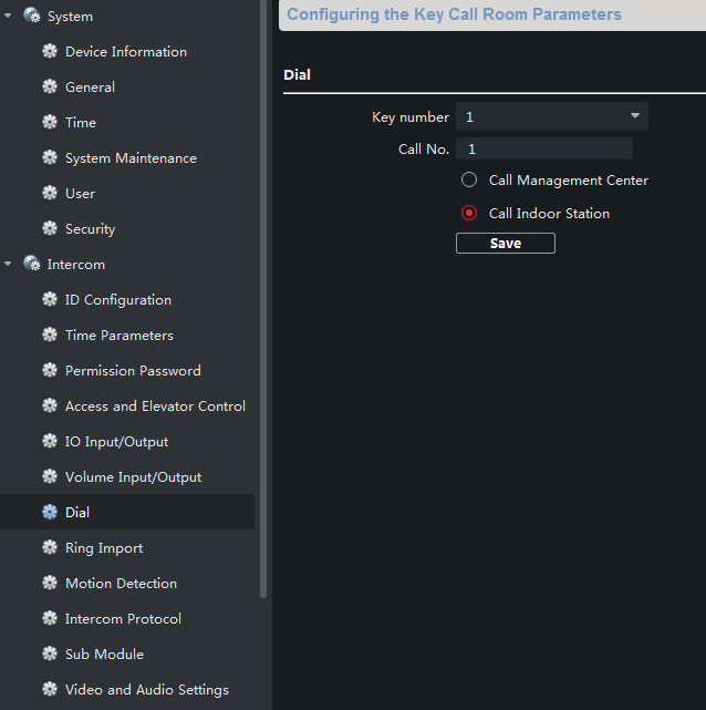

I must say that, I've already had installed Hik-connect, and added door station in it. There is also a preview from door station camera available. Should I delete it?
Unfortunately, In Network > Advanced I don't have Platform Access item, as you can see.
Furthermore there is Intercom > Dial section in which I can only choose two options: call indoor station or management center.

Modular outdoor intercoms don't have option to directly connect to platform. You will need to buy indoor unit.
Villa door station have options for platform access, but only model with one button. DS-KV8113-WME1
Yeah I wasn't aware of that but just had a scan through the user manual. I use a 6113 so don't have that issue.
Okay, in that case, I need to purchase additional hardware for this to work...
This would explain why the guides available on the internet show configuration with a telephone using an indoor station.
