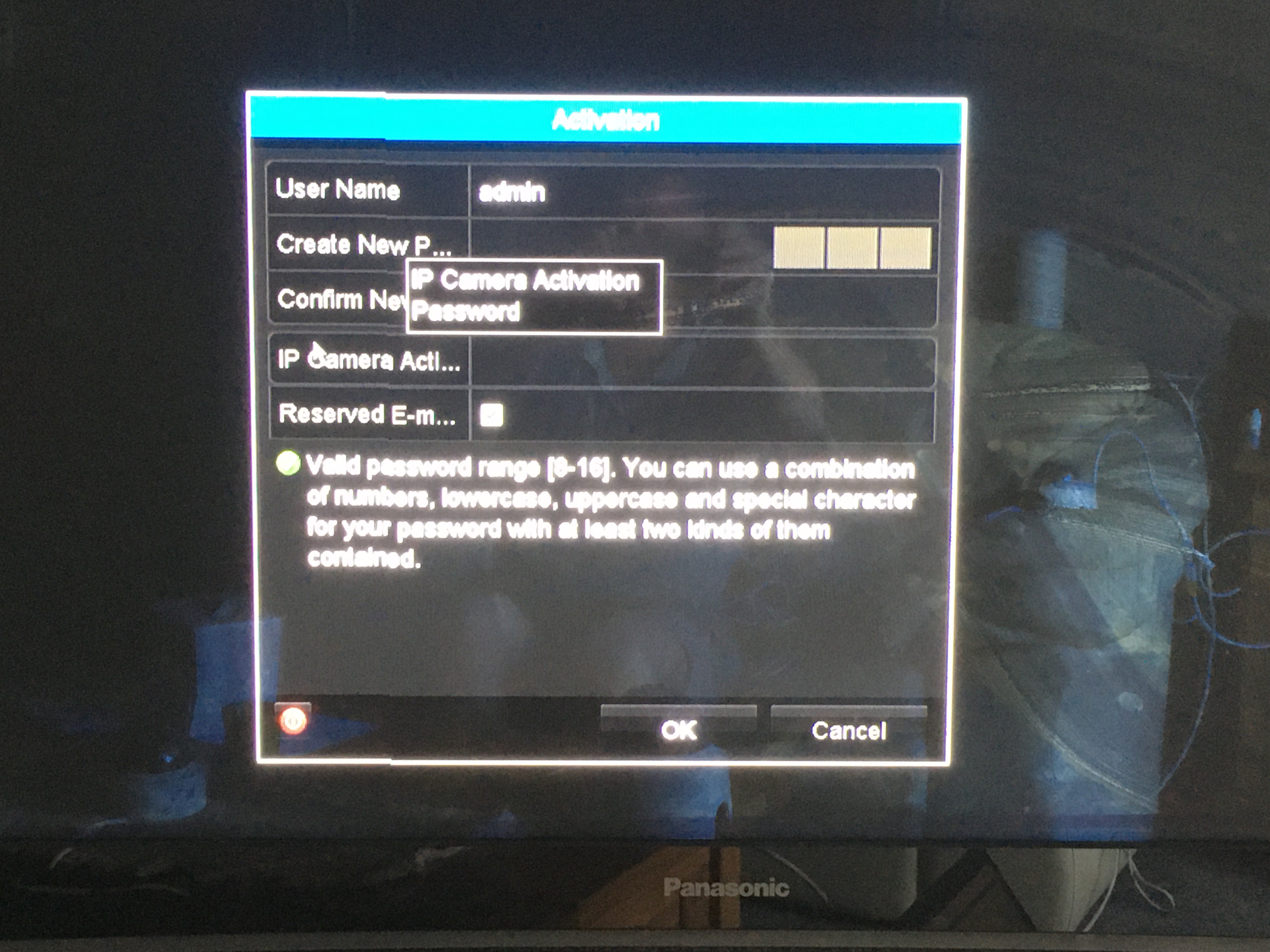

Have you tried setting the login password and activation password as the same password?
Is the password you are using strong? It should use at least 3 of the following - lowercase, uppercase, numbers, special characters
Hikvision has introduced security measures on their main line of NVRs which won't let you set weak passwords so this may be the same for HiLook NVR.
