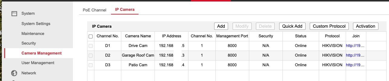

That’s why it’s showing security as N/A in the first screenshot. Because you’re using the NVR network, the cameras can’t be accessed within the house network it’s attached too, so doesn’t need IP password protection.
So do I need to reconfigure all the cameras to be on the home network? I'd have thought the logon for the NVR would work for the cameras as they are fully installed on the NVR and working? If that was done though would they still be able to link to the NVR for recording / playback etc?

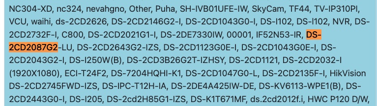

What camera models do you have? You say they are Hikvision cameras but above you say they are "DYN 7608NI cameras" which we have never heard of and nothing comes up on Google when we search for this.
Hmm that is what the NVR shows them as. The cameras are actually:

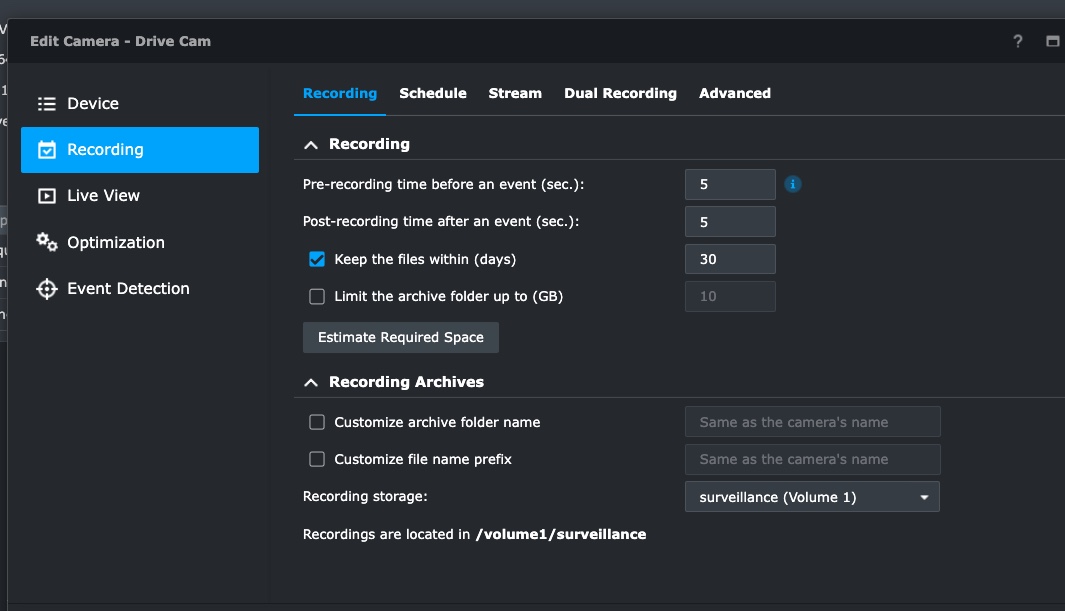

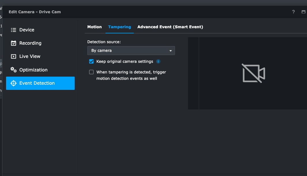

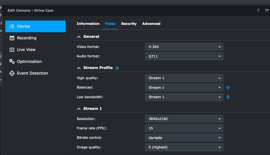

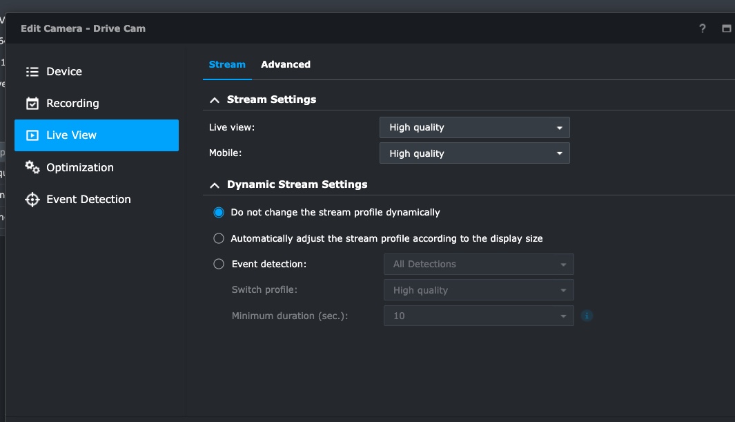

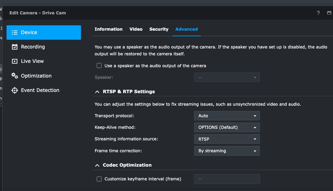

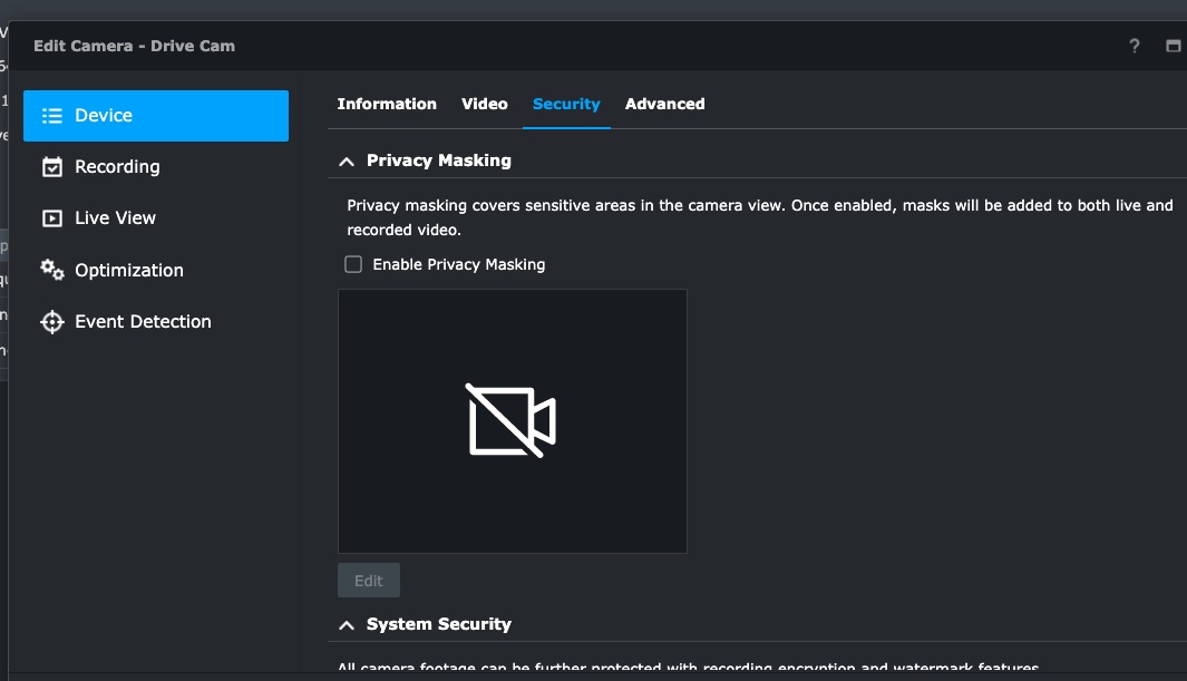

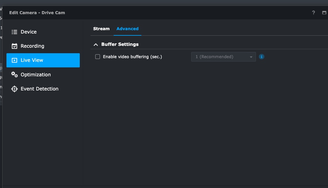

If it helps at all the SS settings are as below. I hope that may offer some clues?

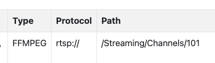

Says I should use the format of:
And using their wizard that gives me the rtsp string of:
rtsp://adminuser:adminpw@ip_address/Streaming/Channels/101
And yet again that gives me a No Response from the camera on the Home app on the iPhone.

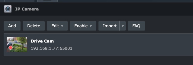

Using the Surveillance Station on the NAS I can connect to the camera as (i.e via the NVR and VM port):
With no problems at all.

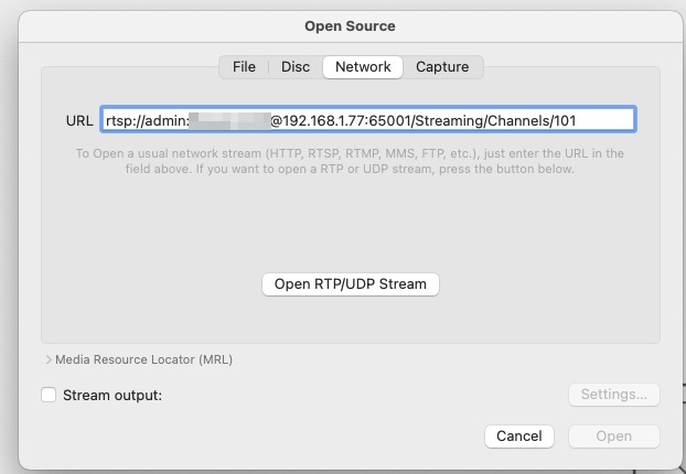

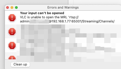

Right, so based on that and the wizard output from ipconnect and taking into account the virtual machine for the camera the stream should be:
rtsp://admin:adminpw@192.168.1.77:65001/Streaming/Channels/101
As the NVR is 192.168.1.77, the virtual machine for the camera is 65001, and the main channel is 101. So I put this into VLC:
And it fails to open the stream and gives me errors of:

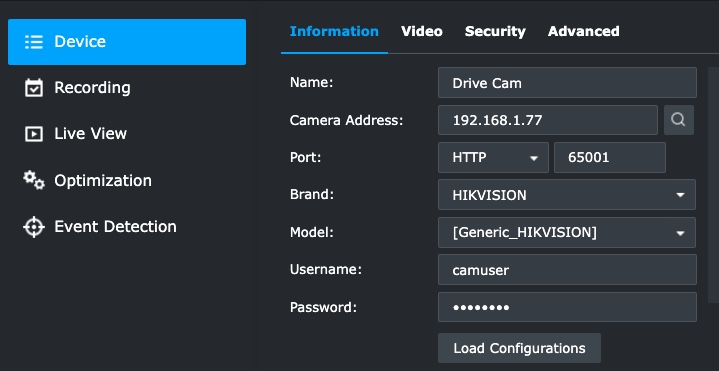

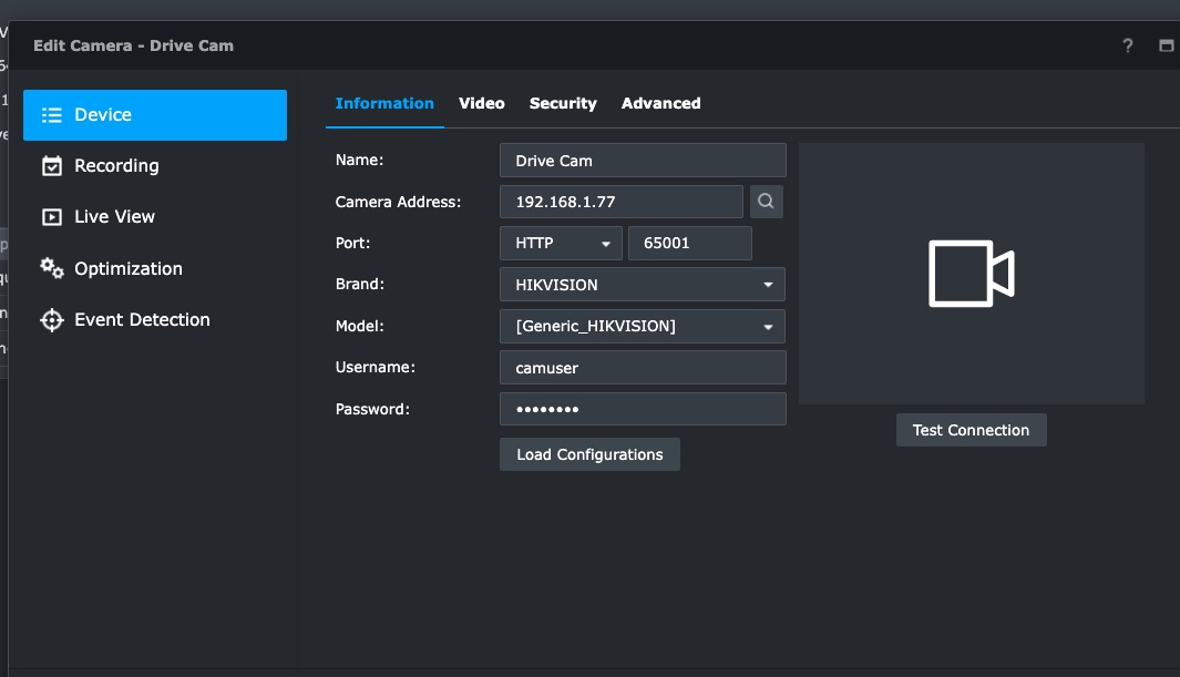

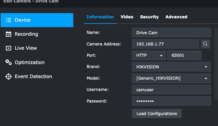

Even more annoying, that Surveillance Station on the Synology NAS has basically the same settings:
and works perfectly.

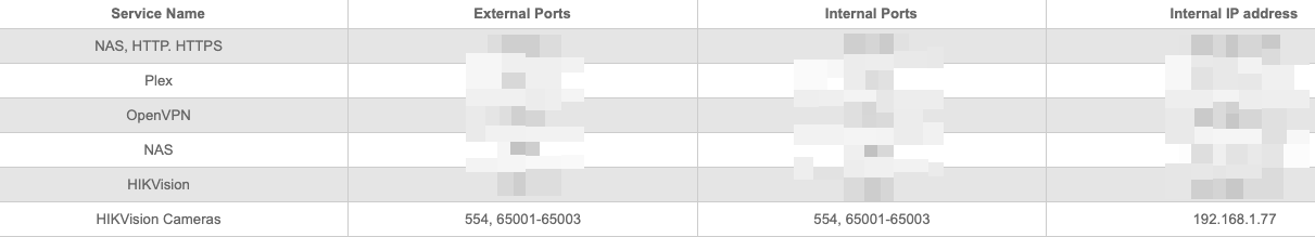

I'm now wondering if it is a network issue? I did have the RTSP (554) port forwarding to the NVR, I've now tried adding 65001-65003 to the forward as well (I did have that in place earlier but removed it).
Hmmm, still the same error.
Checking settings in the router again I've a static route telling sending Drive Cam (192.168.254.5) traffic to go via the NVR (192.168.1.77), I'll delete that as it should not be needed. Tried again:
I tried both the master NVR password and the 'camuser' login created for the camera still go and I get the same errors. I keep thinking there is something obvious I'm missing but I can't think what. If the 'same' settings work for the SS on the NAS then they should work in VLC?
You don’t need a port number in the RTSP stream when using the default RTSP port on the NVR (554), lose the :65001 from your address.
In this instance the stream is coming from the NVR, not the camera.
Port Forwarding is only for accessing devices from outside of your network, best practice would be to not forward any ports and instead use a VPN. You don’t need port forwarding configured for access ”inside“ the network. This is adding complexity which goes back to my earlier point, simplify everything, get your RTSP streams working in VLC and then granularly set everything else up/switch it back on, testing RTSP at each step. You’ll then find the culprit.
Thanks for that. I've removed the forwarding rules, as you say they are not needed.
Okay so I've simplified down to using the following, but if I do that how does VLC know which camera it is to access, as they are defined by the virtual machine ports of 65001, 65002, 65003 for each camera?
rtsp://camuser:password@192.168.1.77/Streaming/Channels/101/
For that VLC gives: VLC is unable to open the MRL'rtsp://92.168.1.77/Streaming/Channels/101/". Interestingly enough after I added it in I was prompted to enter login details via a dialogue box.
If I simplify further to
I then get: VLC could not connect to "92.168.1.77:554".
[Hmm just tried to access the NVR via the web portal and it tells me I'm locked out and to try in 17 minutes......] Which may be slightly positive as it shows I must be connecting somehow with VLC]
Now from reading what you have said above it looks like I'm still missing the (channel) and stream (main/sub). I'll look on the web portal once I can get back in to it and feed back.
Your examples above are missing the prevailing 1 from the 192. IP address.
The number at the end of the stream address determines the channel and stream, 101,102, 201 etc.
Since your connecting to a stream from the NVR you need to use the NVR‘s username and password, if you have a different username and password for the IP Camera that’d explain why your NVR has locked out, since VLC would have been pushing the wrong credentials to it. Which as you say is a positive in sorts as means VLC is attempting to access the correct source.
