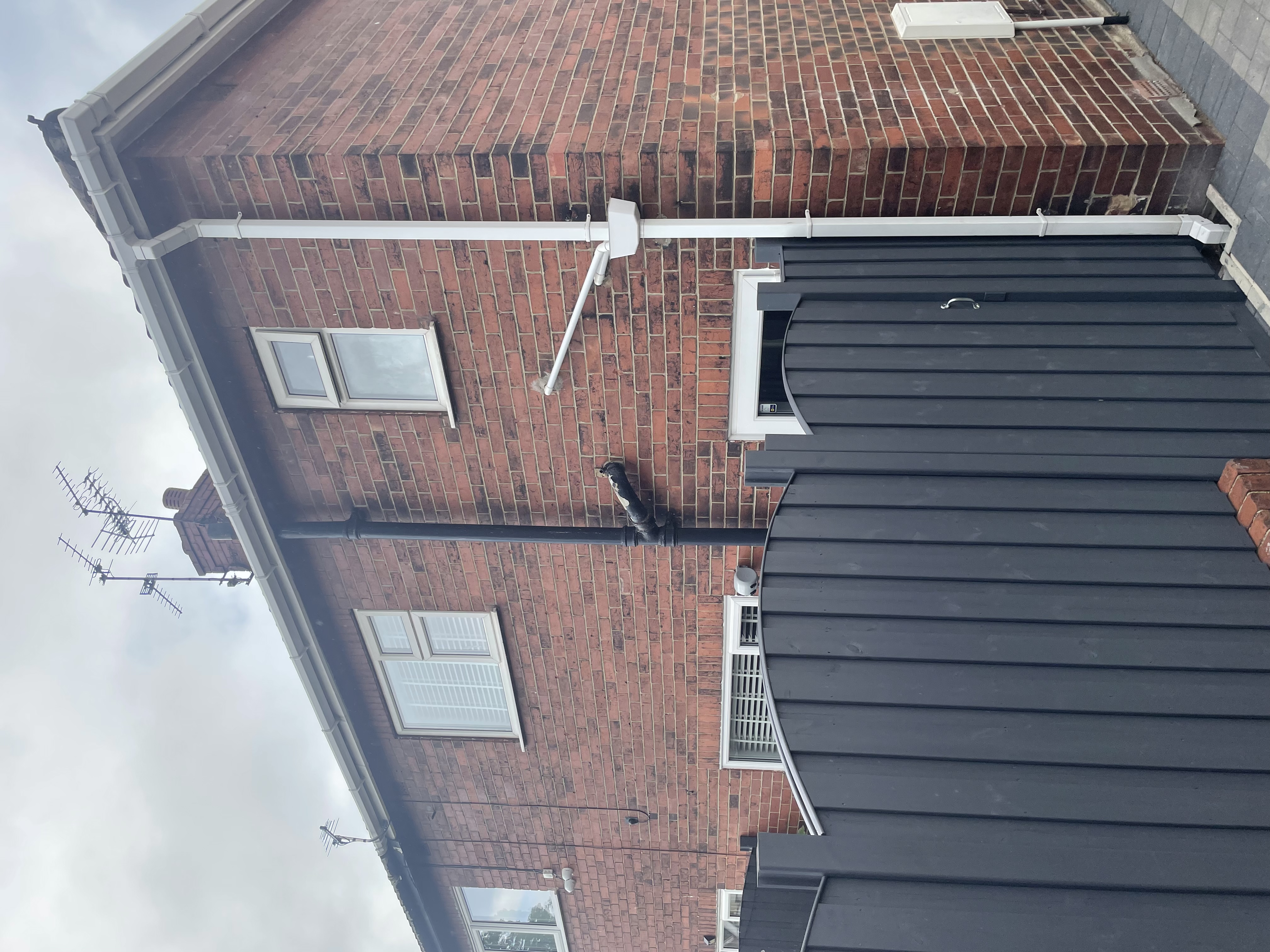

wires I love it to be simple as possible as I cannot run them into my attic due to it just been done out, so there going to have to run around my out side wall under the gutter and meet at the front of my house then down to the wall into a hole into my front room where the router is.

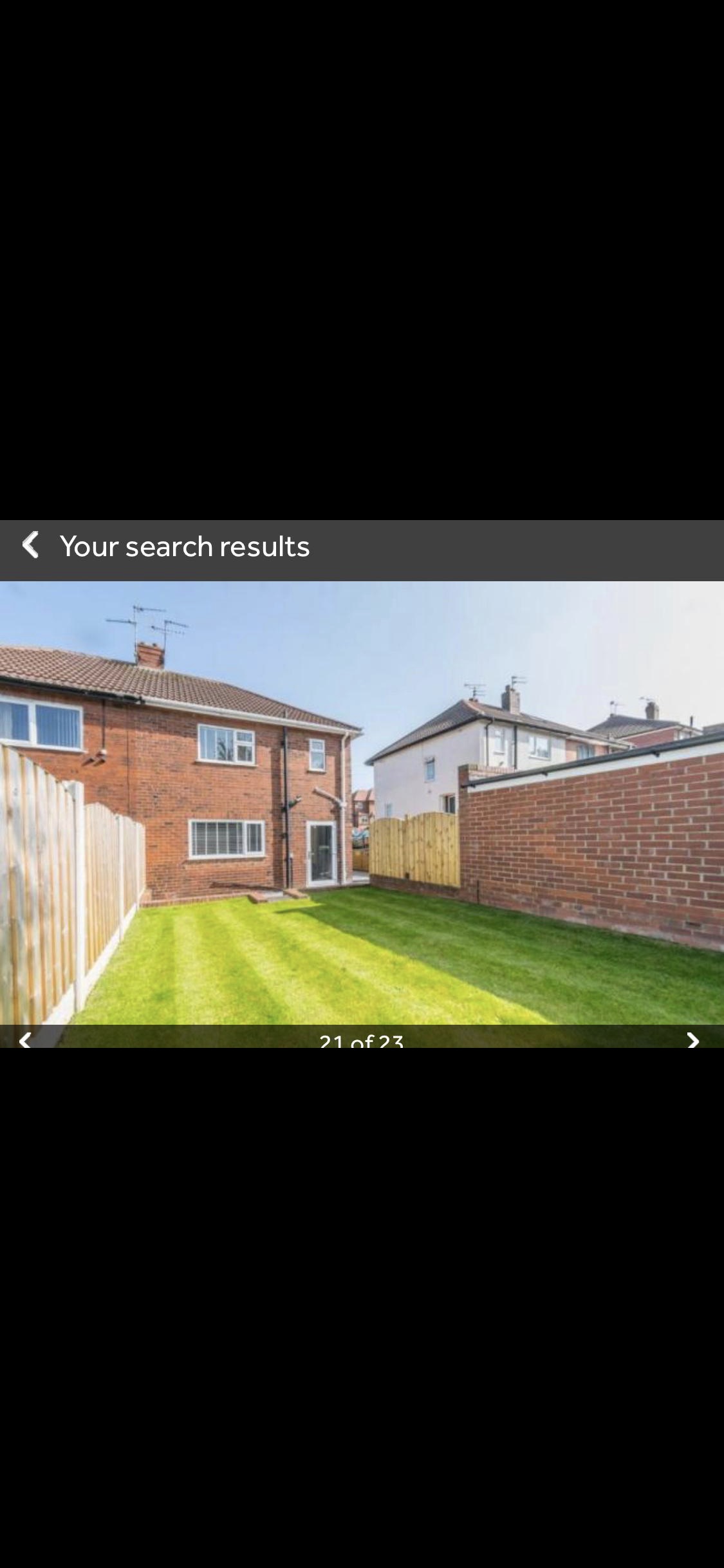

Back garden I want one camera in the far back corner looking down on my back door kitchen window and back gate but covers some of my garden that goes back 30ft has a garden light that comes on by a sensor

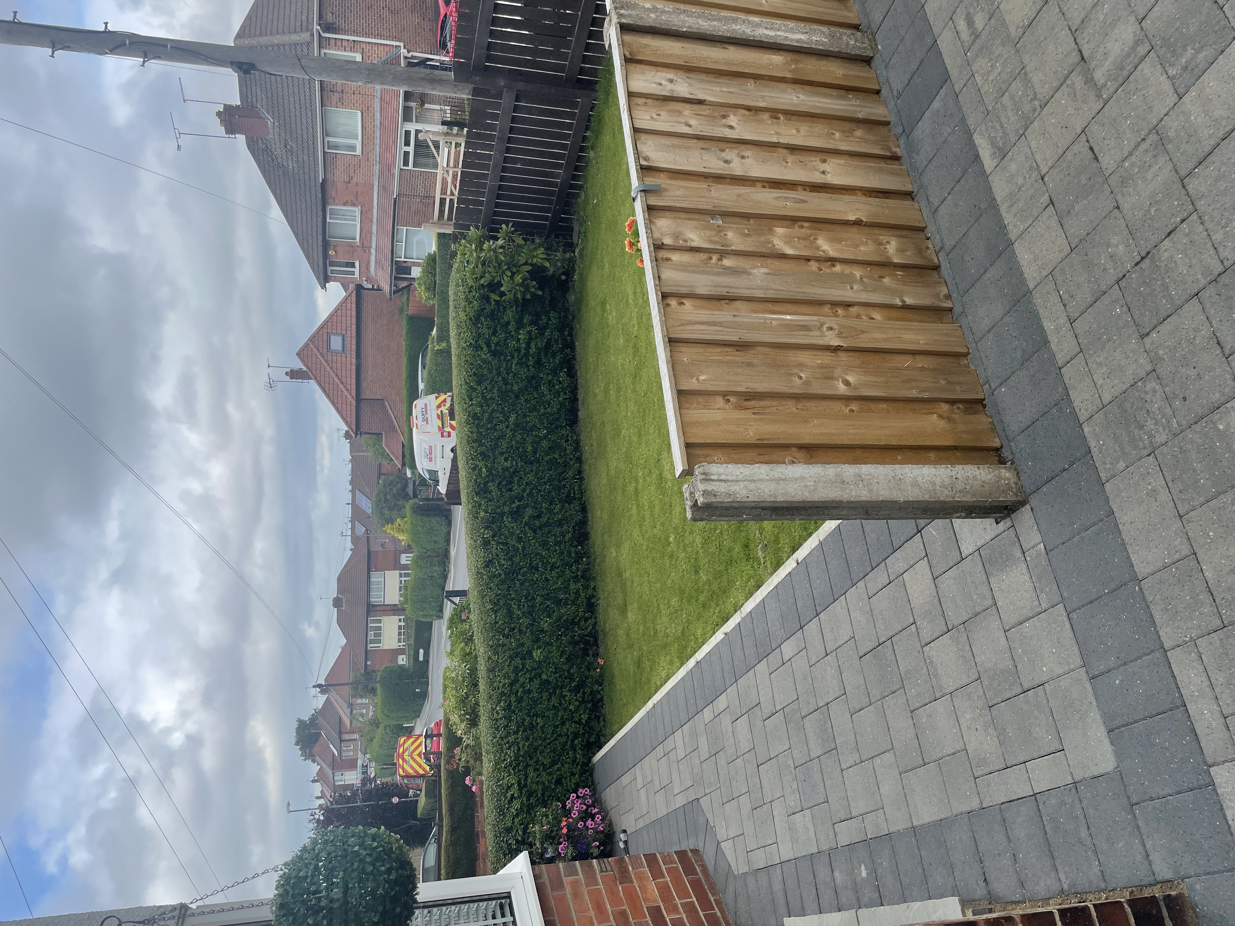

Side of house I want 2 cameras one at front looking up my drive to my garage and covers one car and back gate I have a LED garage light that comes on when it senses something. Other camera back corner looking down my drive covering both cars and front garden entry, no additional light apart from street light.
from of house far corner looking down into front garden, drive, car and covering my front porch, my porch goes back 4 ft so if never see anyone in there at my door but I’d see them going too it, porch also has an LED light on a sensor.

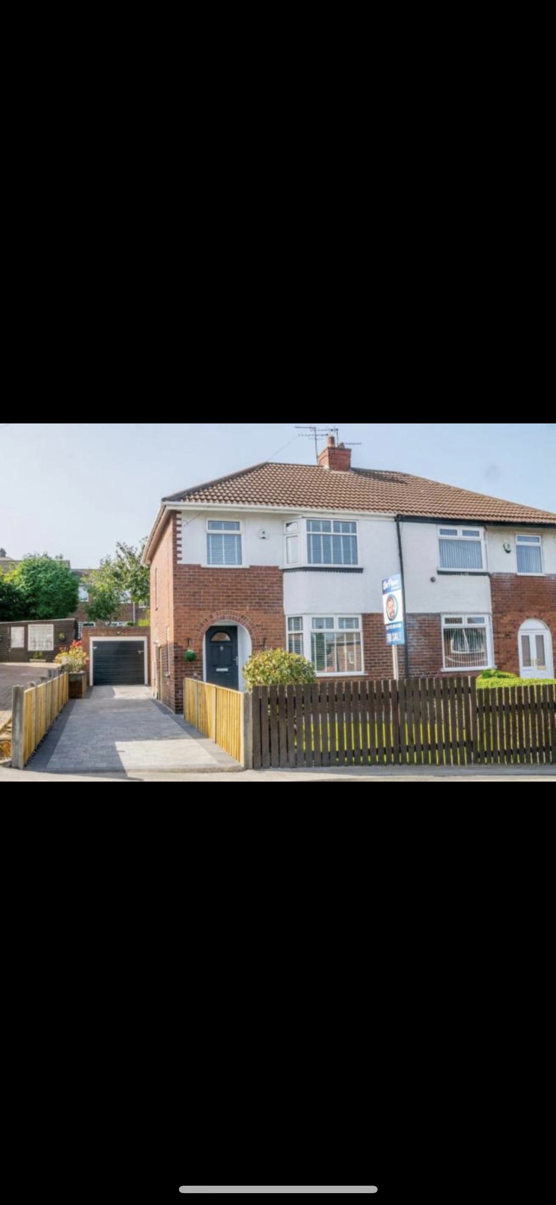

front garden is 15ft long and 15ft wide.

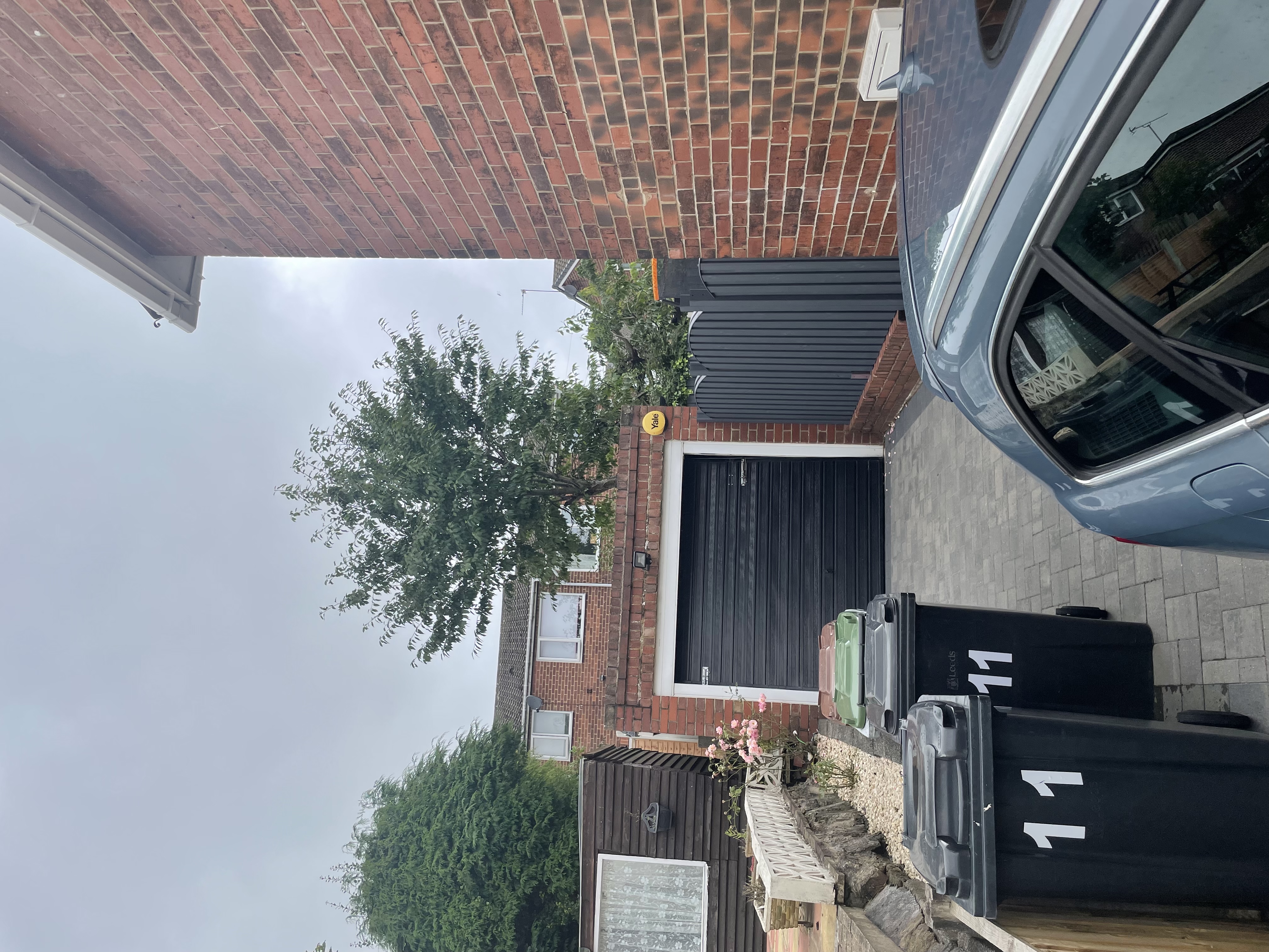

Drive is 60 ft long from garage to front and 9ft wide. I think ill need 2 cameras one looking up to garage one Looking down to front of my house

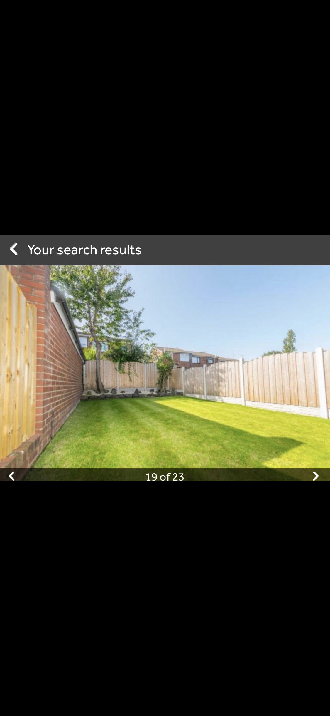

back garden is 25ft long by 15ft wide.
