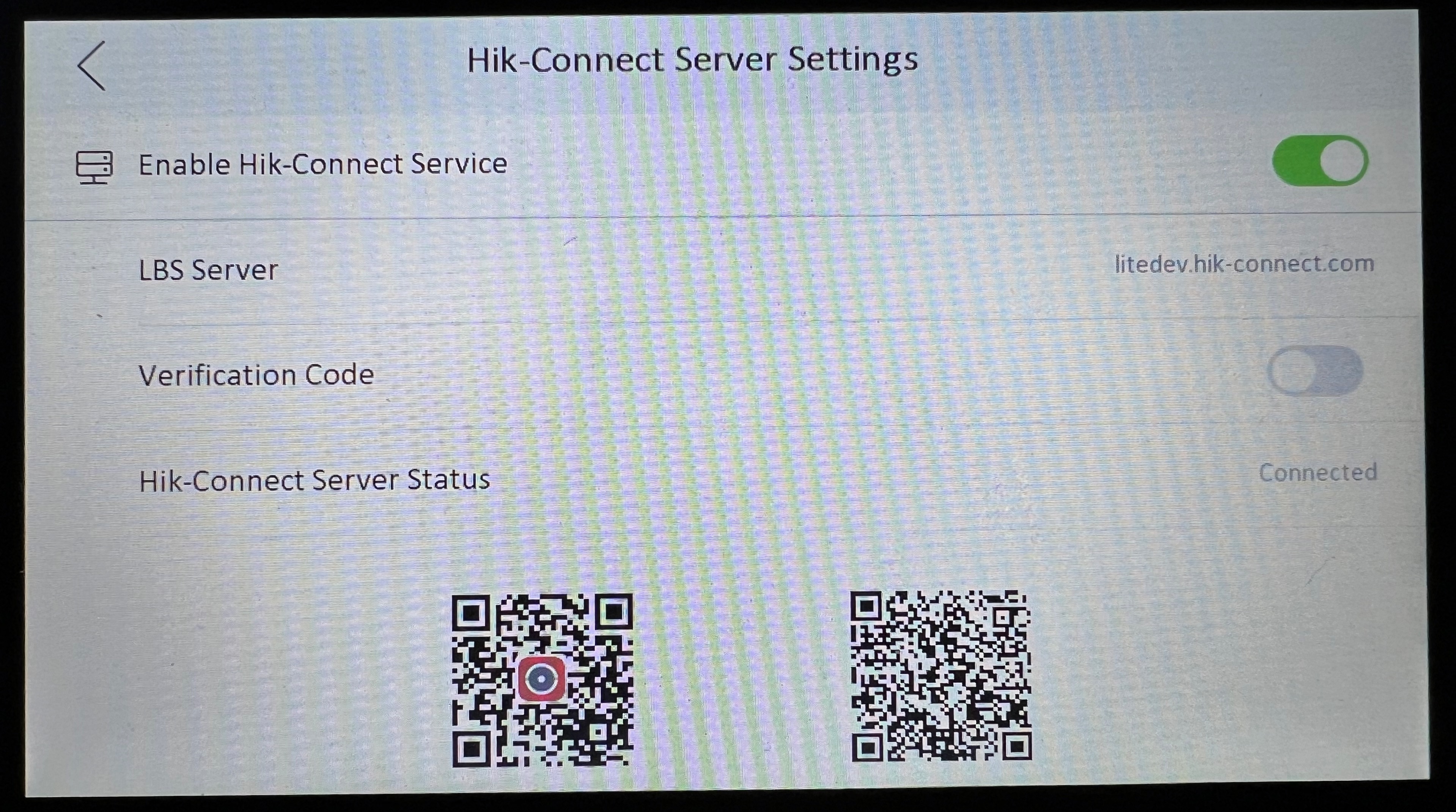

I'm trying to set up a video gate phone using a newly purchased indoor station (a DS-KV6113-WPE1(B) ) and gate station ( a DS-KH6320-WTE1).
I can't add the DS-KV6113-WPE1(B) to my HIK-Connect account. I'm asked for a verification code which I don't seem to have. I've done some digging and as a result have tried the following:
there's no verification code on the sticker on the back
I've tried 888999, ABCDEF and 123456 and a blank verification code.
I can't get into the unit via its IP address in a web browser - the connection is refused
I can't get in via ssh or telnet - the connection is refused
The HIK-Connect service settings screen is as attached. Toggling the verification code switch on and off doesn't seem to do anything.
The IP address responds to a ping. On the unit itself I can see that it's running firmware version V2.1.34 build 211118. I can see the gate station and view its video so am reasonably confident the networking is OK.
Any advice appreciated!

Thanks but I can't get into the door station except via its own front panel touch screen which has a limited menu.
I'm unable to add the door station to my HIK Connect account when logged into www.hik-connect.com using the web broswer on a laptop.
I can add it to the Hik-Connect app on my iPhone but when I select "remote configuration" the iPhone app says "connection failed"
When I try to add it to iVMS-4200 on my computer the application comes back with "unsupported device type".
