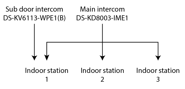

I have multiple indoor stations and two intercoms and I would like to have the following scenario.
The main intercom to be visible in all indoor stations and the sub door intercom only visible in one of the indoor stations.
Currently I was able to set up both intercoms, the main can call all 3 indoor stations and the sub door intercom can call only one "Indoor station 1".
I would like to hide the "Sub door intercom" in the other two indoor station so they cannot have a live view.
Is this possible, or only in Hik-Connect?
Thanks for the help.
Hi @hrvthzs
I don't think it is possible to do exactly as you propose, as the door station are different models, but you can put a second door station into "doorphone" mode so it only calls "Indoor Station 1" if both door stations are the same model.
This diagram shows how the modes differ, and the attached PDF explains how to set up the Doorphone mode:
