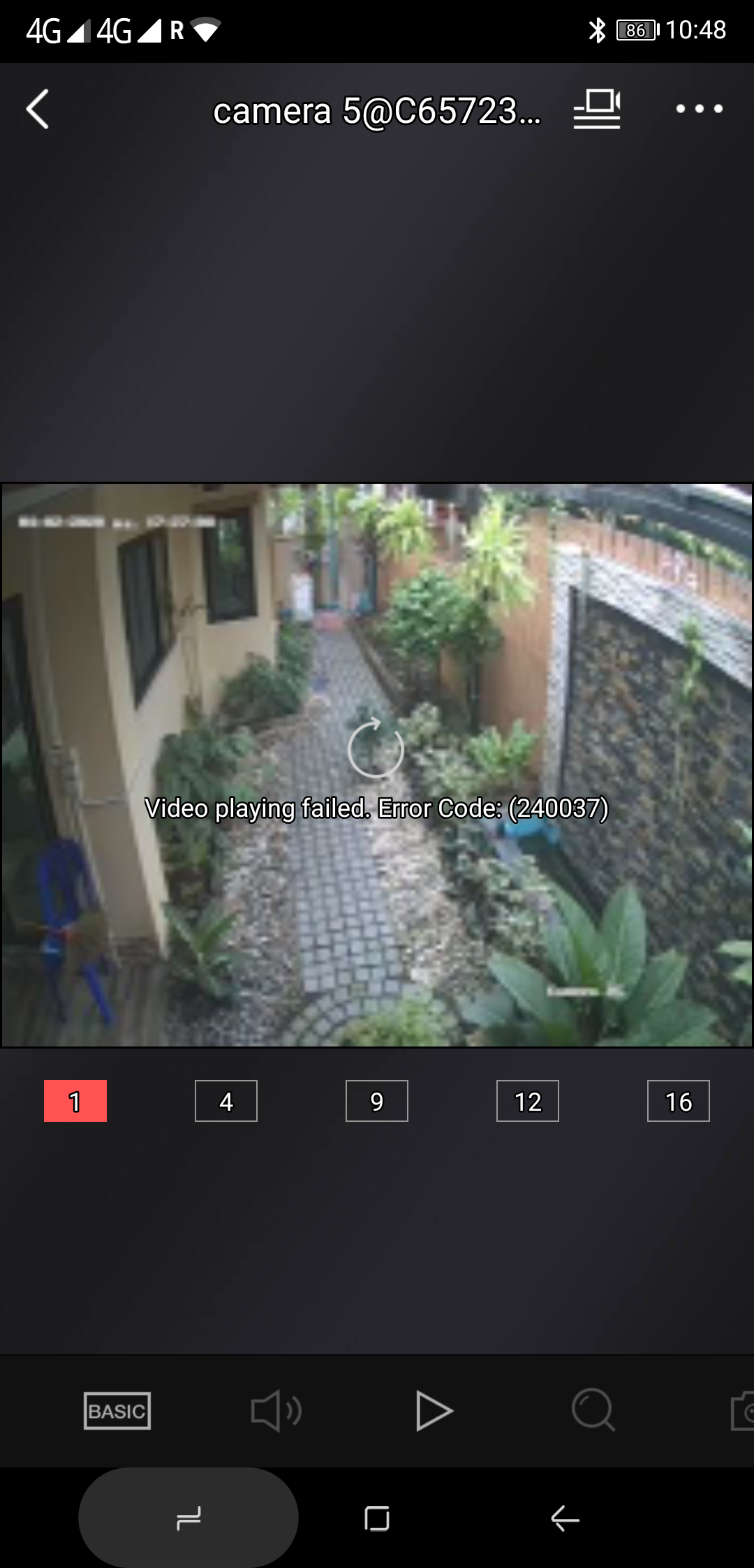

Phil Administrator Staff member Messages 5,134 Points 113 Jan 3, 2020 #2 Only one previous mention of that error code: Hik-Connect Listing an EXTRA camera as Multi-window@DS-7608N-K2-8P The code number doesn't return any explanation in my error code check tool
M mnloco New Member Messages 1 Points 3 Mar 25, 2020 #3 I had the same error code. Needed to port forward the RTSP port in the router to allow for live view
M Mo3taz New Member Messages 1 Points 1 May 19, 2020 #4 mnloco said: I had the same error code. Needed to port forward the RTSP port in the router to allow for live view Click to expand... Can you explain please
K KamirZG Gives a lot of help Trusted Member Messages 255 Points 28 May 21, 2020 #5 This is stream error ( every error after 20000+ is stream error). Try lovering your bitrate.
