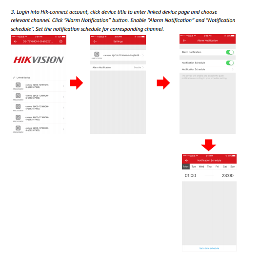

Hi Jason, Hik Tech Support just made a suggestion that I had not thought of, have you checked the Notification schedule within your App?
Are the settings OK / as you'd expect?
If you are happy to share your login credentials with us, we/they can login and take a look to see if we can spot any problems.
